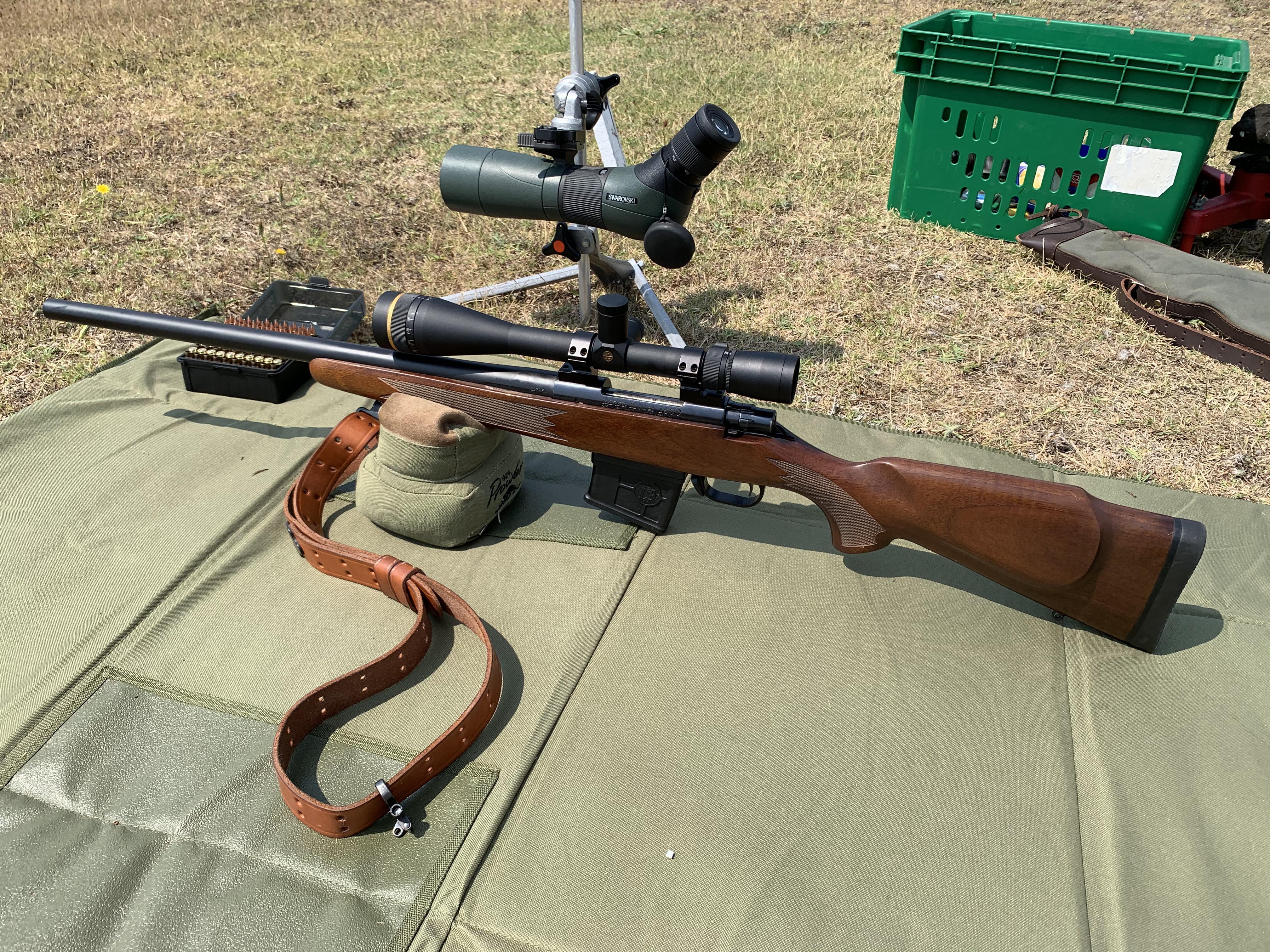

l painted a brand new SS barrel with pot belly black to stop it from being so out of place in the field
this paint is pretty rugged, it does not scratch easily

marksman wrote:l painted a brand new SS barrel with pot belly black to stop it from being so out of place in the field
https://www.bunnings.com.au/white-knigh ... t_p1563023
That looks good. Did u need under coat?
Good job. Was it as simple as just spraying it on? What sort of prep was needed?
Shootermick
Posts: 841
Re: Spray can finish
Post by marksman » 30 May 2020, 2:39 pm
its actual pot belly black stove paint, its an undercoat and paint all in one, so l just gave the barrel a wipe with turps, taped it up and painted 2 coats
the barrel was even taken off by the gunsmith and had the chamber details put on it in a cnc machine without marking the paint
it worked for me :thumbsup:

Post by in2anity » 01 Jun 2020, 11:55 am
what contour is that marksman? i bet it keeps putting them in there.
Post by marksman » 01 Jun 2020, 2:54 pm
its a #7 shilen standard varmint and yes it does keep putting them in there
for a hunting rifle l would not go any heavier
