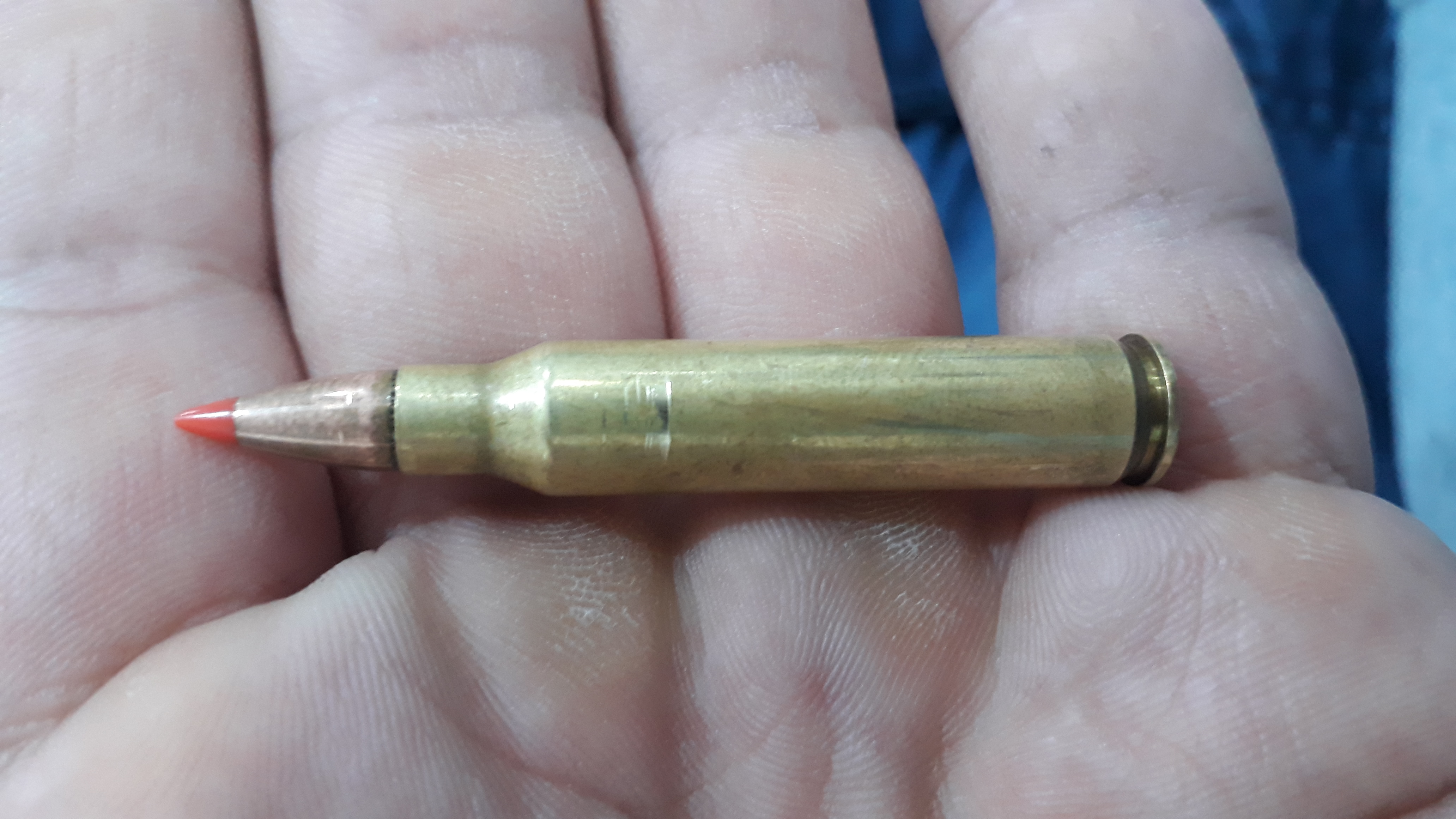

Just wondering if anyone else has had/is having feeding issues with their Sauer 100XT. Mine is in .223.
The bolt cycles fine when the magazine's not loaded , but when it's in loaded, it dosnt cycle smoothly when it's pushing the round in, it's giving me resistance, enough to be uncomfortable.

Iv been cycling it for 15 minutes to see what I can see, I was cycling the same round over and over. I started to notice a scrape Mark on the brass.

I think this is where it's coming from

its definitely dragging on something, if its under warranty send it back for a look
it could be a number of things from the mag feed lips not the right angle, or maybe hitting the feed ramp or the edge of the chamber, any of these things are usually related to the mag feed lips, being push feed the round may not be popping up early enough

if it were my rifle , i would deburr that edge with a dremel . very,very slightly . if that's not a option return it to the place of purchase for a fix :thumbsup:

IMHO if it is hitting the feed ramp it has something to do with the magazine not presenting the round at the right angle, what SS said
it is push feed so it is possibly not popping the round up early enough, thats a mag problem and so is not presenting the round at the right angle,
watch the round feed from the mag
dont get the 8" grinder out to quick :thumbsup:
your cycled round looks standard OAL, if you were using vld bullets because of the longer OAL l may agree with attacking the feed ramp with the 8" grinder

so where is the burr :unknown:
you will be able to check for a burr easily with a cotton bud
l've seen scrapes like those on your cases from the case dragging back against the side of the action when being extracted
not that has nothing to do with feeding :unknown:
