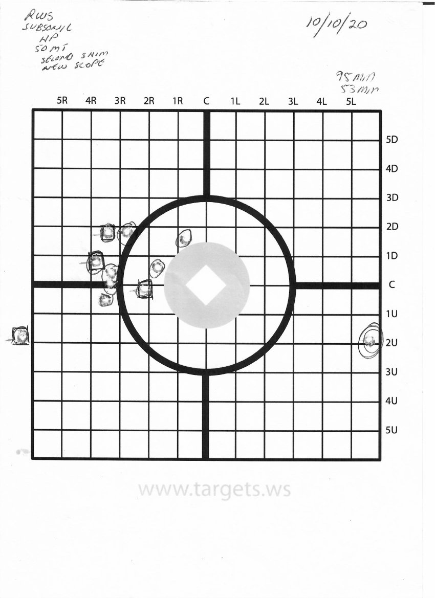

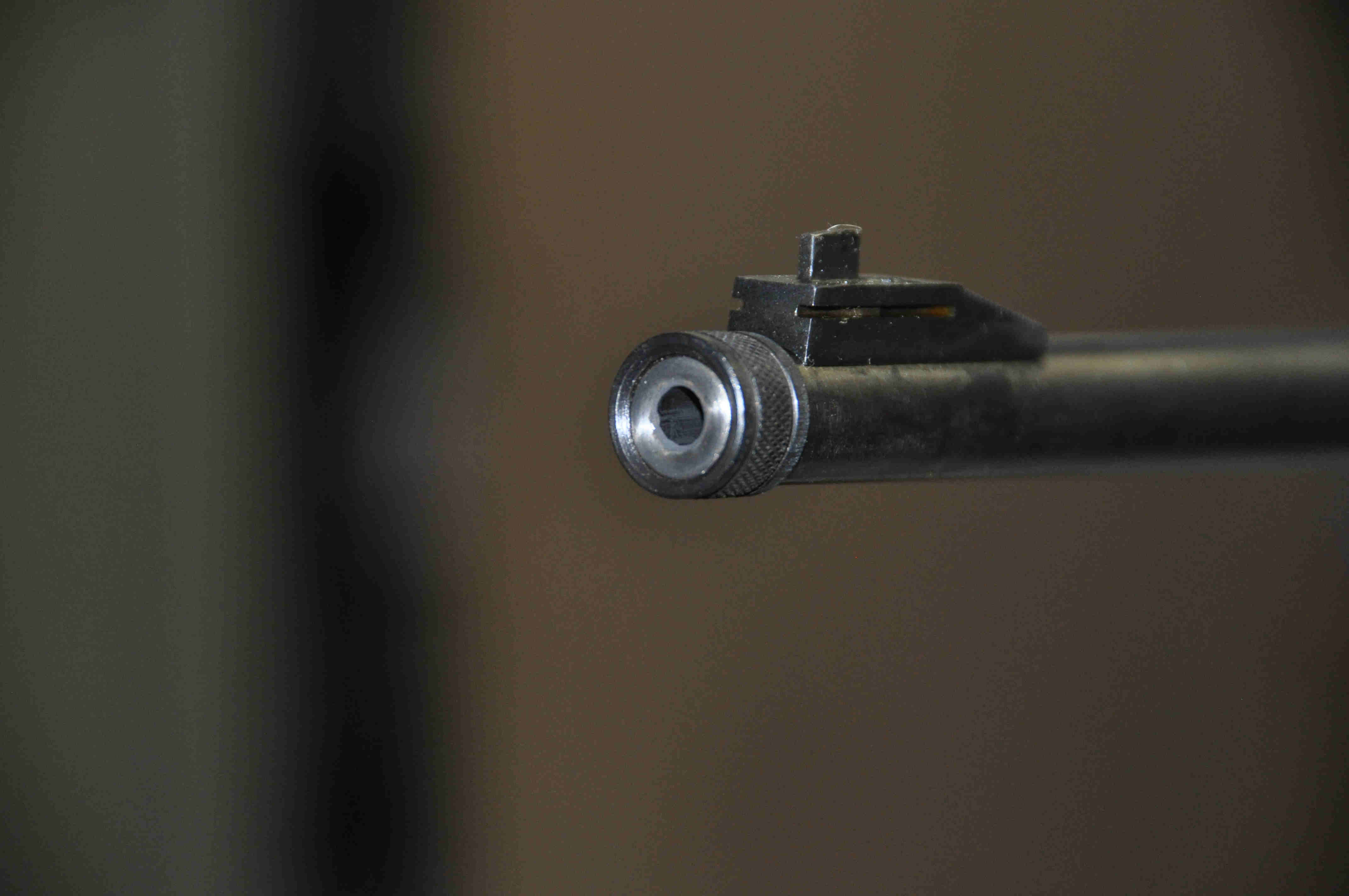

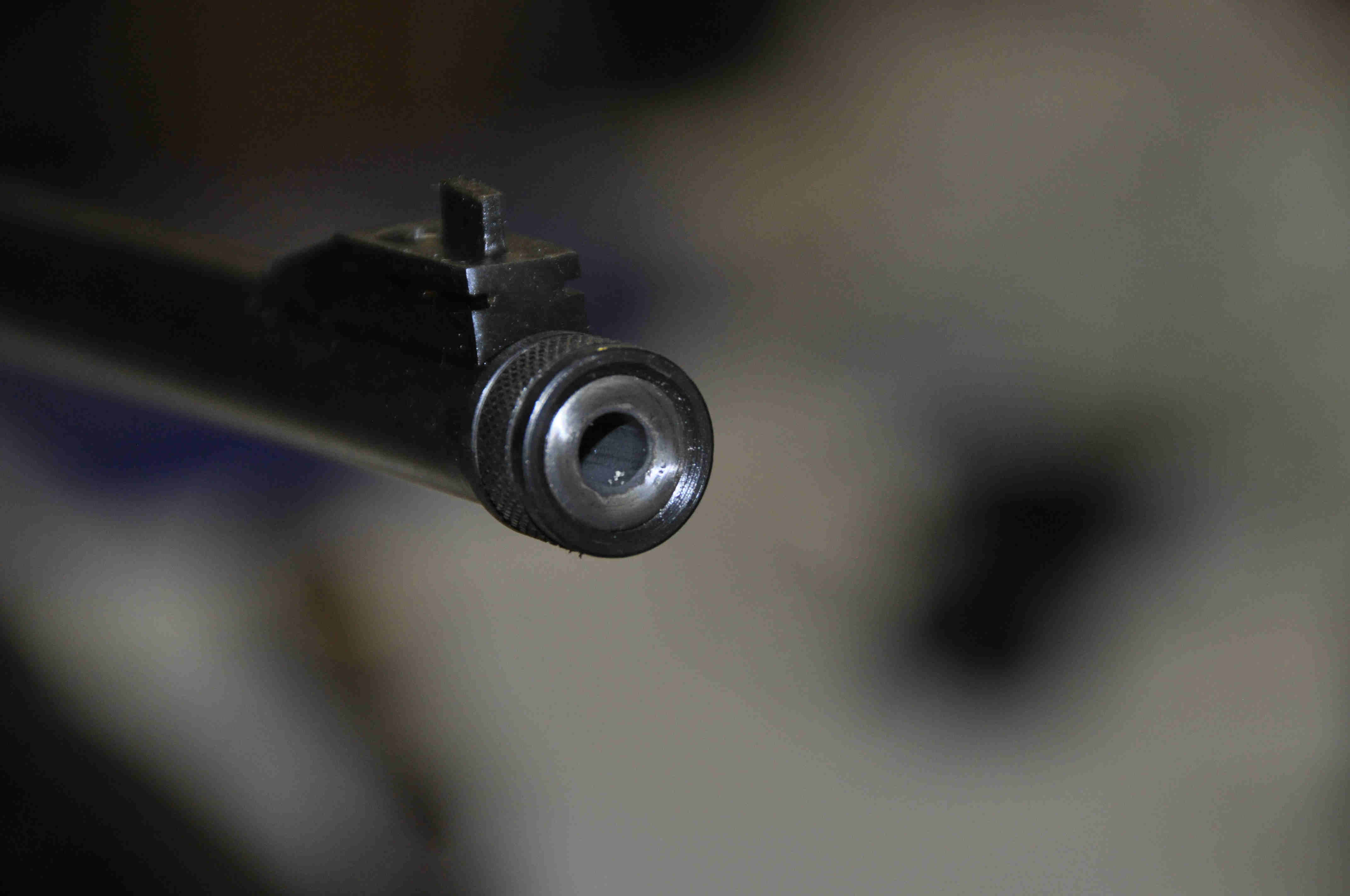

Post by Rasmus7 » 10 Oct 2020, 9:14 pm
]Hi, I'm new to the forum and this is my first post. Sorry if it is a little long. I bought a new Norinco JW-15 (Synthetic stock) a week ago after they were recommended as a good accurate bunny gun. I've put about 200 rounds of various ammunition through it but the best 5 shot group I have come up with is 35mm. Before I shot it I gave it a thorough clean and removed all the grease from the barrel. I then went out and shot it and after 60 odd rounds the best 5 shot group I had was 118mm. The worst was 193mm. Today I changed the scope over from my HMR and shimmed up the action to temporarily float the barrel to see if that made an improvement. That's when I shot the 5 shot 35mm group. That was followed up by a 40mm, 73mm, 95mm and then a 53mm group. After shooting my HMR which generally shoots where I point it this has got worried that I've bought a dud. It was windy today with about 10+ knots cross wind but I would have expected better results. I 've looked at the crown and from my very limited experience it looks a little dodgy. It doesn't look to have an even bevel all round the opening. I've attached photo's for your opinion. I also backed off the tension on the action screws a bit before the 35mm group. Am I expecting too much too early, should I properly float the barrel or just keep shooting it to see if it comes good with use? Any help would be appreciated. Thanks.

Post by Wm.Traynor » 11 Oct 2020, 7:37 pm
Tell us about the shape of your 35 and 40mm groups Rasmus. i.e. more vertical dispersion than horizontal, or vice versa? Or are they round?
The bore appears to have some white stuff in it from the pics. Is that white flannel from cleaning patches? Otherwise it might be pits in the bore.
What was the range?
That was one helluva dramatic improvement from floating the barrel but if poor bedding is the problem, then it is possible that the action bedding might be crook too.
What did you use to shim the action?

Post by Rasmus7 » 11 Oct 2020, 9:13 pm
Hi W.M Traynor, thanks for your reply. Rather than try to explain I've included my last two target sheets. On re measuring my groups my numbers may have been wrong and it may have been worse than I thought. That is some sort of foreign body in the barrel but it is gone now. Yes it is a great improvement with the float but on this gun the second action screw does not bed down tight with the stock so there is a gap under the second action screw so I was concerned that I was putting it under tension and maybe creating another problem. I used two washers under the first bedding screw into the post and peelable aluminum shims under the tang at the rear.

Post by rc42 » 12 Oct 2020, 9:10 am
The RWS sub-sonic is a reasonable round but they are far from match grade, it could be that your rifle doesn't doesn't work well with them, some 22LR rifles just can't group with some brands of ammo and that can even change between batches of the same type.
I would suggest getting a selection of different ammo types and see how much variation you are getting, if none of them group well then move on the rifle issues but the bedding and free floating the barrel will probably already have made it as good as it can be, the JW-15 is never going to be a competitive bench rest rifle.
Have a look at some of the accuracy reviews online and see what results others are getting, below is a youtube link for a similar rifle with different ammo types.

Post by Wm.Traynor » 12 Oct 2020, 9:12 am
Rasmus,
Because those washers and shims are loose, the action will bounce imperceptibly, resulting in different vibrations from one shot to another. This is not good for accuracy. Nice try though mate :)
You need to have your rifle bedded in epoxy (for instance), which adheres to the stock permanently. Until you do that, I would modify the tang shims, by cutting them in half, at right angles to the longitudinal axis of the rifle. That is, the cut should be made through the centre of the bolt hole. Discard the rearmost half and reposition the remainder where it was, on the muzzle side of the hole. It might be a temporary improvement but like I said, nice try :thumbsup: :) and good luck.

Just to add with regard to re-crowning the muzzle...
Budget rifles don't get much finishing so the crown may well be affecting accuracy, but the cost of a gunsmith just isn't justified for such a budget rifle and there's no guarantee it would even help.
You can try changing it yourself with a cordless drill, brass screw and some valve grinding paste, there are youtube videos on that too,
I used that method on my Ruger M77/357 but that had a clear manufacturing defect on the muzzle when I got it but it took 6 months to arrive from the USA so I wasn't sending it back. It also had a stainless barrel so was easy to change without leaving marks, on a blued barrel you would expose the bright steel so it would look damaged and be prone to rusting if you don't re-blue it.
Edit - good tips from Wim, have a look for videos about glass/epoxy bedding and barrel floating too, it's a fairly easy DIY job and that did make a difference on my Ruger

Post by marksman » 12 Oct 2020, 4:58 pm
the crown doesn't look very flash, it might be my eyes but it looks like there are chips of metal taken away :unknown:
if it is a crown job is needed, you can get a professional crown job from a smith or if your handy with tools this is a method l have used with success

Those groups are pretty bad - I doubt there is any accuracy guarantees on such a budget rifle...but I wonder what the shops take on it might be ? There is something / s - wrong.

Post by straightshooter » 13 Oct 2020, 9:17 am
Rasmus7
Forget most of the so called advice one may see in this type of thread. It is the Dunning Kruger syndrome in operation.
Go to the basics.
Firstly the few JW15 barrels I have examined have been pretty rough although some shot quite well.
Try this.
Push a dry firmly fitting patch through the bore. If you feel tight and loose spots then that is an indication of a poor barrel or bad leading.
There is only one real cure for a bad barrel.
As for leading take the rifle out in the midday sun and position it so the muzzle end is brightly illuminated and you can view the bore preferably with magnification. If you can see any leading then that is part of your problem.
You might be able to fix the problem by cleaning the bore with JB paste which might also negate some of the roughness. One thing to be careful of is to have a physical barrier preventing the the jag passing out of the muzzle while making quite a few backward and forward strokes.
Generally perfection in the crown is of far less importance than gunsmiths claim. What is important is the quality of the rifling close to the crown.
Beyond that there there an array of issues that can affect rimfire accuracy, as distinct from centerfire accuracy, none of which respond to tinkering with bedding.

Post by Larry » 13 Oct 2020, 12:10 pm
Just addressing your crown issue only and I think there is a lot more going on than just a bad crown.
Ideally the crown would have nearly razor sharp endges with the inside of the bore. The shape of the crown can have a significant impact on the accuracy or grouping of a rifle. On the other hand there are many different styles and shapes that have been or are used when it comes to the actual shape from rounded to stepped and single angle designs. The most important thing is that it is consistent for the full 360 degrees with no lopsidedness to it.
I would firstly pursue the returning of the gun and replacement rather than repair. That can be a dog chasing its tail type of exercise and get expensive very quickly.

Re: Opinion on 22lr Crown
Post by SCJ429 » 20 Oct 2020, 9:49 am
I am not sure why you are surprised by SS,s response Tassie. He always jumps into a thread telling the OP that all other posters have no idea and that his advice is the only thing that matters. Perhaps he is actually Dan Lilja but I am guessing not.
By the look of that crown, it won't be doing you any favours. The barrel may also be poor quality and this is as good as it will ever shoot. I had a cheap 22lr and I cut the barrel down with a cut off wheel. I polished the new crown with some valve grinding paste and it then shot under an inch at 50 metres. Not great but way better that the previous damaged crown.

Post by Ziege » 24 Oct 2020, 9:57 pm
ive seen 22's where the old fart owner has hacked off the front sight/ first 1" of barrel and they were still accurate so yeah dunnos
