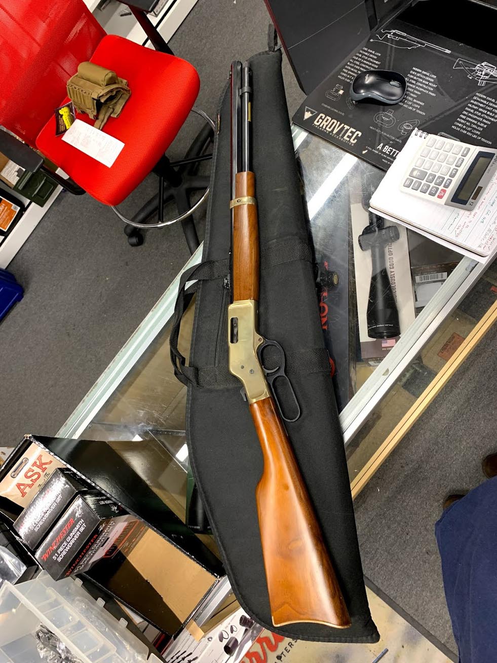

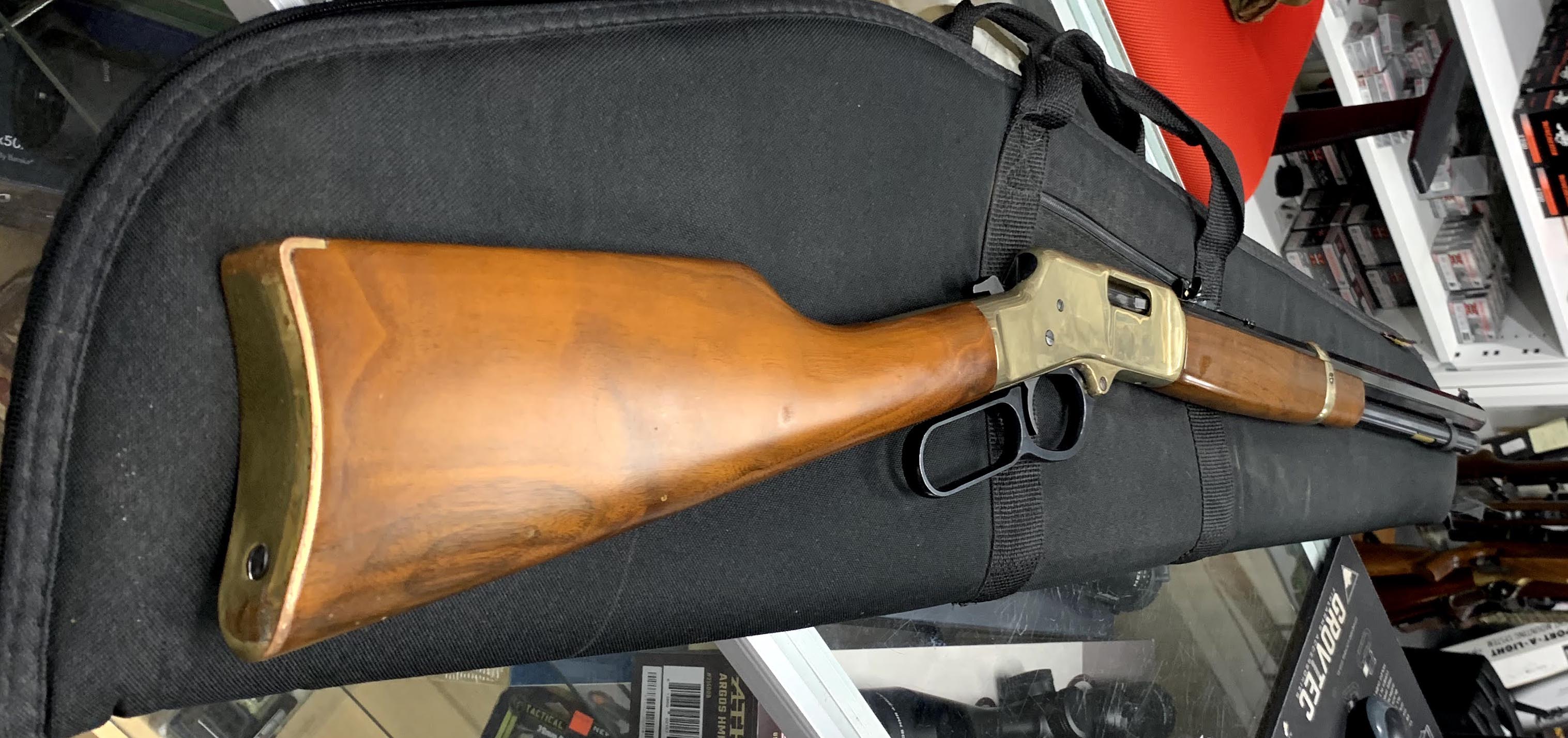

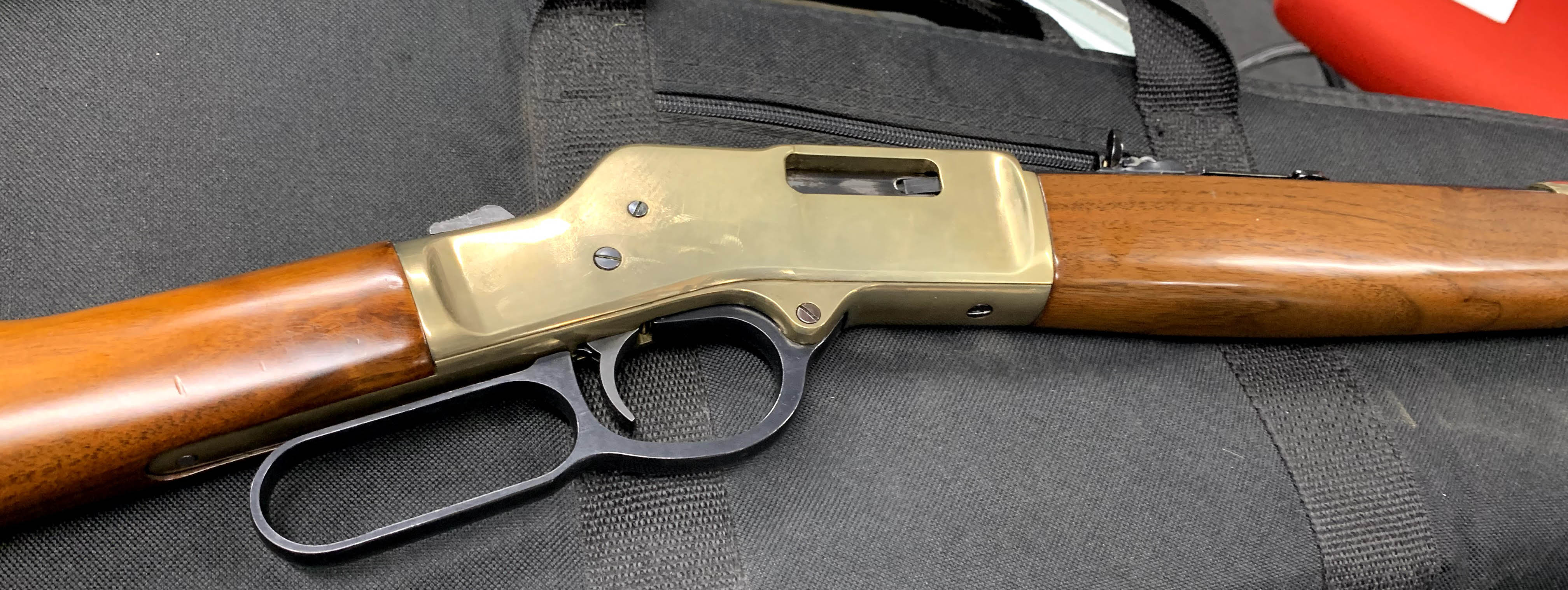

I am in the middle of purchasing a 44mag Henry big boy second hand from the local gunshop. Pictures are attached. I am a little worried about its condition and it looks like it has ben used a lot. I dont know if the shop checks them out or anything.
Anyway I will pull it apart and give it a good clean before I use it.
There are some cosmetic issues I can see that I want to address on the gun
* the butt plate is heavily scratched but I should be able to sand and polish brass OK
* The Bolt (pictured) has all the black scratched off of it - Any way to fix this?
* The end of the barrel looks like someone has been using it to lean on some bricks (no picture). It is scratched and rust has started. I could sand this but is there an easy way to re blue that part?
* Id rather the wood be a nice, red color. Anyway to make that happen?
Thank you

Sometimes attempts at restoration look worse than simple evidence of usage and wear.
By all means give it a good clean.
Also it's not a good idea to keep it cocked all the time when it is so easy to decock without the impact or noise of dry firing.
If you feel confident you can do it and you have access to appropriate tools then this is what I suggest.
Use a scraper (not a file) to remove ridges until butt plate is level and then buff. Trying to fix any grooves will take a lot of effort and likely produce a poor result.
Yes reblue the bolt and never operate the action again. This is a normal consequence of usage.
Yes, touch up with some cold blue. It has rusted due to negligence in wiping down blued parts with a slightly oiled rag.
Yes, scrape off the existing finish and sand. Apply the red stain you desire and then refinish.
Posts: 1457
Re: Restoring a modern Henry big boy 44mag
Post by Gamerancher » 10 May 2021, 9:00 am
If you plan on using it I wouldn't bother re-blueing the bolt or lever.
The rash on the butt-plate can be easily remedied if you wanted to do that.
Clean up the end of the barrel with some steel wool and touch up with some cold blue as has been suggested.
A wipe down with an oil impregnated rag after use should be enough to maintain the exterior blued metal of the rifle.
Be careful trying to stain the wood work, it may not come out the colour you want, do a "test" on the timber under the butt plate.
Red stains tend to come out on the pink side.
A bit of honest "wear and tear" on a second hand rifle is to be expected and should not have any affect on the functionality of the rifle. :thumbsup:
Abuse on the other hand..... :unknown:

Got my gun finally and it’s generally not as bad as I thought. However the butt plate looks to me like it’s copper underneath. I can see the colour copper and a little green where it’s tarnished. I didn’t see this coming. Is that normal/expected? Would I need the whole piece replated or something?
Troyus
Posts: 22
Post by Fionn » 09 Jul 2021, 11:59 pm
Troyus wrote:However the butt plate looks to me like it’s copper underneath. I can see the colour copper and a little green where it’s tarnished.
Big boy buttplates are solid brass
It's most likely just been badly cleaned with an acid based cleaner which leaches the zinc out of the brass leaving copper which can turn pink. Both brass and copper turn green with tarnish.
Should come off with a good polish with brasso.
