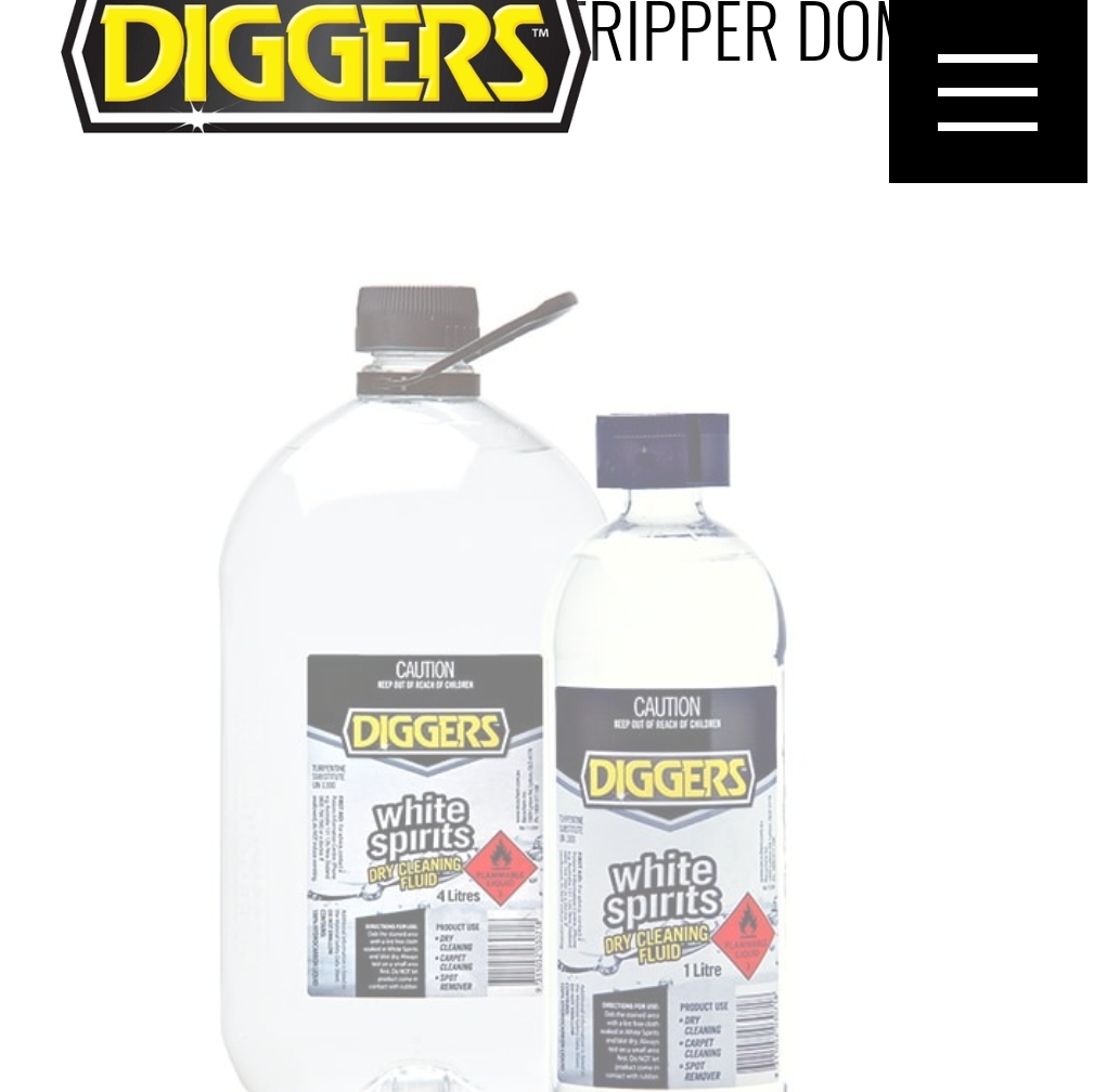

Post by Oldbloke » 06 Dec 2021, 11:01 am
Hi mate,
Have you tried white spirits? A bit stronger than turps. If that doesn't work perhaps metho or paint stripper.

Post by No1_49er » 06 Jan 2022, 9:05 am
Sheesh. What a mission that was.
Tried almost everything. Some industrial solvents are no longer accessible to me, more's the pity.
Even remembered that an over-spray from AeroGuard pretty much destroyed the plastic case of a fairly expensive / elaborate piece of electronic test equipment I have, so tried that too. Not a hope.
Bushman; nope.
White Spirit; nope.
Paint stripper of any kind; nope.
Abrasive 0000; nope.
Even tried scratching the surface with abrasive to allow a better key for the solvent/s, to no avail.
Only thing that got "close" was Citri-Strip. A type of gel that eventually got the coating soft enough to be able to scrape it off. But not easily. In fact, required several re-applications. It certainly didn't bubble and blister as one might expect from a paint stripper.
Whatever it was that Winchester used was never meant to come off, but god help anybody who wants to fix a tired stock :(
