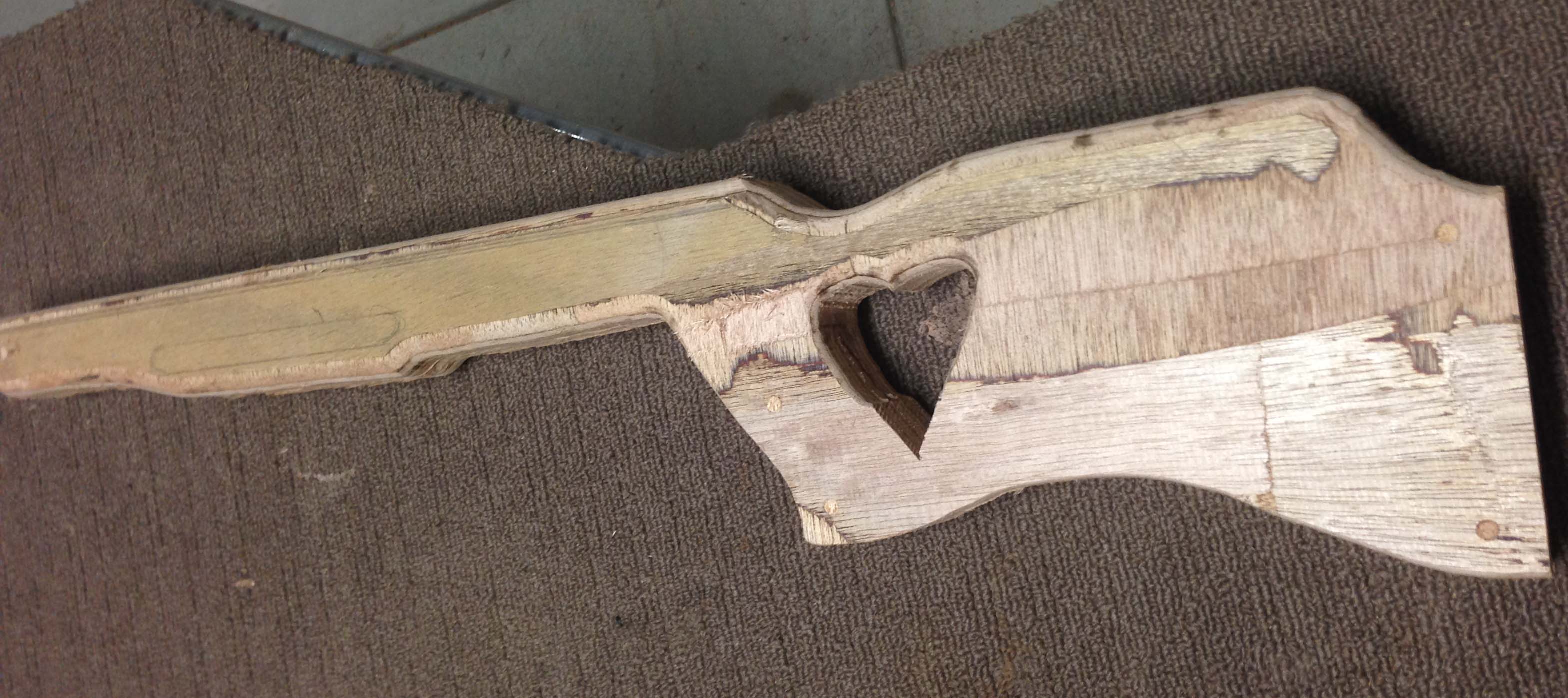

Post by DaleH » 09 Jun 2014, 10:37 am
Progress slowly being made.
Laminated three lots of ply together to get the required thickness and did a little more shaping. I will get the sanding disk on the angle grinder once I have inlet the stock and really take to it to get the shaper right.
As I am planning to shape away a large portion of the but area of the stock, I glued in some aluminium flat bar in a cut out in the centre section of ply. Unfortunately in my enthusiasm I didn't take any photos...
Once the shape is finished and since the stock will be painted (in the daughters favorite shade of pink) I will go over the timber with a body filler and sand it back to a finish suitable for painting.

Post by MeccaOz » 09 Jun 2014, 12:41 pm
It's great to see the stages in this project. Was the love heart yours or your daughters design ? :D
MeccaOz
Posts: 1006
Re: Homemade ply wood stock
Post by DaleH » 09 Jun 2014, 2:38 pm
I suggested it and she thought it was a great idea.
She also wants me to develop a range of ammo that "shoots sparkles" out of the barrel - the love heart will do for now I think.
