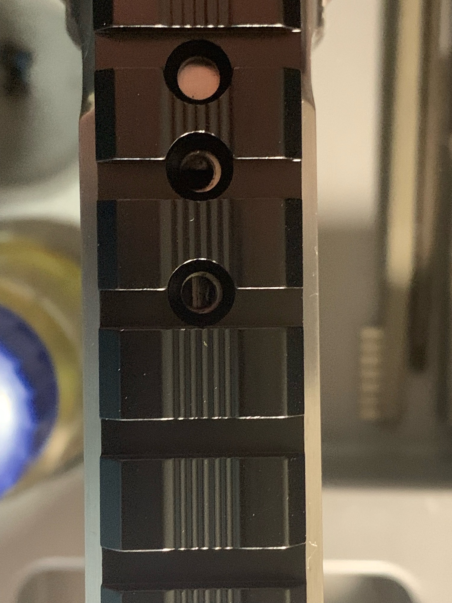

Post by JimTom » 23 Feb 2022, 3:21 pm
I tried to put a Pic rail on my Marlin 1894 (Remington) so as to mount a scope for some upcoming load development, only to discover that the front two holes are not drilled in the correct place. I was unable to even attempt to screw the front two screws in it was that far out. Anyone else experienced this with their Remlin.

Post by JimTom » 23 Feb 2022, 3:25 pm
Not the best picture, however this is the view looking down through the rail. The rear two screw have been lightly torqued, which makes the rail straight however the front two screws cannot be used due to the slack craftsmanship (I use that term very lightly).

Post by JimTom » 23 Feb 2022, 3:28 pm
Oldbloke wrote:Wow, that's the pits. Good gun Smith can fix. But will cost.
Umm, can you mount a peep sight?
My thoughts exactly mate. Rear mounting holes are good, only the front ones dodgey which of course precludes the use of a scope. Was only going to use the scope for load development anyhow. Red dot would work, however I am inclined to either use the standard iron sights as it was intended or a skinner peep sight perhaps.

Post by Blr243 » 23 Feb 2022, 3:37 pm
Can u modify th pic rail holes with a small metalworking reammer in a drilll ? I would not try to repair the tapped holes In The receiver

Post by Larry » 23 Feb 2022, 3:42 pm
I found something similar on my Rem 700 in that case it was not just the holes but the top of the action was not symmetrical.

Post by JimTom » 23 Feb 2022, 3:43 pm
Blr243 wrote:Can u modify th pic rail holes with a small metalworking reammer in a drilll ? I would not try to repair the tapped holes In The receiver
Definitely a better option than piss farting about with the rifle I’d reckon mate. I shall give it some thought.

Post by Oldbloke » 23 Feb 2022, 4:46 pm
Top idea . Needle file should do it.

Post by bladeracer » 23 Feb 2022, 5:13 pm
My thoughts exactly mate. Rear mounting holes are good, only the front ones dodgy which of course precludes the use of a scope. Was only going to use the scope for load development anyhow. Red dot would work, however I am inclined to either use the standard iron sights as it was intended or a skinner peep sight perhaps.
You could get a $10 rail off Ebay and drill your own holes to suit. You'll need extra screws that you can put a point on, put them in just proud of the surface and use those to transfer the holes onto a new rail. If any holes are blind make sure threads are clean or you'll struggle to get the pointed screws back out.

Post by JimTom » 23 Feb 2022, 8:20 pm
Larry wrote:I found something similar on my Rem 700 in that case it was not just the holes but the top of the action was not symmetrical.
Characteristic of Remington production at the time perhaps mate?

Post by straightshooter » 24 Feb 2022, 6:50 am
JimTom wrote:I tried to put a Pic rail on my Marlin 1894 (Remington) so as to mount a scope for some upcoming load development, only to discover that the front two holes are not drilled in the correct place. I was unable to even attempt to screw the front two screws in it was that far out. Anyone else experienced this with their Remlin.
You are assuming the rail is correctly drilled and there is something wrong with the Marlin.
Have you considered the opposing alternative possibility?
Posts: 1471
Re: Remlin has been drilled and tapped crooked
Post by JimTom » 24 Feb 2022, 8:03 am
straightshooter wrote:You are assuming the rail is correctly drilled and there is something wrong with the Marlin.
Yes mate, definitely considered it. Believe me I tried to make the bases and rails etc the problem, not the rifle, however there is no denying it’s definitely the rifle.
With the rail only secured by rear screws, it is straight and scope sits dead centre of the barrel. When I tried two piece bases scope won’t sit flush in the front scope mount as front base is crooked. Scope is crooked on rifle also.
I have also measured it 1000 times and front holes definitely drilled incorrectly.
It’s a pity as it shoots, loads, feeds, cycles beautifully, and looks an absolute treat.
I will just use it with open / peep sights as it’s intended I think.
