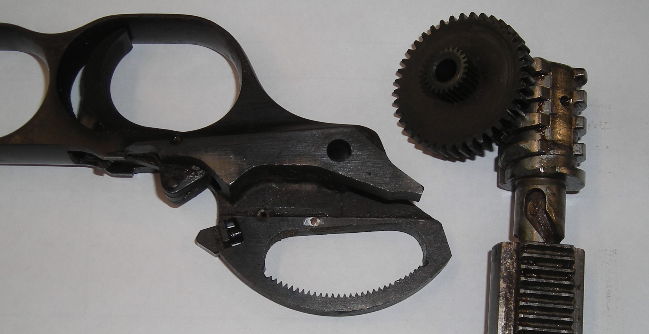

Here are the basic components. You can see the lever gear only has teeth on the bottom, and the cocking gear has a large gear and a small gear. The large one has an even amount of teeth and the small one has an uneven amount I believe.
DSCN1383 (2).JPG (358.73 KiB) Viewed 32981 times
In this pic you can see the approx position of the gear in the lever when the lever is closed.
This is how you move the cocking gear to a different position in the lever. The manual mentions using a size smaller punch, but I found a small jewellers screwdriver was easier. With the elver closed, using this technique, you can get a few different positions and tolerances. Trying to put the bolt or lever in a different position has no effect, you need to leave the action closed, and move this gear in the lever.

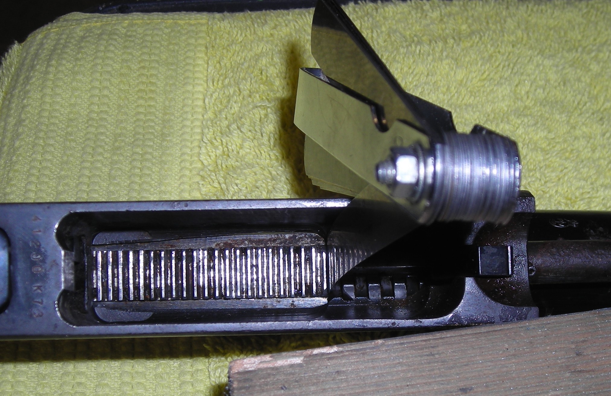

This is where you check the tolerance after each adjustment. Take the hammer pressure off the bolt and see what you have.

I have reviewed this, and given it further thought. As far as I am concerned, setting the tolerance with a feeler gauge, as the manual instructs you to do, is necessary.
With the lever fully closed, and the bolt fully locked into the lugs in the receiver, there is a tolerance that Browning stipulate must be in the rack and pinion gears, measured at the breech bolt slide. With the lever locked, and the bolt locked, you can vary this tolerance by altering the cocking gear position, as instructed in the manual. With a sized case in the chamber, this tolerance is the same as without a case in the chamber, as measured in my rifle.
Browning instruct that the clearance must be between a minimum and maximum - 0.01" to .015". They state the following "If no clearance exists, the gearing of the action may be damaged upon firing. If clearance is too great the bolt will not be properly locked" I have checked three rifles now, two of them had the minimum clearance that Browning state is needed, and one of them did not. Two of them were in good order, and the one with no clearance had damage to the action, just as Browning warn can happen.
I have followed the instructions that Browning provide. The only difference is that I have tried to explain it a bit better, and add a bit of info on how to adjust the cocking gear position. If you do not check it, it can easily be too much or not enough. All three rifles I have done took multiple adjustments in order to get the Browning specification correct. The rifle with no clearance has had the damaged gear replaced.
I would not advise anyone to ignore the factory instructions.

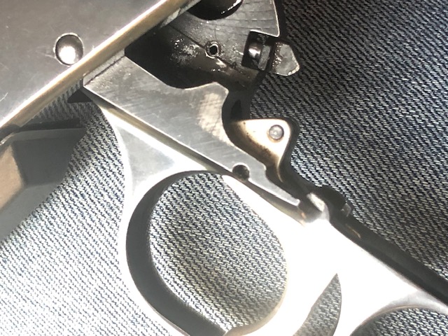

I thought I'd replied to dean in the message section but somehow it seems my message didn't make it. Many thanks Dean,the images clarified the situation for me and I managed to sort my issues out. The confidence that those pics gave me help me to isolate what my problem is/was.
Shayne about 0.002" is the clearance. The serial number says the gun was shipped in 1982 but it has the multi locking lug bolt that is incompatible with some of the mega magazines you can allegedly buy for it nowadays.
My problem is/was the bolt needs a good wack on the lever to get it closed tight, I'm aware the gun has been stripped down by a previous owner and I'm not sure if the latching lug has been incorrectly re-assembled or had the spring doctored in some way as it's all too easy for the gun to slip out of battery.
The pic shows the latch as it is on my rifle.
The fault I think I discovered was twofold, the gun wouldn't fire and the cartridges would stick in the chamber.
The first problem was sorted with brake cleaner, compressed air and silicon oil as the firing pin was crudded up. The second problem was of my own making, my previous deer rifle that I sold last year was a ruger #1 in 308, as such it didn't need full length resizing. I had resized the cases BUT they sprang back and caused the second issue, 5 minutes with a mike told me the story it took 3 or 4 resizings to get the diameter of the base of the case within 0.001" of the diameter of some factory fresh match ammo.
Just back from the range where I was extremely pleasantly surprised when short range groups of ragged hole size were the norm.
The gun has had very little use in terms of ammo fired but lead quite a difficult life probably down to being owned by a Mr Nosey.
I know the clearance is a little on the tight side but I'm happy to live with that.
Once again thanks to Dean and your good self I really appreciate the help I've gotten from the pair of you and I hope you don't regard me as another ignorant Pom as my previous message didn't seem to make it.

Post by drone » 21 Jan 2024, 1:03 am
Just checked back through Shayne's images and it seems my latching lug is assembled correctly it's just that I can easily depress it with finger pressure whereas the latch on my win mod 94 30/30 from 1958 is nearly impossible to depress by finger pressure, probably just me.
