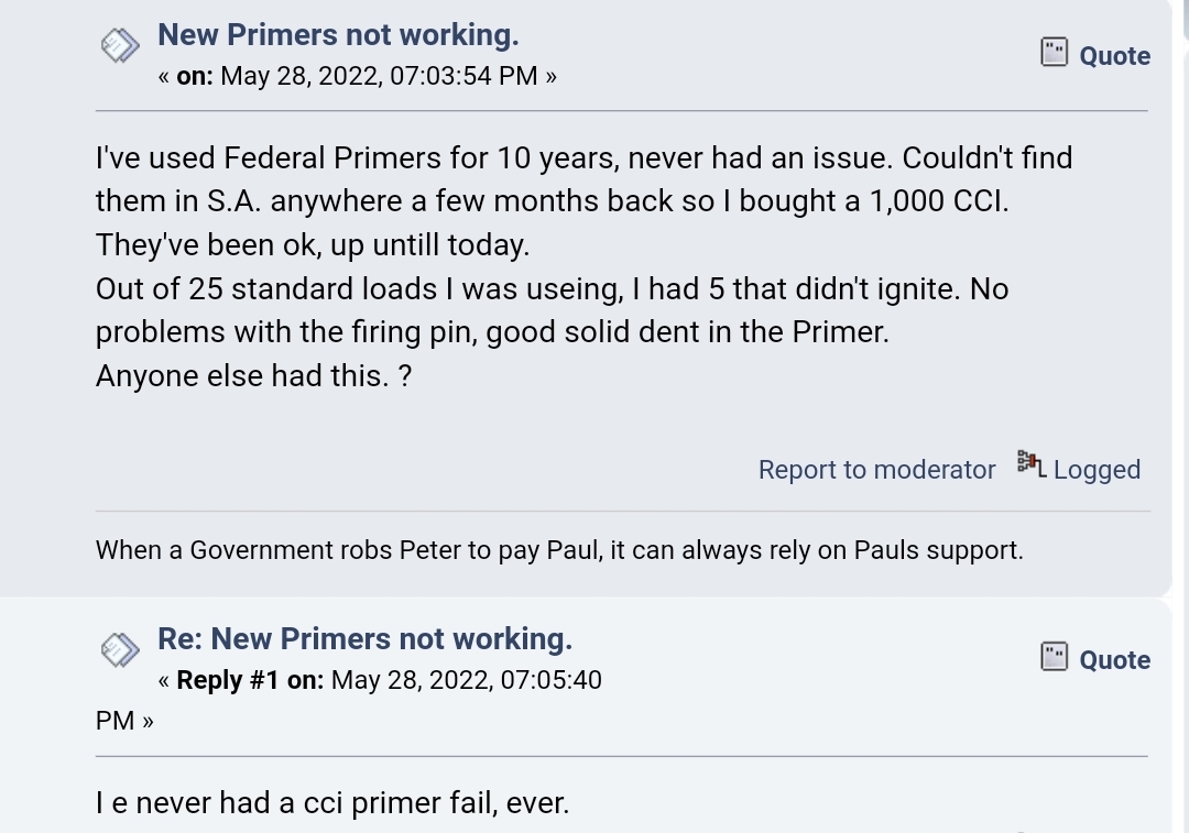

https://www.australianhunting.net/index ... c=271519.0
That link won't work unless you're a member.

OK. The thread was about a bloke had same issue with CCI primers. But no definitive cause found,
If they have been OK with other ammo then must be the rifle/pin of related to seating of primers I guess. Head space perhaps?

Oldbloke wrote:OK. The thread was about a bloke had same issue with CCI primers. But no definitive cause found,
