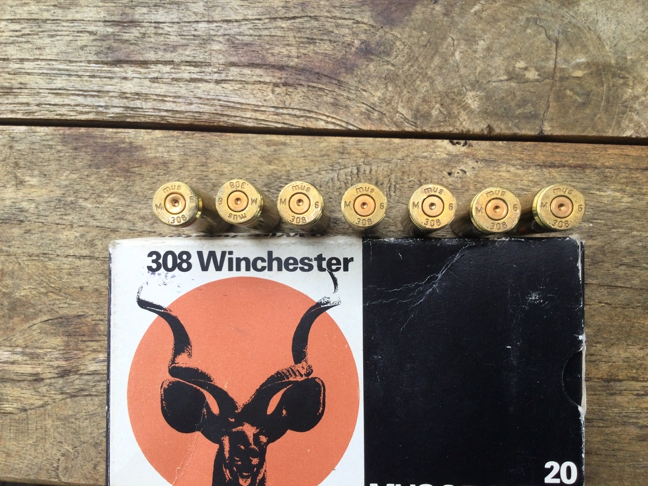

I have hopefully attached a photo of the cases

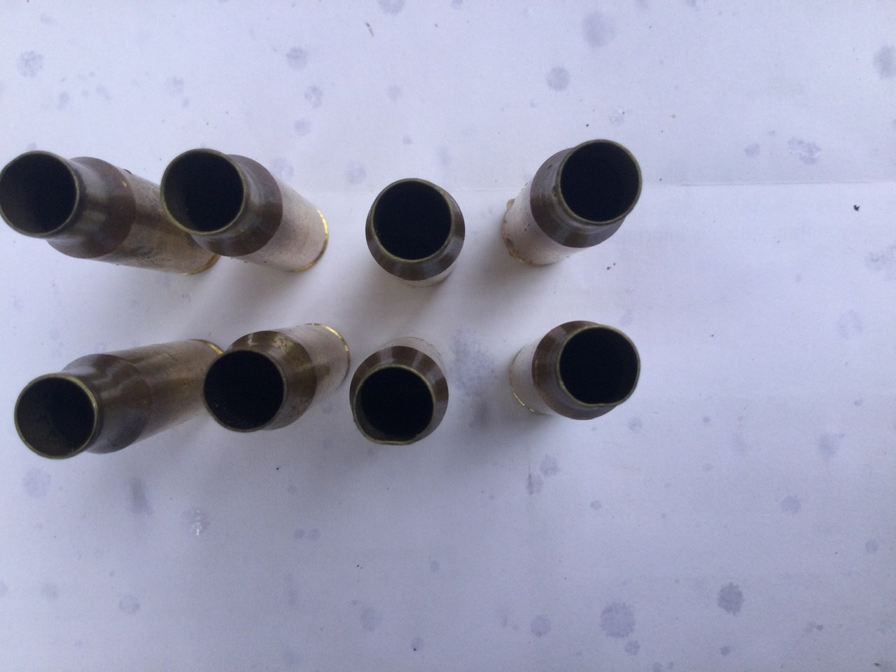

Cases in same order as per previous post.
The case on the left has a significantly larger firing pin mark
I was not smart enough to keep the two cases that jammed the bolt separate. My first post was not as clear as it could in that I has no issue in raising the bolt handle either time. It just couldn’t be pulled back without timber and mallet persuasion.

It looks like the neck of the cartridge is engaging the lands. Can you see rifling marks on the neck.

Post by Oldbloke » 20 Oct 2022, 4:46 pm
Larry wrote:It looks like the neck of the cartridge is engaging the lands. Can you see rifling marks on the neck.
Could be. Pics not quite up to the task
Or jamming up against the end of the chamber. There is no way a case can engage the lands.

Judging by the scuff marks on the case heads in the photo, then pressures are sufficiently hot for the case to fully expand longitudinally in the chamber, press firmly against the boltface and become tight to extract.
The cases are then difficult to extract because at that point the bolt has rotated past the primary part of the extraction cam which has the most extraction leverage.
With this type of action the problem is likely to lie in the relationship of the extractor claw to the boltface. If the claw is too far from the boltface the primary extraction is wasted in taking up the slack without dislodging the case.

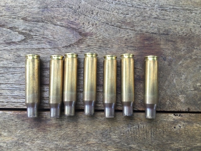

Thanks for the replies so far. No reloading done by me. Learning curves for rifles is steep enough. Some more pictures. The cases have a variety of marks, but interesting to note the 2 bottom right don’t have rounded necks anymore.

Post by in2anity » 31 Oct 2022, 11:02 am
Peterwho wrote:but interesting to note the 2 bottom right don’t have rounded necks anymore.
That's just a dent from ejection - wouldn't pay much attention to it.

Post by Peterwho » 01 Nov 2022, 3:55 pm
Thanks for that in2anity.
I think I will give up on that ammo.
I went to Seaham on the weekend and put half a box of Remington corelok through and performed perfectly.
