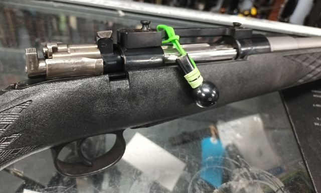

After bombing another thread about 6.5x55 and 140gr projectiles I thought I throw up my own after picking up someone else's broken Swede this week.
Quick recap, I noticed a M96 swede with a decent looking stainless barrel on the rack of a local gunshop, curiosity got the better of me so I asked to have a look and quickly noticed that the bolt handle was no longer attached to the Bolt and the rifle had a stuck but fired case in the chamber. Now being a fan of the old Swede I couldn't pass on the opportunity of grabbing what appeared to be a fairly recently rebarreled VGC action and stock.
PTA arrived so I popped over to pick up the rifle and the stuck case was quickly removed with a single strike of a cleaning rod down the barrel and into the case, Bolt was removed and the case examined.
Plenty of evidence of gas flow rearward down 1 side of the case, Primer flow into the firing pin hole, 10 thou case head expansion, the rim also had expanded somewhat. Case appears to be PMC.
Billo

Post by Billo » 20 Nov 2022, 10:21 am
M96 1913, Ramline stock, Uncle Mikes recoil pad, unknown 26 inch Stainless with Military type step down profile. The rifle presents in almost mint condition with the trigger guard and bottom metal complete unmarked. :thumbsup:

Post by Billo » 21 Nov 2022, 6:52 pm
Wm.Traynor wrote:What are the chances that the locking lugs in the action have been set back and does it matter?
So for the final instalment of what happened ??
Well I have no idea if the Lugs have set back but what I do know is the front of the action has let go on the right hand side :shock: :lol:
This is the left hand side, still straight
and this would be the weaker right hand side.......
looks like a lightly used Stainless barrel will be up for sale if It can be undone, now where is that plumbers wrench :drinks:
Billo
