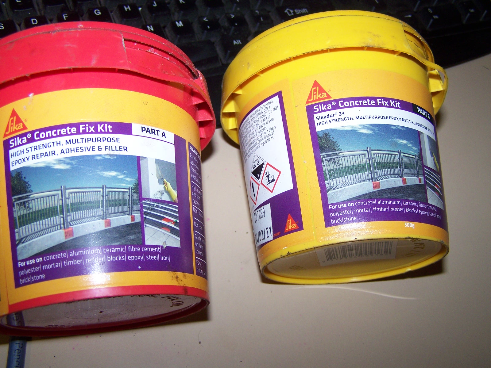

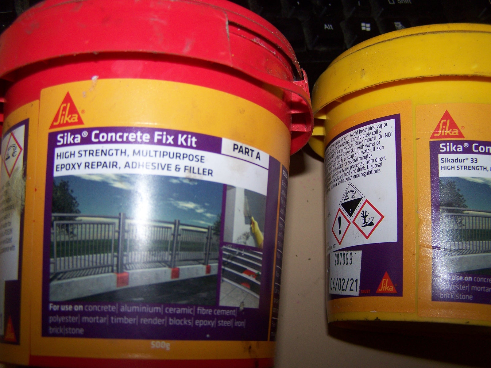

I have used this product on three different rifles for bedding.
I have also used Devcon but prefer the Sika Concrete fix Kit above and beyond,,,,,,,,,,
It does a fantastic job,,,,,,,,,,,, and is cheaper than Devcon.
Available at Bunnings Warehouse

The product I listed (with pics) above, is the best for the job that I've ever used, and way cheaper than the likes of Devcon.
1) You get an awful lot of rifles bedded out of those canisters
2) It has a very long shelf life (as long as the lids are replaced properly)
3) It mixes up fairly thick and isn't runny
4) Doesn't go off quickly (approx 12 hrs) so you don't have to rush the job.
5) Doesn't shrink
6) Excellent adhesion
What's not to like about all that ?
You seem to be fixated on using Araldite, :unknown:
The general opinions of several members above have not recommended its use for bedding
