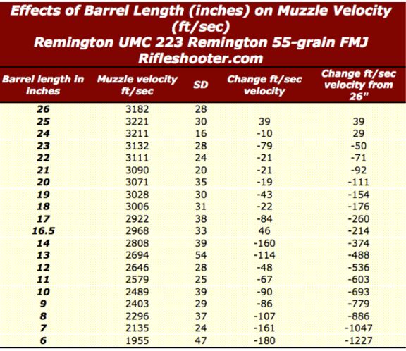

Post by on_one_wheel » 03 Dec 2023, 7:38 pm
Imo the only advantage you'll ever have with barrel length being on the long side is that it gives you a more accurate sight plane when using open sights.
Bust out the hacksaw and chop it down to the minimum legal length :thumbsup:
This might be helpful.
