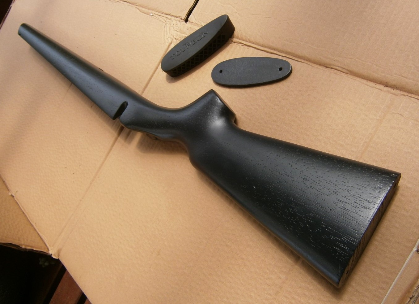

Post by GreyDog » 25 Dec 2024, 5:10 am
Rather than look for a gunsmith to tackle the front action screw thread mess, which appeared to be due to a cut down screw not finished well and forced into the thread(?); I went on the hunt locally and purchased a suitable new 1/4 UNF bolt and a tap to retap/follow the action screw thread (as the remainder of the thread appeared OK). It appears to have worked with the new bolt now able to be screwed in the full length of the action screw hole.
I originally had intended to return the stock to a timber finish, but put that idea in the too hard basket. Instead, I sanded out the runs and most inperfections in the black paint job, filled and sanded a few holes and dings and refinished the stock in spray can black satin acrylic auto paint. It came up well!
The original butt plate/rubber was a bit tatty and one of the screw holes was drilled very crooked. I opted to make up a new metal butt plate from some 3mm steel, to which I would attach a rubber/silicone recoil pad + fixed the crooked hole issue. The new plate did add a little weight to the stock, which i.m.o. is OK with a .308 cal target rifle.
refinished stock, new butt plate and recoil pad

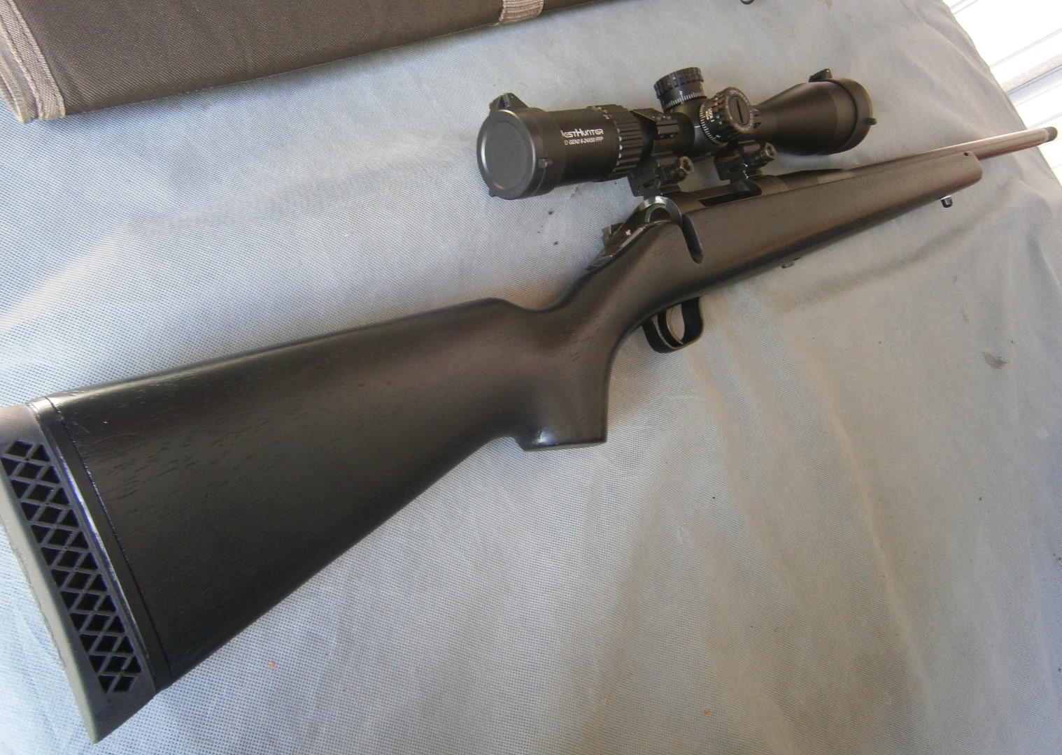

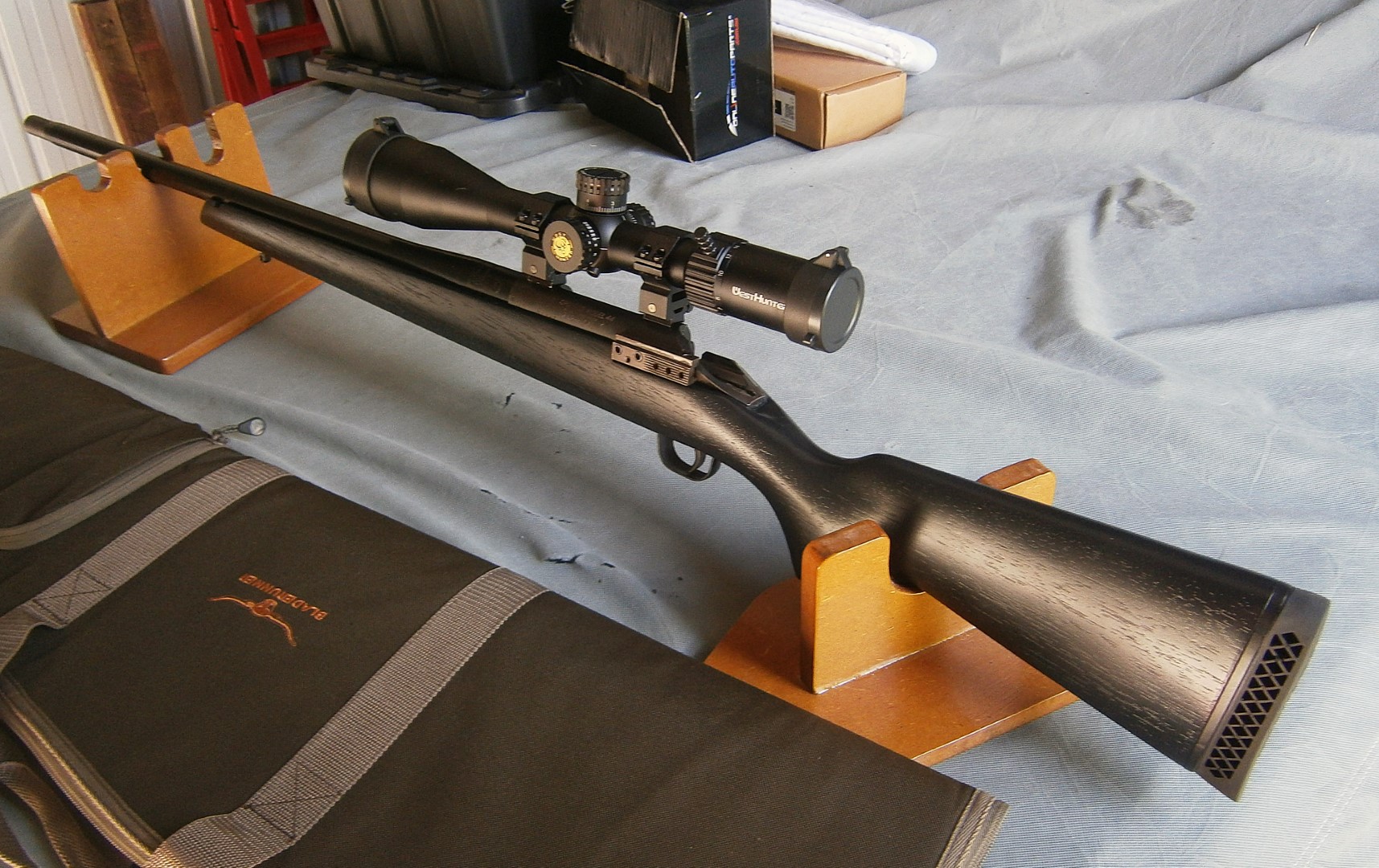

Post by GreyDog » 06 Feb 2025, 11:12 am
A few pics of the old Sportco M44 after a bit of a tidy up. Next step is take it to a range and see how well it shoots.

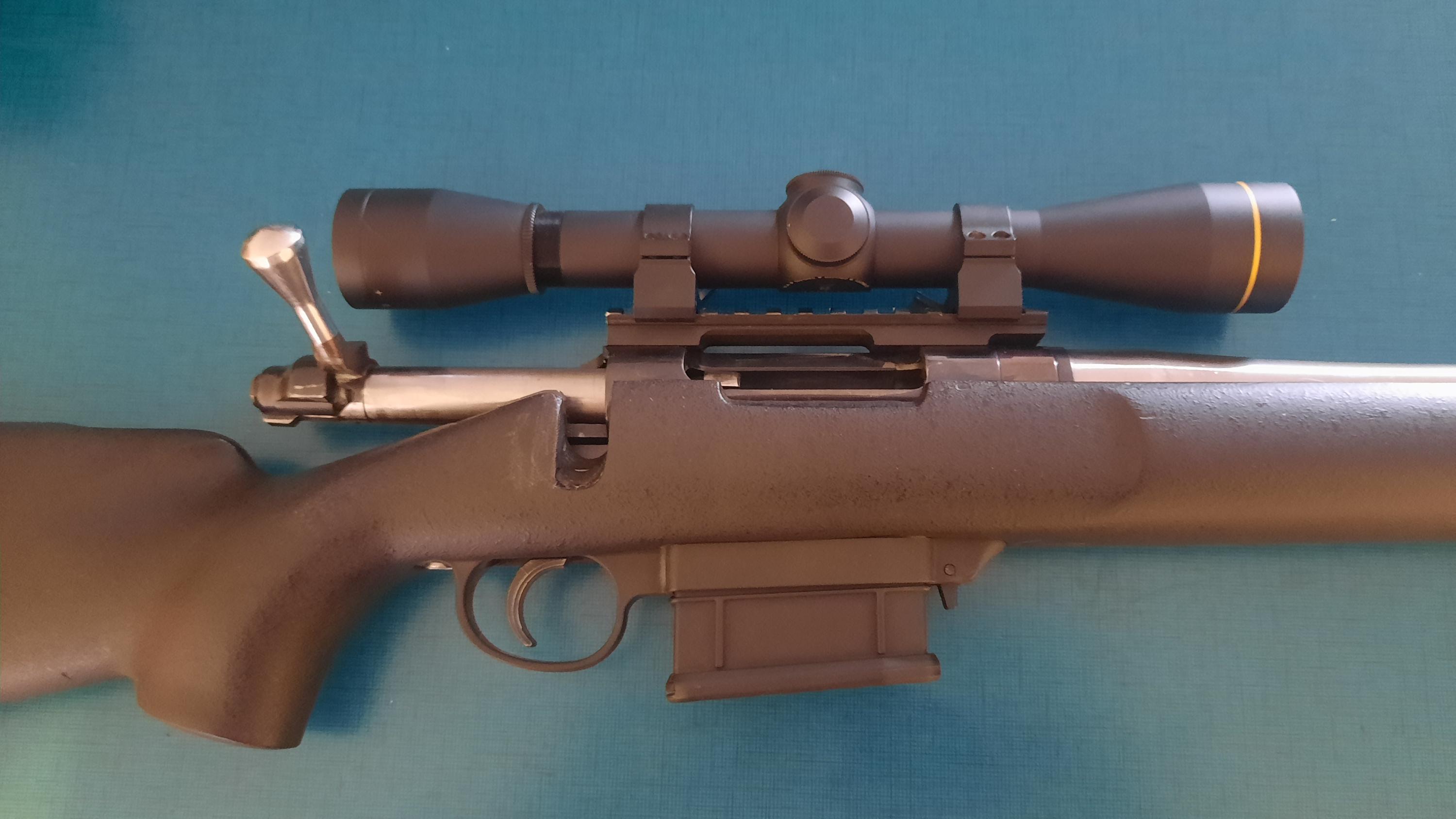

This is an Omark varmint rifle i did about 20 years ago on a Rem 700 PSS stock and floorplate then more recently added the Legacy magazine and floorplate.
The adapter that i made was done so to maximise primary extraction, something that is easy to screw up with commercially available adapters and has given Omarks an unjustified reputation for poor extraction. It is threaded to accept standard 1"x16 TPI barrels but the benchrest versions i did were 1 1/16"× 16 TPI to accept Rem 700 or clone barrels. The old firing pin spring has been replaced with a manganese alloy one that is wound in reverse so as to stop the dredded bolt jump that is seen on almost every Omark when dry fired. That little detail helped illiminate flyers back in the day when many of these actions were often seen at benchrest matches. Bolt handle was chopped and extended in stainless steel. The action has been milled to take it from a single shot to magazine feed.
I never underestimate the capability of a well built Omark action where i personally used one to qualify for the world benchrest championships some years ago. Their only fault is age and smiths that know how to fix them.

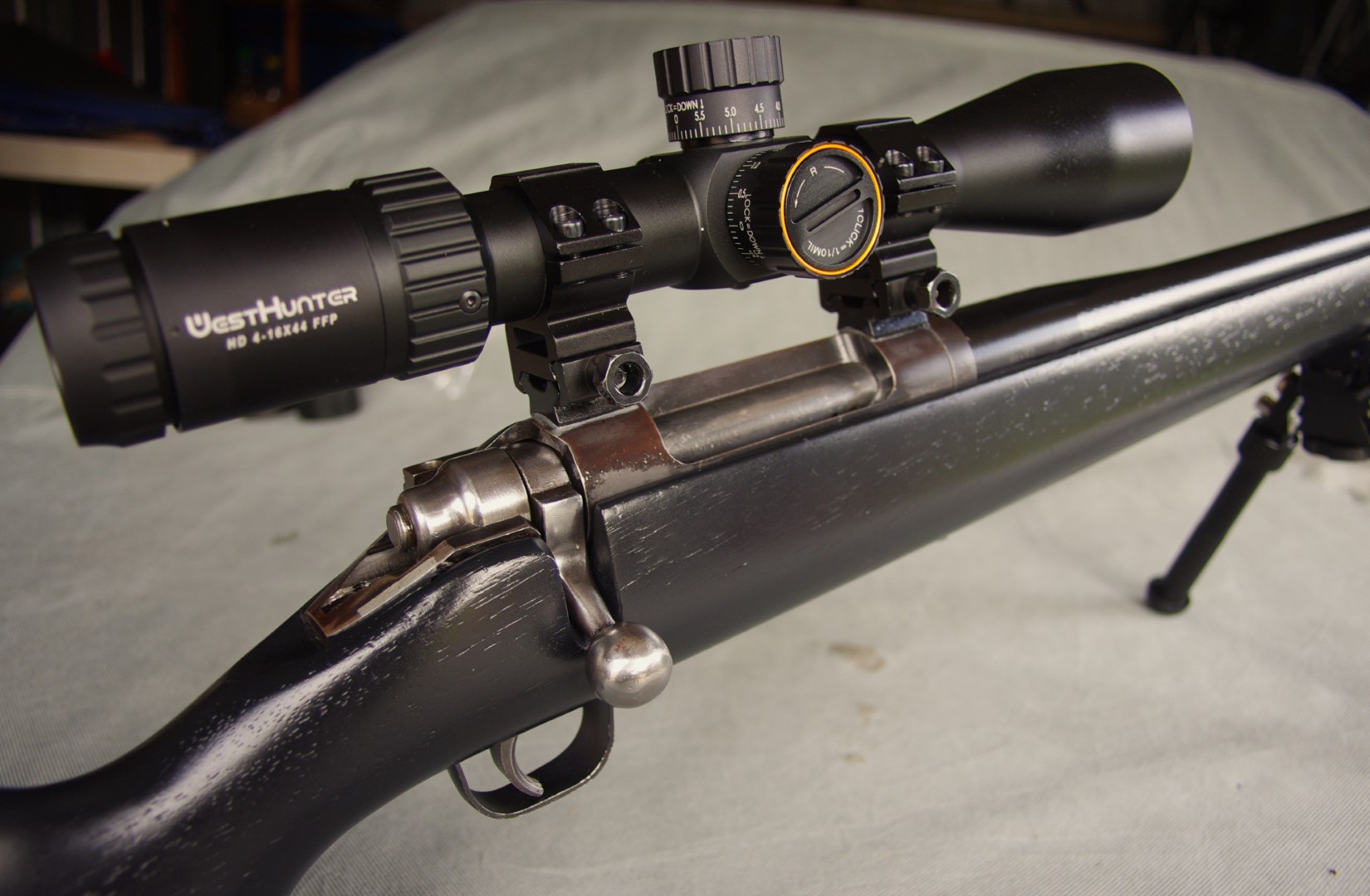

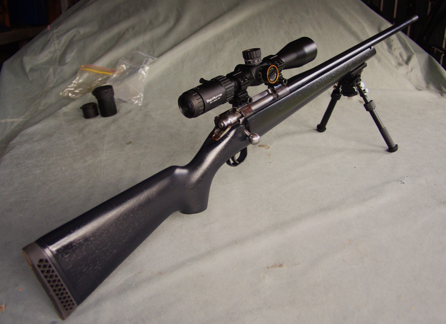

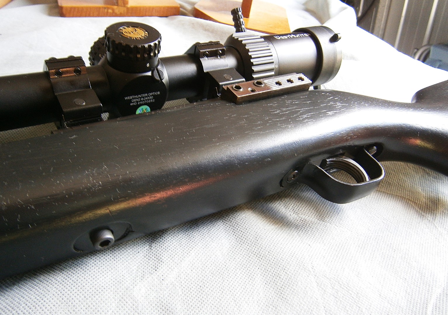

Post by GreyDog » 01 Jun 2025, 3:23 pm
Just an update. Well, the old Sportco 7.62 shoots OK thus far. But not without small dramas. I took the rifle to a range a couple months back and started at 50 metres to sight it in on paper after bore sighting it on a lemon sitting on my back fence at home. It was around the mark straight away and on target with some adjustment. The bad news was I had no left windage adjustment remaining on the scope. Knowing something must be wrong I took it home, pulled the scope off and eyeballed the weaver mounts. Sure enough they were crooked, not aligning straight with the barrel. Surely this wasn't the work of a gunsmith, but a home job by someone with inadequate skills(?) After earlier finding a botch job on the front lug screw, I wasn't surprised. One of the screw holes in the action (for the rear weaver mount) was particularly crooked, and the answer could have been fill that hole and redrill and tap it. But I took an easier option by drilling out the mount holes in the alloy weaver mounts and carefully filing the bases of the mounts to get an adequate fit of the mounts to the action. As well as the mount screws I also glued the mounts to the action with JB Weld. They won't come lose now and they are now straight. (sorry no pics of work in progress but a couple pics of the final job/rifle follow) I took it out to a range a week ago and sighted it in at 100 metres. The good news is the scope 'cross hairs' are centred and I have equal windage adjustment both left and right. Next range day I'll see how it groups at 200 metres.
scope and repaired mounts
IMGP2506 (Large).JPG (237.39 KiB) Viewed 11977 times
Sportco 7.62 with WestHunter 4-16FFP scope
IMGP2505 (Large).JPG (251.1 KiB) Viewed 11977 times
