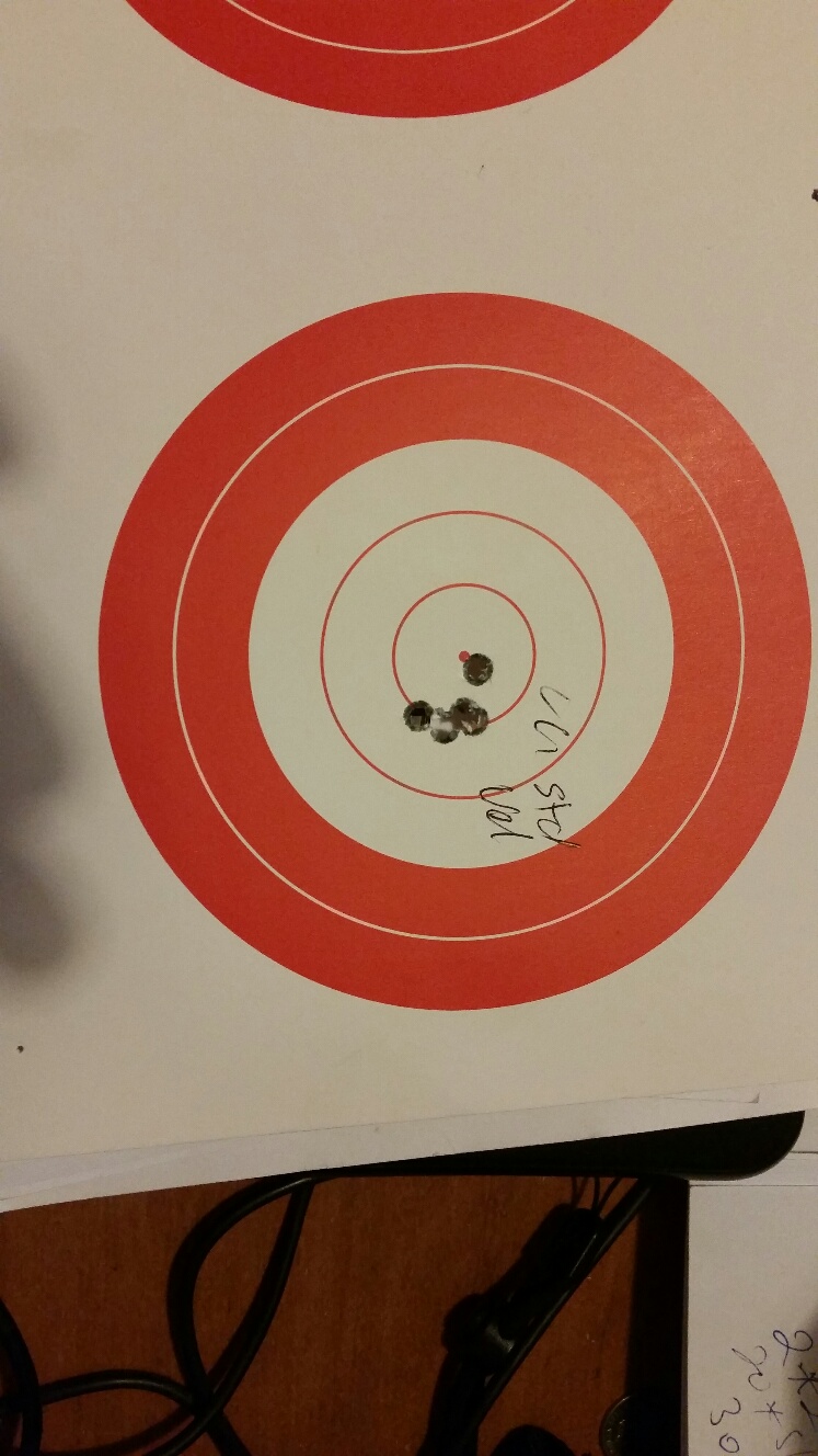

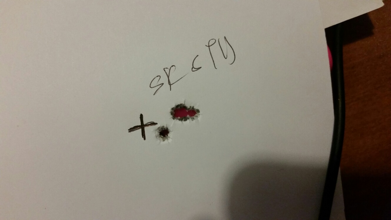

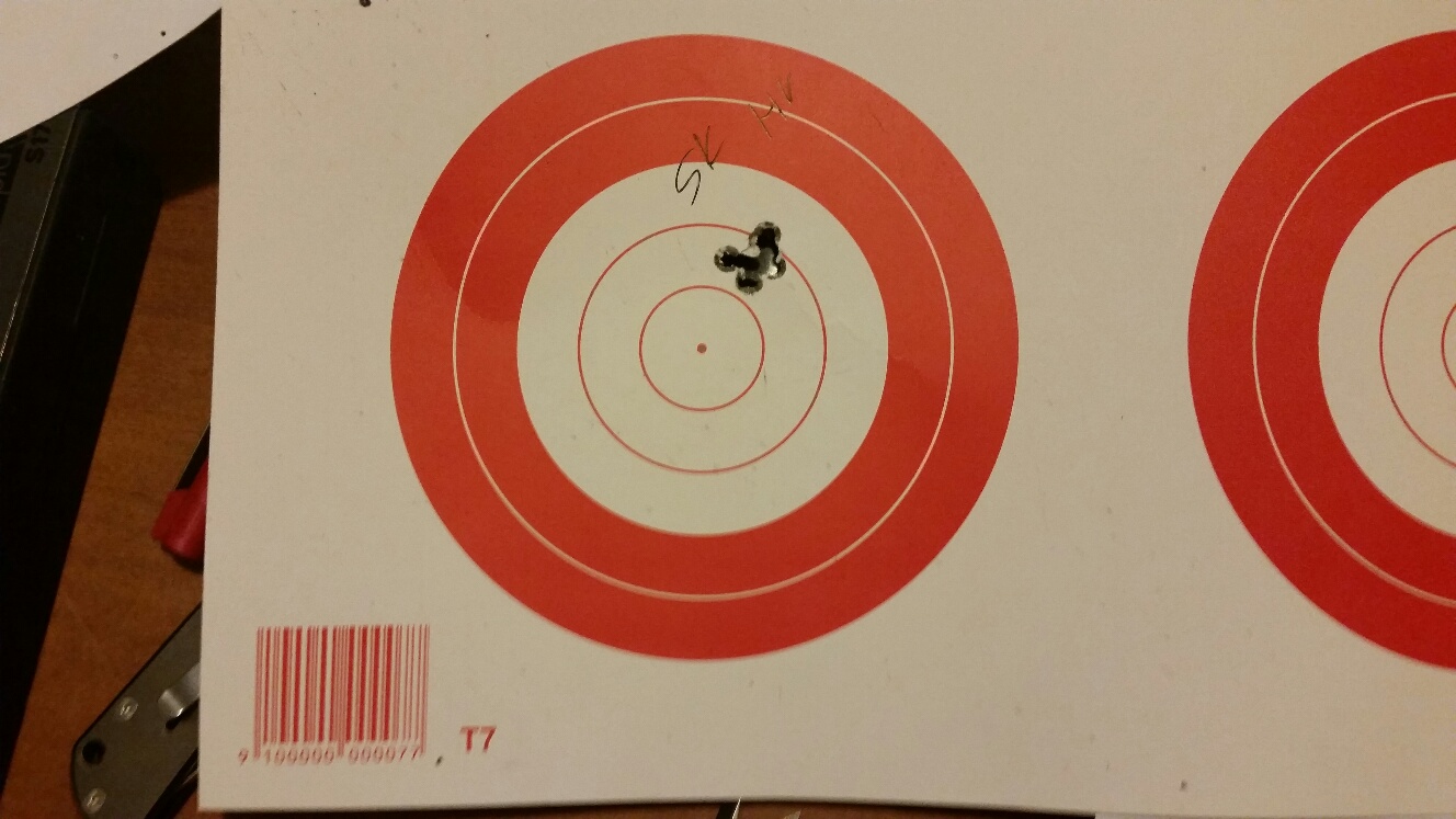

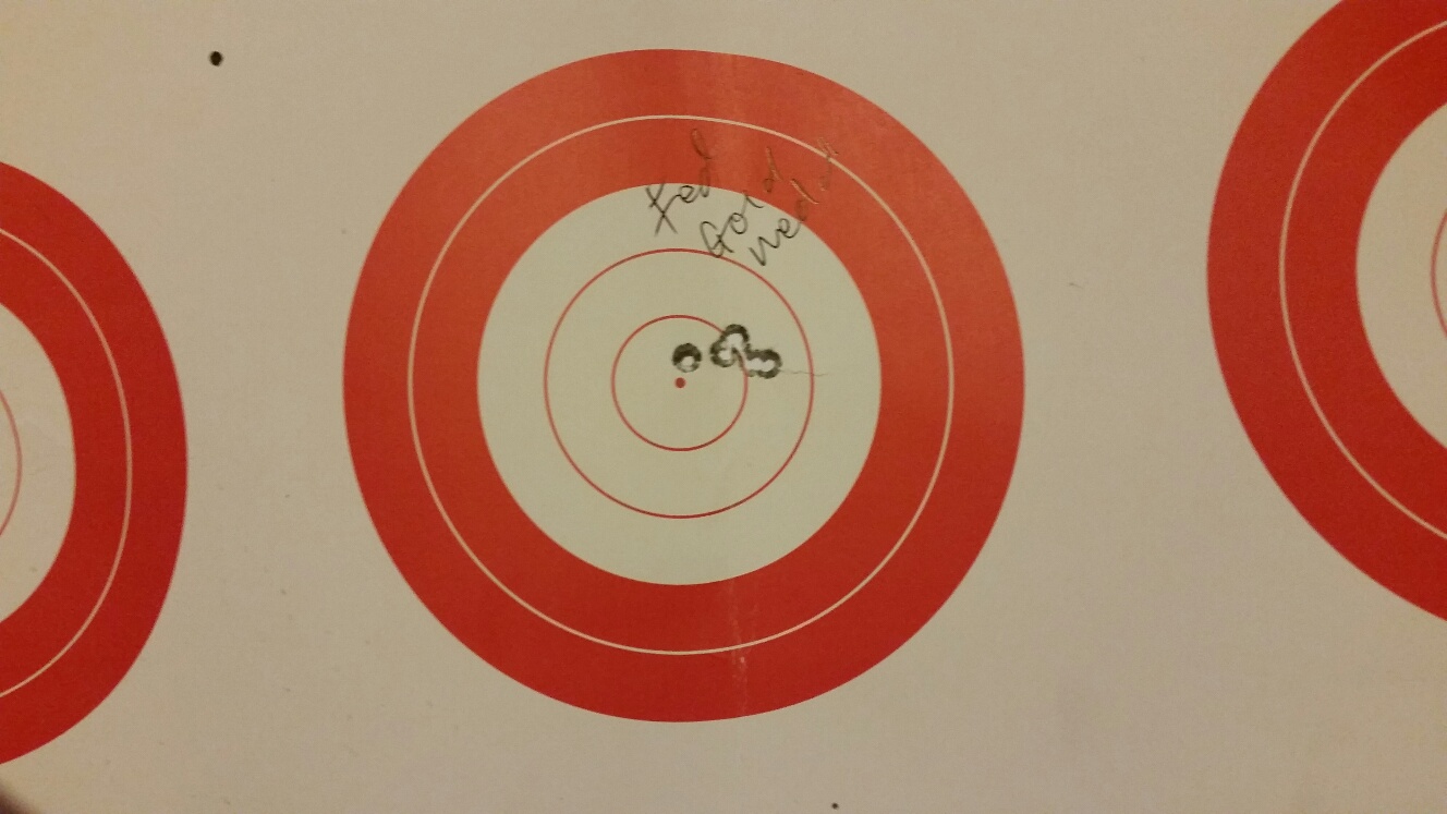

I've just finished doing something very similar to what you're talking about (maddco barrel on a CZ453 and a cone breech, trigger lightened to 1.5lbs, bedded) - although I went with a Bentz chamber instead of a match chamber since I wanted to use it as a field gun mostly.
I wouldnt choose a CZ action for a bench gun to be honest - theyre made to be very reliable in a range of conditions and they happen to be pretty accurate too but theyre not built with pure accuracy in mind.
a custom action or even an anschutz match 54 action would be better for a match gun. If you were going to use a CZ action regardless - the best action is the 453 varmint or the 452 American. Both of these have 2 action screws and a fully floated barrel, rather than one action screw and a barrel lug.
I buggered up one screw in the trigger group (so its only held in the action by 1.5 action screws) I shot it anyway - It shows promise (I reckon I can shrink the groups a bit more) - if you went with a match chamber instead of a bentz chamber, that would tighten up the groups even more. I'll retest properly when the parts for the trigger group come in from CZ
heres a few pics:

Post by jubble » 26 Nov 2014, 8:36 pm
Great cloverleaf on the third photo.
Always 1 flyer which wrecks such a good group :lol:

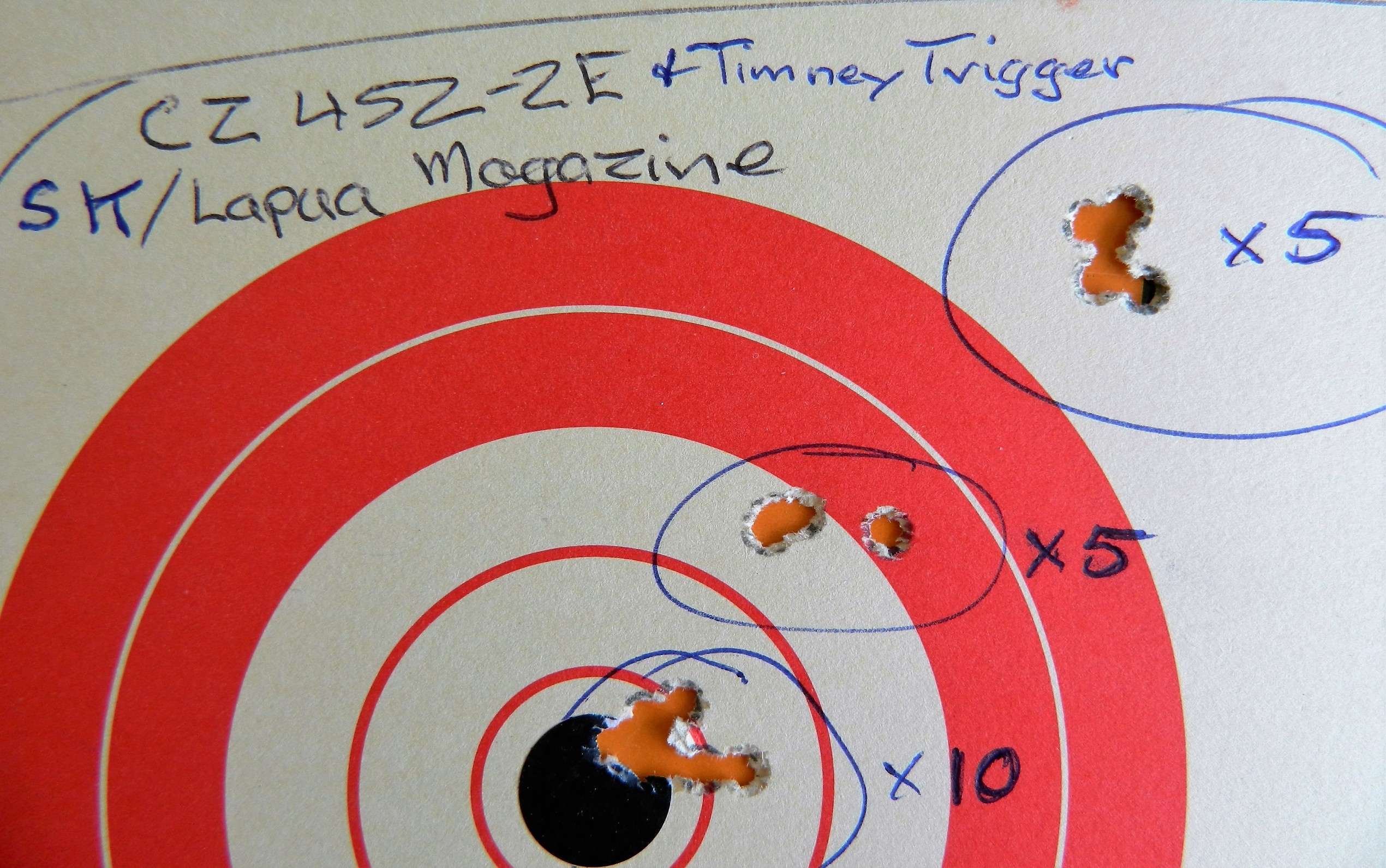

G'Day Fella's,
Binniespurp, I've replaced the CZ factory trigger, with a Timney unit and adjusted it to be both Light but most importantly SAFE!
Apart from that, I've floated the barrel, and these two changes, have improved the consistancy of the rifles group shooting ability.
The only remaining weak link, is the ammo used and of course me/the operator ...............
The CZ factory, hammer forged sporter weight barrel, is more than capable of shooting tiny groups, it's just a pity I can't.
