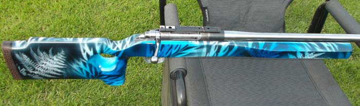

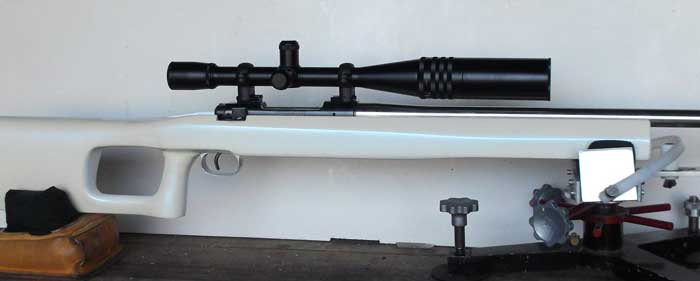

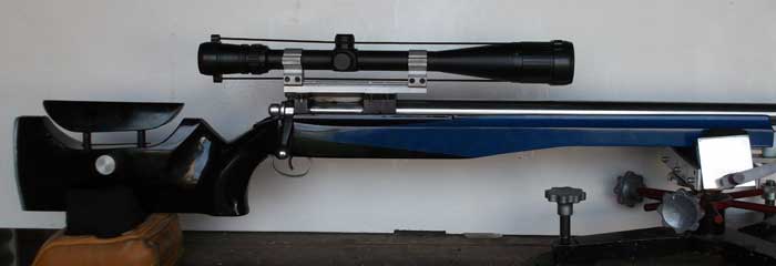

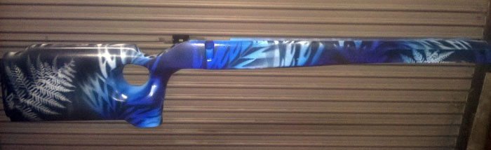

Post by 6mmdasher » 24 Dec 2014, 7:17 pm

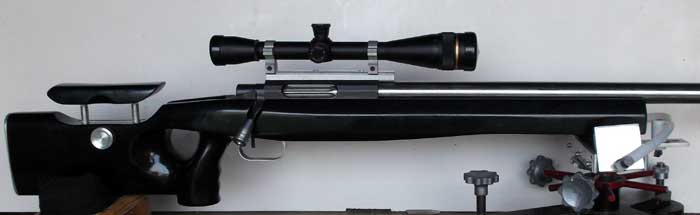

I have been making F Class rifle stocks for the past 7 years or so.
The only problem I have found is the it is very hard to finish without pinholes because of the open pores in the timber used in the laminates.
I'm using imported marine ply as it is around half the cost of Australian product, I can suppy photos to anyone who is interested.
Cheers. Merry Christmas.

Post by 6mmdasher » 29 Dec 2014, 8:16 am
6mmdasher wrote:I can suppy photos to anyone who is interested.

Re: Marine ply rifle stock
Post by Aster » 29 Dec 2014, 8:17 am
There you go mate, photos uploaded to a post for you.
Post by veep » 29 Dec 2014, 8:32 am
Love the blue tiger pattern looking one.

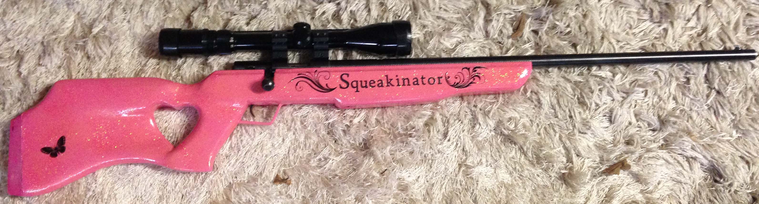

Post by DaleH » 29 Dec 2014, 5:24 pm
Tactice,
sorry for the late reply. Finished stock for daughter (please note) is attached
finished stock 2.jpg (343.42 KiB) Viewed 11425 times

Post by tactice » 29 Dec 2014, 6:12 pm
DaleH wrote:Tactice,
Nice one mate.
I'm sure "your daughter" loves shooting it.
(Your secret is safe with me :P :lol:)

Post by DaleH » 29 Dec 2014, 6:30 pm
She loves it and loves taking the piss out of the club captain who is adverse to pink guns. the love heart thumbhole and diamante edged barrel really set him off.

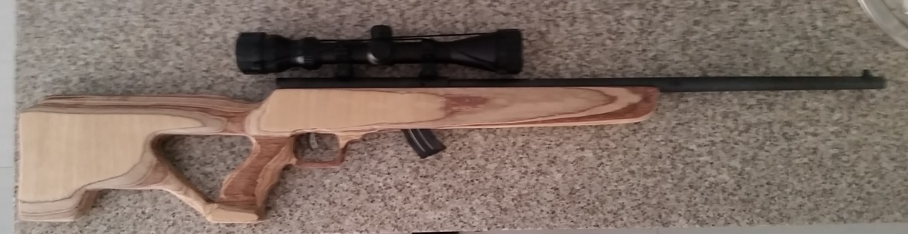

Post by Slixxor » 23 Jan 2015, 1:27 pm
Heres a pic of my homemade stock for my Savage Classic MKII .22. I'm using 'B' grade maple hardwood ply sourced from a local supplier on the Gold Coast here. The overall design suits my size and style of shooting. It has balanced the weight perfectly above the trigger allowing it to get on target faster and the reduce crosshair hunt.
The bedding is made of selleys kneadIT steel then machined using a dremel. It makes for a solid engagement on the action and when firing.
heres a pic of the almost finished surface. mostly made using a dremel, grinder flap discs and sand paper. template can be provided if anyones interested :)
let me know what you think!

Post by twoforty » 23 Jan 2015, 8:15 pm
So far so good :)
Shot it yet?

Post by Slixxor » 29 Jan 2015, 1:21 pm
Will post some pics up at the range. made some minor adjustments to the hand grip so it was a better "fit". :) Next is the Tikka varmint.308.. should be fine keeping the veneering together. :P
