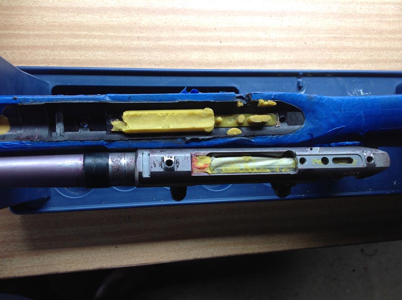

I pillared and bedded a Boyds thumbnail for my T3 just on 12 months ago, only had the synthetic stock on it for about 2 months and didn't even shoot it with the Boyds before i bedded it. I haven't done it before so it was more of a project trial but i believe i did a pretty decent job of it and it shoots a charm.
I dremeled it out to make some room and give the devcon something to bite into, left a real small part untouched at the rear of the action to keep height and taped some insulation tape around barrel to give it the clearance ahead of the action, used some newspaper and playdough to stop it getting into the action and some kiwi shoe polish as a release agent, Machined up some pillars and epoxied them in at the same time. It was a bit of a 'just have a go and see' but im happy with how it came out.
