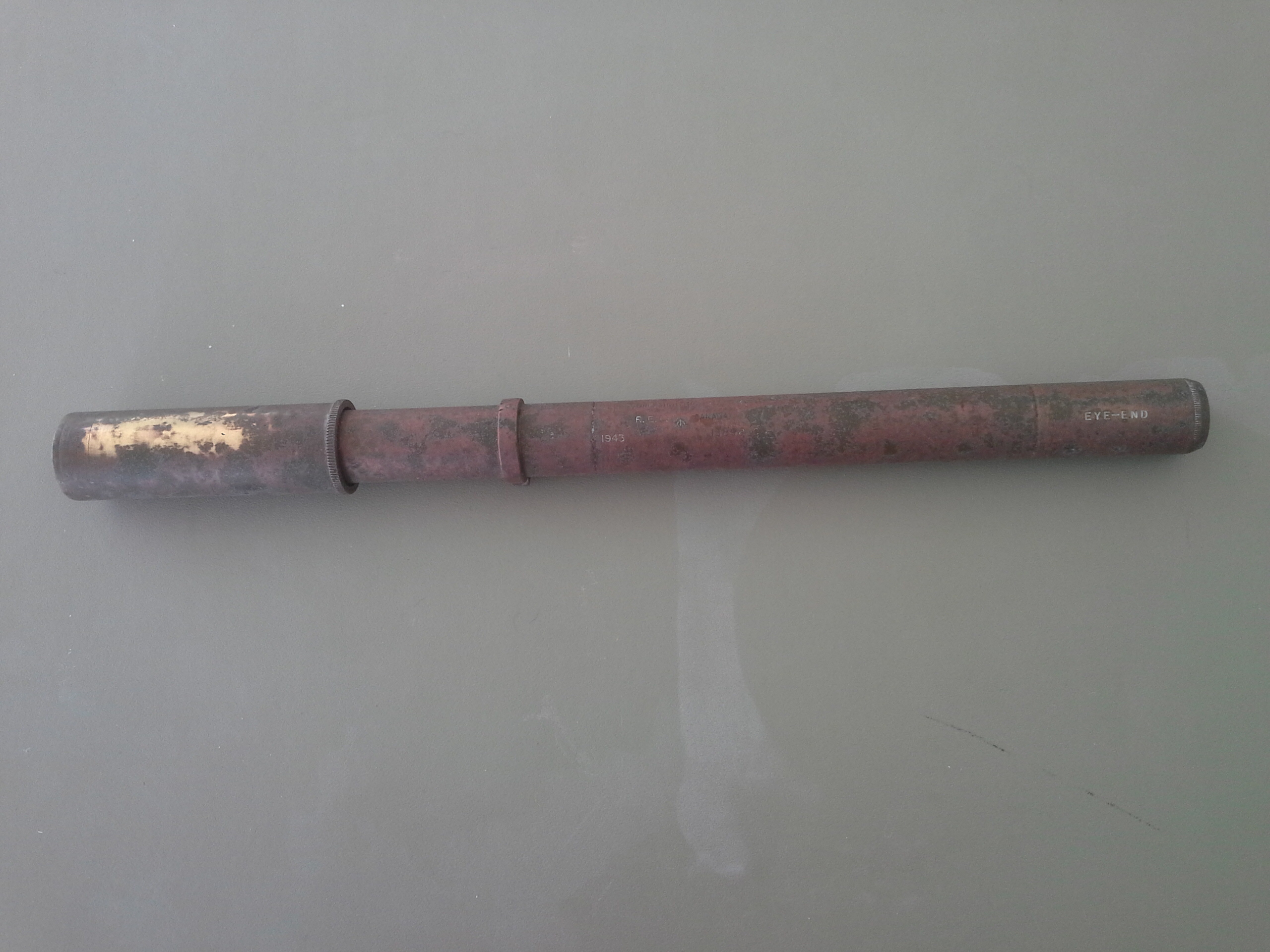

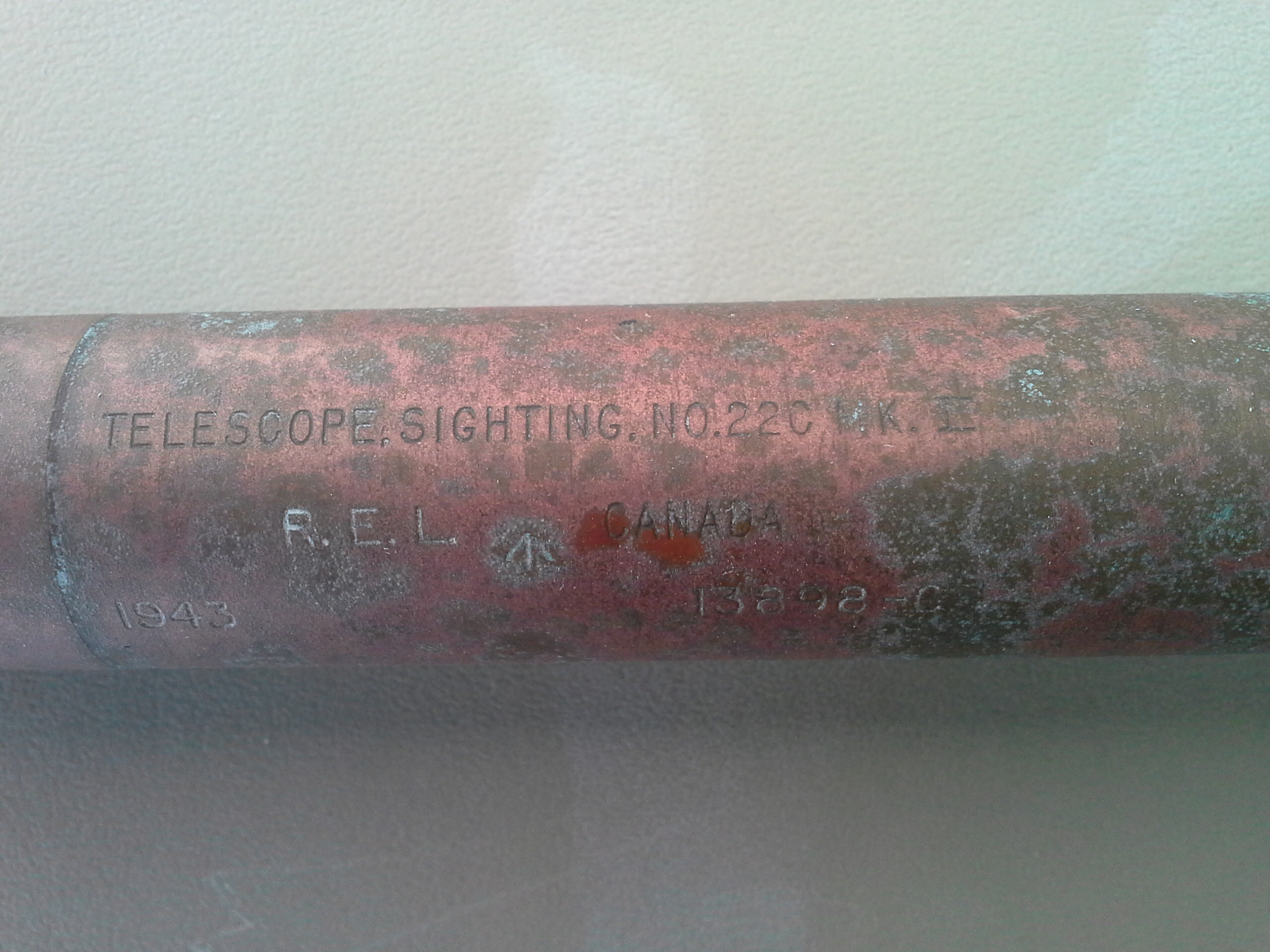

I have an old brass scope, and am wanting to clean it up. As normal for me I started without knowing what I was doing . So now before I stuff it up any more , what should I be doing?
Obviously it wouldn't have been shiny when issued, so would it be treated with something after?
Malco.

Advising on a project like that is risky . If you could pull it all apart and separate the metal tube from the rest it might be safer to do. All I can think of is try rubbing it with very fine steel wool soaked in CLR . Work on small patches at a time and flushing off with targeted hot water in a big syringe . Tape up over and around the lenses and do that bit last . I doubt that the scope is very water proof now so it's a risk. With pitted sections let some CLR just sit there in the pits for some time to try and eat the patina corrosion out . If fine steel wool is too aggressive try a hard tooth brush .

Thanks for the reply Jack v, CLR might be the go. When I get it cleaned up , and it's all shiny, would it have been coated in something? Being a 1943 Aus Army issue I doubt it would have been left bright and shiny. Regards malco.

It most likely would have been blued or painted like this one http://www.germanmilitaria.com/OtherNat ... 91762.html
I suspect from that photo it's some kind of coating as it appears to be flaking . You can see the brass colour where it's come off .
The Article says "original Green paint " It don't look green to me but it could be .
On the other hand your scope does look like it was a drab Olive Green colour or that green comes from brass corrosion I'm not sure .

Jacky v, Well done mate , that is exactly the same as mine . Now I know the direction to go. Thanks for your help mate. Regards malco.

What's the outside? Copper?

Looks like brass with some typial green coloured corrosion to me. Must have been painted originally

Jack V wrote:The Article says "original Green paint " It don't look green to me but it could be .
Green paint + 70 years?
