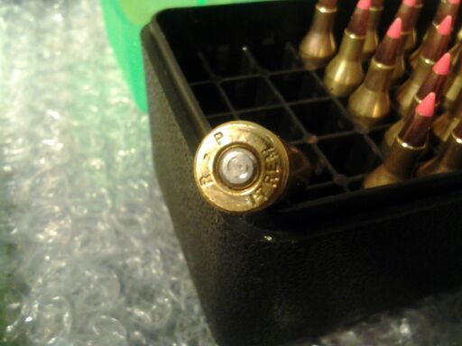

- I noticed an odd looking ring impression part way around a fired primer. Didn't really look like cratering to me.
primer damaged flared firing pin hole.jpg (27.63 KiB) Viewed 10244 times

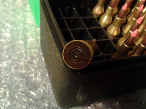

- Chambered then removed another round and inspected the primer and see the same ring impressed into the primer !
Unfired primer damaged flared firing pin hole.jpg (26.39 KiB) Viewed 10244 times

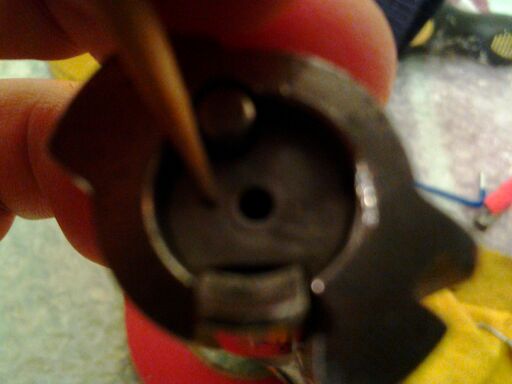

- Inspected the bolt face and sure enough there is an area on one side of the firing pin hole that has outwardly flared very slightly with no burs (I don't have a depth mic to measure it) but my calibrated eyes and feel suggests ~5 thou. It is enough to contact the primer when the bolt is locked down and to impart a ring into it as the bolt is rotated down and back upwards with out firing it.
- It doesn't seem to be cutting/scoring into the primer but more a smooth pressed ring even when the bolt is rotated as there is no sharp edge to it.

It is definitely bolt face metal on one side of the firing pin hole flaring up. It is smooth but raised. Very hard to see but I can feel it with my nail and fine dental pick I use for feeling burrs and scoring etc. Tried to take a pic with my crappy phone camera but it wont show clearly enough. It isn't raised much and the surface is too shiny for me to get a defined clear pic.
Just uploading a couple of the primer damage that if opened up a bit bigger should show the result.

Completely off topic but what are those pink tipped bullets?

Didn't have any fine flat rub stone tools and deleted the idea of using the Dremel with tin flex shaft attachment on low speed... too afraid so thought back 20 years to <1 thou tolerance hand tool making even though do I love my man toy Dremel 4000 :lol:
did the job as it wasn't all the way round I had to focus on a thin lip... PITA !!
Tikka M55 firing pin hole blend - shaved a kebab stick in 800 grit.jpg (7.87 KiB) Viewed 10182 times
clear high area almost blended out enough
Tikka M55 firing pin hole blending high area.jpg (21.38 KiB) Viewed 10182 times
I did take an hour for what could have taken 5 mins if I wasn't afraid of fcuking it up. :ugeek:
tested with light and mini straight edge. flat. no scalloping. fine enough with inner edge lightly de burred only
Tikka M55 firing pin hole blended.jpg (23.3 KiB) Viewed 10182 times
After removing the high without going over board there's no more contact to primer when closing or opening the bolt. Yeh !!

Aster wrote:Completely off topic but what are those pink tipped bullets?
17 Rem loaded with 23.5gr AR2208 + Hornady metrosecksual 20gr V-Max.

There is a pic up top of an Un fired primer with cuts in it after I unloaded. I tried it with 4 random rounds and all got the same.
The pics are rubbish I know. Phone camera in poor light. Up close in hand and it looks worse.
The fired one has the same cuts outside the pin hit and you are probably right in that there is some cratering also.

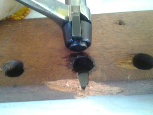

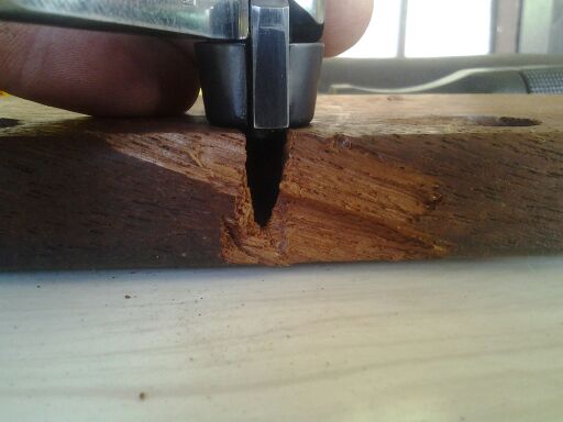

Removed firing pin assy from the bolt for a clean and look-see and all good. Just used taped up pliers to remove. Refitting isn't so easy.
To depress the shroud I used a scrap piece of wood with hole that the firing pin assy could slide in while stopping the shroud. Chiselled out a slot for the firing pin side tab to slide into and stop it rotating. Pushed down on bolt compressing the spring till it's little locking lug was seated, rotated the bolt, re cocked it by hand and voila :thumbsup:

Cut the piece of wood with the hole+slot down to a 2"x2", it is quite easy to de cock and disassemble/reassemble.
As far as 'easing the spring' when not I use; is it really necessary?
Will leaving the spring compressed actually reduce it's ability to push in my lifetime?
