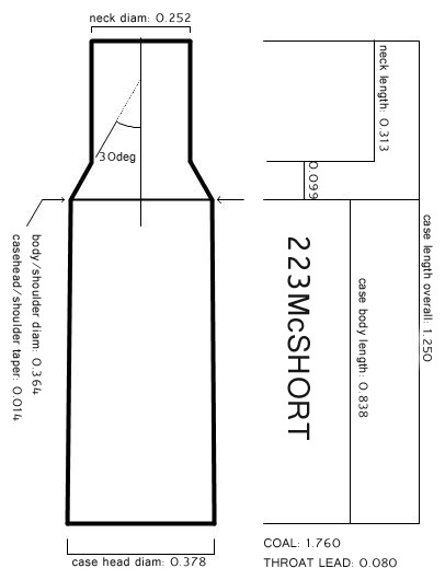

Update. Custom dies have been ordered for the 223McSHORT:
Form/trim, full length, neck sizer and seating die.
Brass will be run through the form/trim die in the first pass, then trimmed roughly to length, then through the full length sizer and put on a Forster neck trimmer. I will also turn the necks down, but this isn't necessary on the standard 223short., as the reamer is spec'd for an unturned necked down case. I just feel this is too thick for easy seating and consistent tension so this is one of the changes i am implementing. The case neck/shoulder will then be annealed before fire forming.
It will be a job to size all the cases because i have about 400 x 233rem cases, but once i do they should last many many firings, especially with periodic annealing to prevent split necks.
Other changes to the McSHORT are 30deg neck as opposed to 23deg as well as the same neck length as a 222 (0.313) as opposed to that of a 223. There is also a slightly longer body length due to change of shoulder angle (from neck/shoulder junction) and slightly less taper. These changes should give a slight increase in case capacity and with the 30deg shoulder i'm hoping for some better velocities as well.
Accuracy for the SHORT has been quite good in the States but there's been speculation that the 30deg shoulder and 0.313 neck length may aid in refining accuracy as well. So, i thought i'd give these changes a run and see what happens. :unknown: :drinks:
Specs of the 223short & 223McSHORT on the pics below.

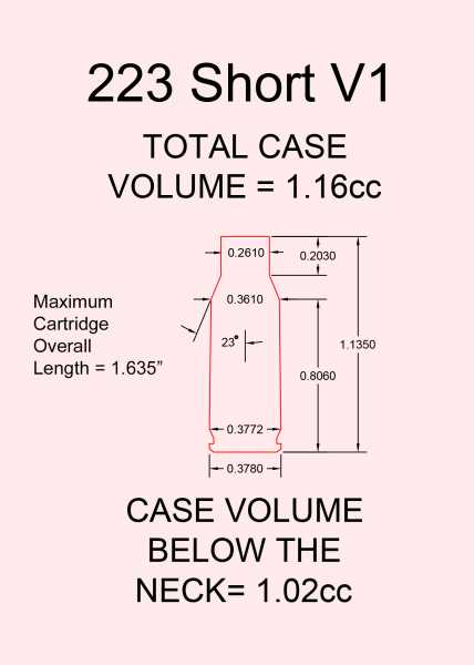

223short ORIGINAL case specs
223McSHORT case specs
