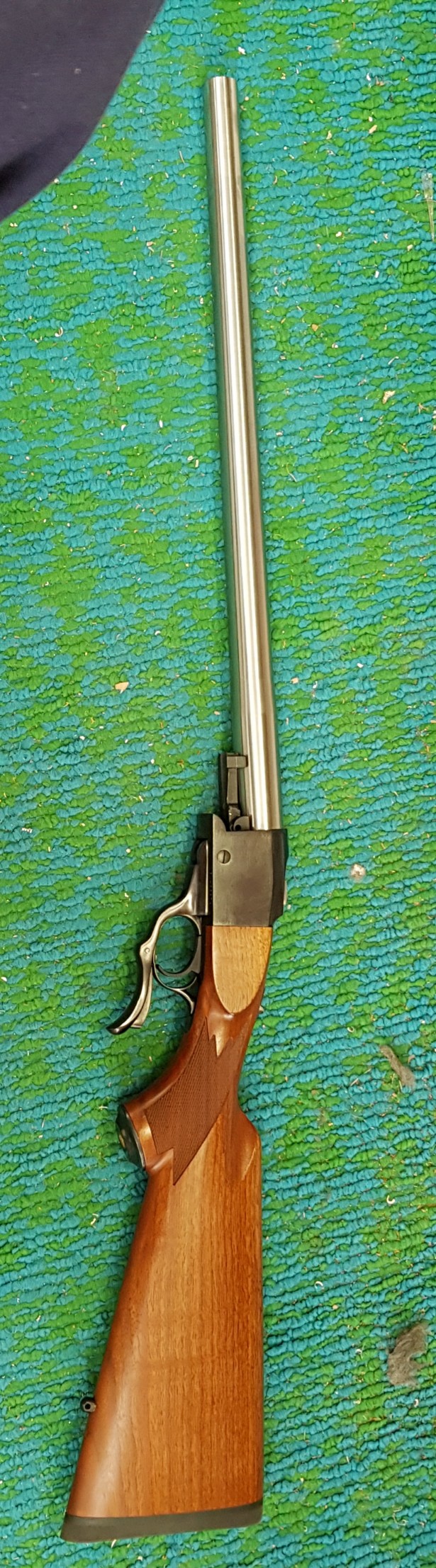

Benitez
Its a ruger number 1 chambered in 500 Smith & Wesson I am working on at the moment.
I chambered and fitted the barrel yesterday.
Had a long wait (15 weeks) for PTG to supply the reamer.
But finely started the build.
Marcus

Re: Rebarrel a single shot
Post by SillyWetTas » 14 Mar 2018, 4:36 am
SillyWetTas
Posts: 22
Post by marksman » 14 Mar 2018, 7:27 am
very very nice :drinks:

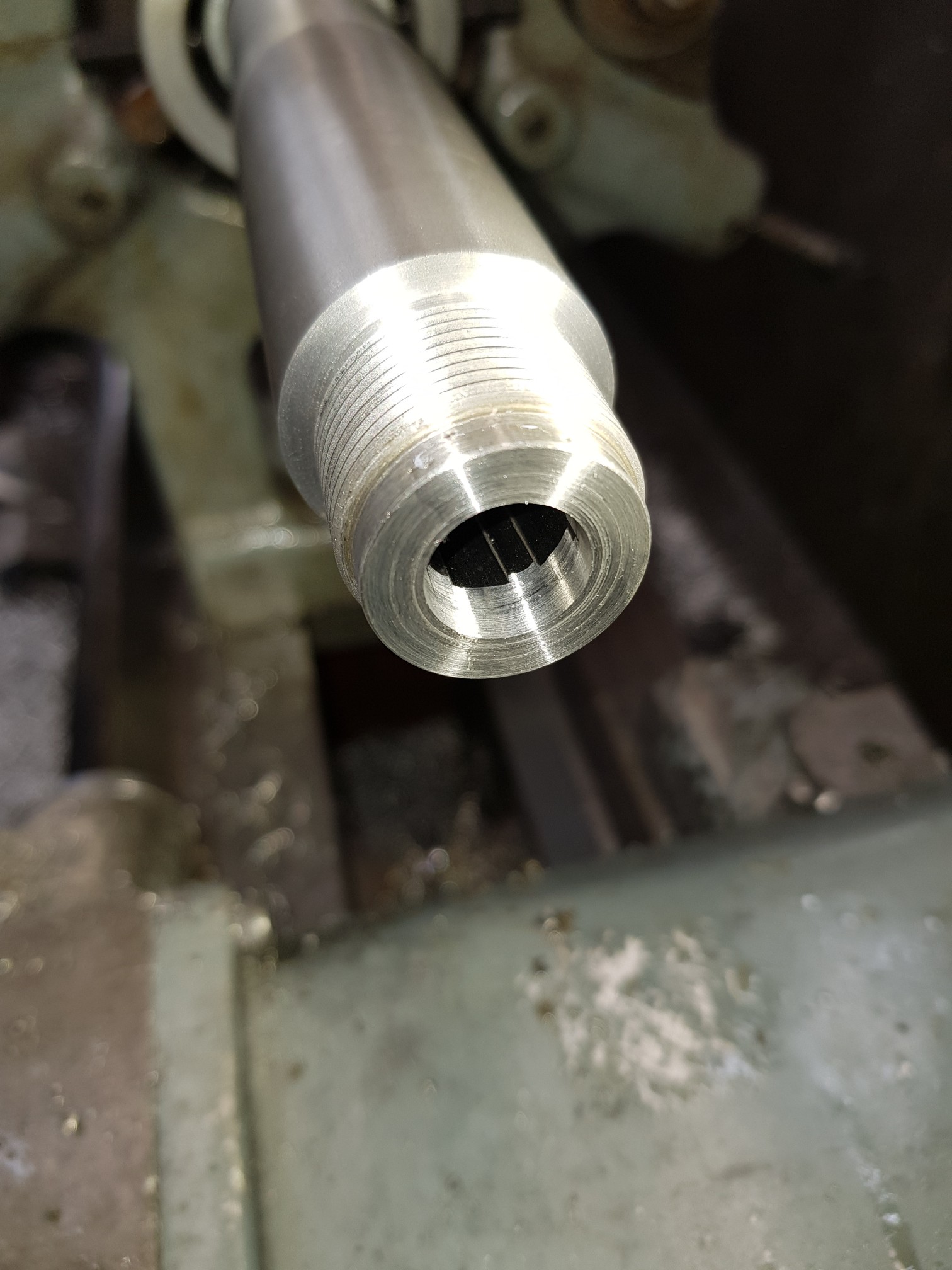

Post by sungazer » 14 Mar 2018, 8:42 am
Has that barrel been threaded but not reamed as yet?
Post by SillyWetTas » 14 Mar 2018, 9:16 am
Sungazer.
That's correct .
I had just started reaming the chamber at that time .
So the reamer was just in past the end of the mouth of the case.
SillyWetTas
