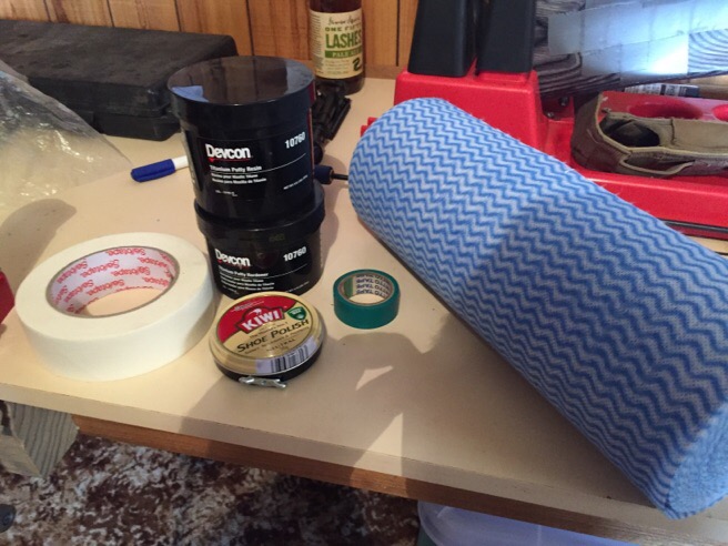

I used Devcon Titanium Putty as the bedding agent. (Probably not ideal but I had it on hand)
Used Kiwi neutral shoe polish as the release agent it worked great I just used a metric s#!+£oad of it. (this was for me the most nervous part as if I glued the rifle to the stock that meant a new stock and I didn't want that)
I was so worried I fact that I tried to remove the stock from the gun before it had cured and the resin started to seperate (like when you stretch chewing gum) so I clamped it all back together and stressed out till it was cured and then hoped for the best. It came apart.
I used electrical tape to hold the rifle into the stock while it was during and later on I threaded the action screws in (coated in shoe polish) and firmed it up. I used masking tape to stop the epoxy getting onto the outside of the stock.

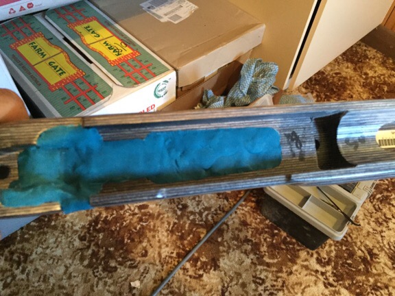

Also used play dough to fill in any holes in the action and stock I didn't want glued up and epoxied shut forever.

Post by MalleeFarmer » 02 Feb 2016, 12:28 pm
Stock filled with playdoh

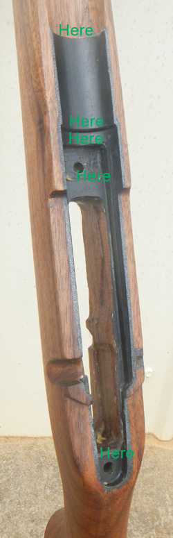

Here's a pic of the Zastava stock just after bedding. I have marked 'Here' in green on the areas i was saying to pay attantion to cleaning up or 'relieving'. It's obviously a different action but the principle is the same. Also make sure there is plenty of clearance in you mag well, so that nothing rubs when you screw it all back in.
Zastava Stock bedded relief points..jpg (82.86 KiB) Viewed 13355 times
