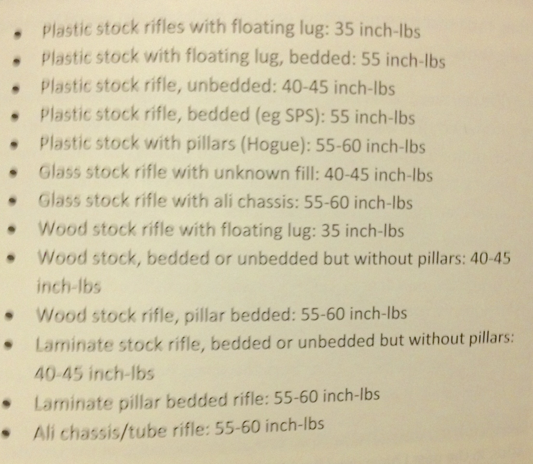

It's not quite so simple. Different stocks, different bedding systems; all require different torque to shoot their best. Trial and testing is best, beyond some basic guidelines.
Re: Torque Wrench for firearms work.
Post by Gwion » 24 Feb 2016, 8:49 pm
From Nathan Foster's book: A Practical Guide to Bolt Action Rifle Accurizing & Maintenance;
Post by on_one_wheel » 25 Feb 2016, 6:34 am
Gwion wrote:From Nathan Foster's book: A Practical Guide to Bolt Action Rifle Accurizing & Maintenance;
Thats a really good starting point ... I guess from there it comes down to fine tuning , trial and error.

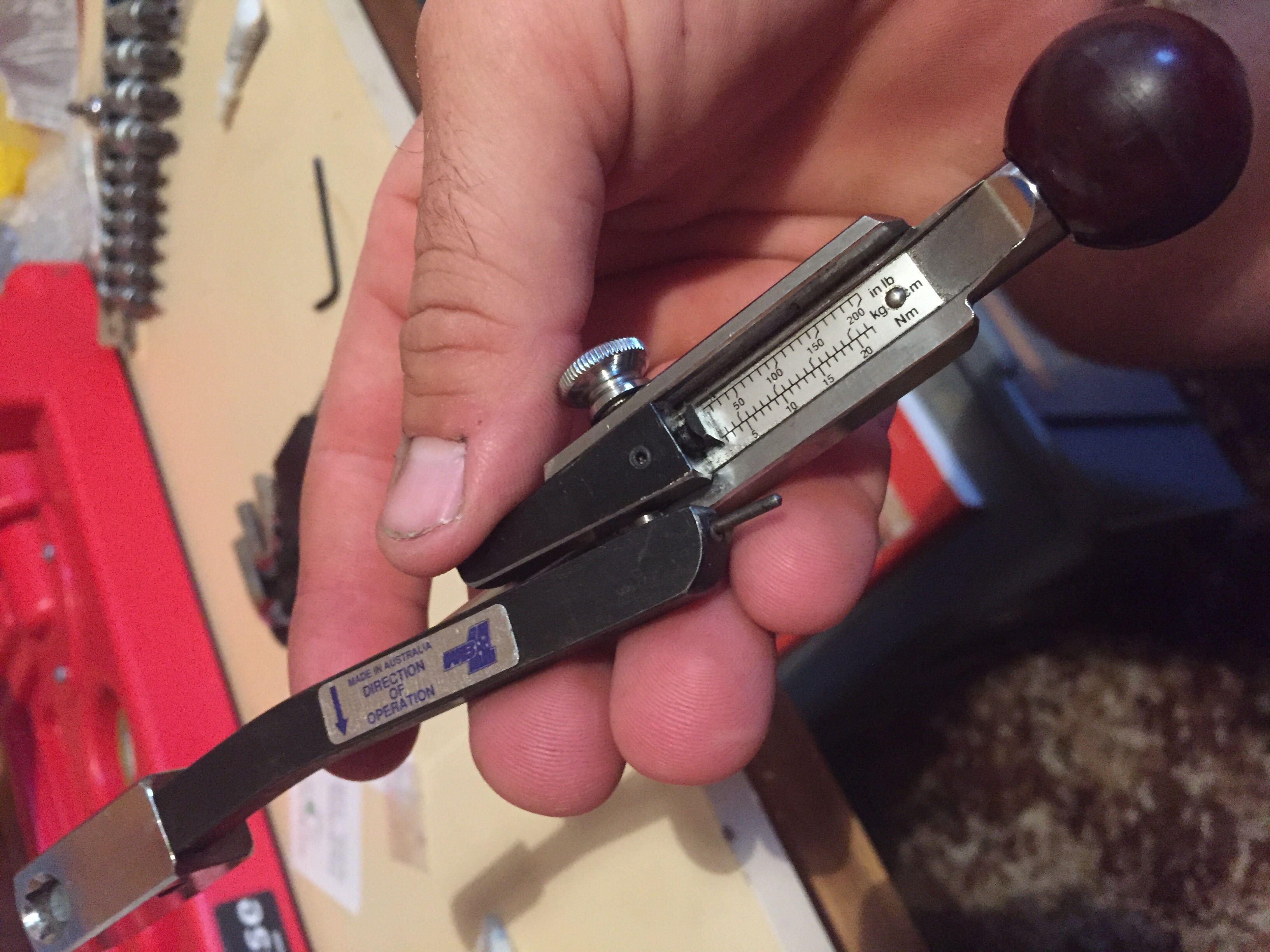

Post by MalleeFarmer » 26 Feb 2016, 7:26 pm
Here it is! And I've already remounted my ET6945FG scope to my howa .308 with a EGW HD 20 Moa base and Matching HD rings.
(Rather than the weaver 2 piece bases and el cheapo rings it had.)
Used EGW specified torques and the action screws torqued to what gwions posts said earlier.

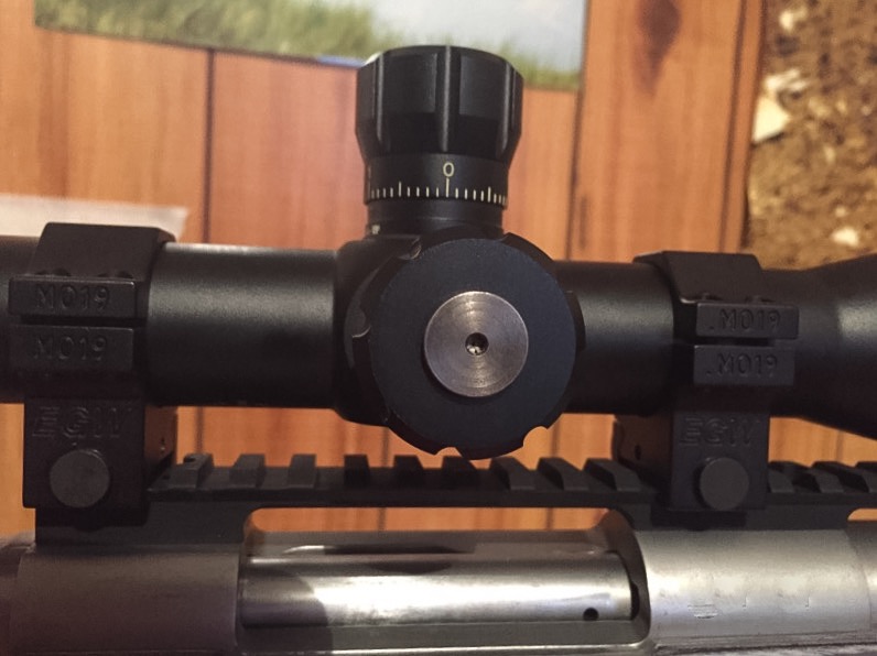

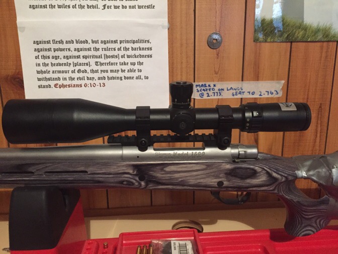

Post by MalleeFarmer » 26 Feb 2016, 7:49 pm
Here are some pics of the finished product.
