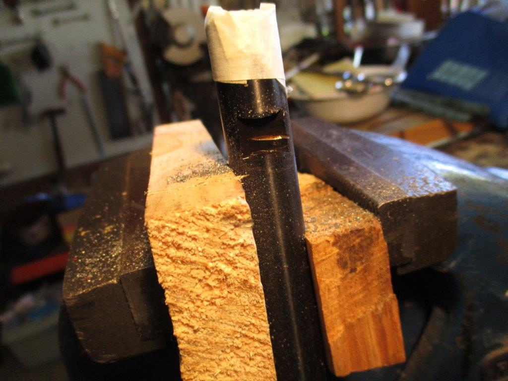

The foresight of one of my rifles will not budge. It was clamped vertically at the muzzle, between two pieces of wood. I am hitting a brass rod with a fair sort of Chinese hammer and all it does is rotate. And my good drift is bent.
Thinking of hacksawing it until it falls out in bits. Would be quicker and cheaper than a 'smith. This one has defeated me :wtf:

No. Lube did not work. Applied the tip of a half inch soldering iron for 5 minutes without success. Hacksaw And Dremel worked. I always knew it would.
Putting the replacement in was a performance too. Got about half-way before quitting. Gave the bottom of the new sight two strokes each in both directions on a single cut file. Got about three quarters of the way and reversed out. Cunningly, I gave it One stroke in both directions on the file and am now very close. Cleaned up the burrs on the dovetails too and applied moly grease to the dovetail in the barrel and on the sight.

Post by Wm.Traynor » 09 Apr 2016, 11:21 am
Here it is. Sight removed, scar remaining.
