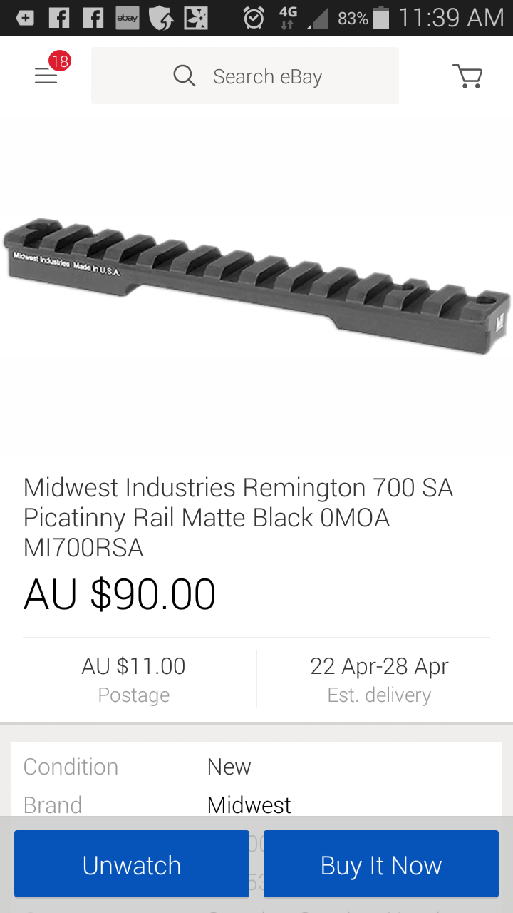

Post by on_one_wheel » 19 Apr 2016, 12:30 pm
What are your thoughts on this one ?
Re: Remington 700 scope mounting options
Post by happyhunter » 19 Apr 2016, 3:37 pm
Sounds like you want something like Badger Ordinace or DD Ross rails.

Post by on_one_wheel » 20 Apr 2016, 3:51 pm
Varmtr, were you able to mount your scope nice and snug with your rifle using a pic rail?
When I googled pictures of rem 700's with rails the search showed nothing but rifles with scopes mounted quite high.

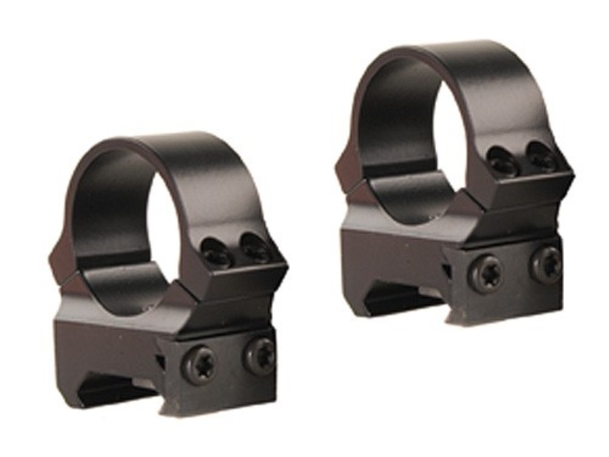

So far I'm still liking the rail pictured above and I'm considering some Leupold PRW rings if they will mount the scope low enough.

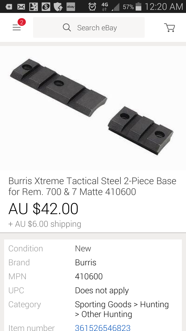

I'm going cold on the idea of a one piece pickatinny rail.
They are seem to be taller, likely to prevent the ejecting brass from being obstructed and to allow access for loading.
The full length rail looks like it'll make reloading my internal mag difficult and I'm not wanting to do a drop out mag conversation just to make the full rail user friendly.... I can see a couple of down sides to drop out mags in my application.
I'm now looking at a 2 piece steel mounting system, there goes my idea of the most solid mount. :violin:
