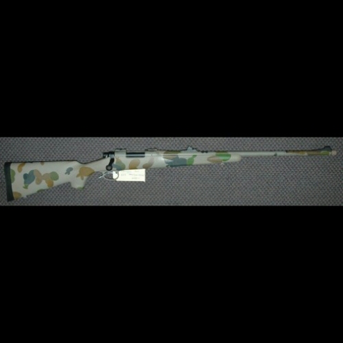

I picked up a very cheep Remington 700 synthetic in .223 that someone had taken to with spray can and paint brush, it looked to be in good condition with little wear on the back of the lugs and crisp looking rifling.
The barrel has been threaded perhaps to fit a muzzle break to control the savage recoil of the almighty. 223 ?
Here's how it looked.
2016-05-02 15.15.45.jpg (47.49 KiB) Viewed 3912 times

Post by Gwion » 02 May 2016, 6:57 pm
I can't see a rifle in the first pic......
Re: The ugly duckling build
Post by on_one_wheel » 02 May 2016, 8:33 pm
Trust me, it's there :lol:
Post by brett1868 » 02 May 2016, 8:40 pm
Scroll down a bit and cover your eyes cause it ain't pretty. The transformation looks good though :)
Post by Gwion » 02 May 2016, 8:44 pm
Hehe... was a silly cammo joke. Certainly is a good result. :thumbsup:

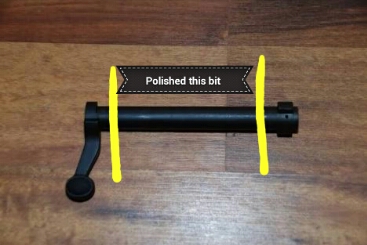

Chronos wrote:"linished and polished the bolt"
Tell me you didn't say you linisher the bolt?
Sure did, it had the surface finish of a bitumen road, now it slides smooth as my jeweled BDL
I've only removed the slightest bit of material from the section between the lines.
2016-05-03 10.25.16.jpg (68.47 KiB) Viewed 3826 times
Dose it give you concerns Chronos?
When I say linished I mean linished by hand not attacked on a linisher.

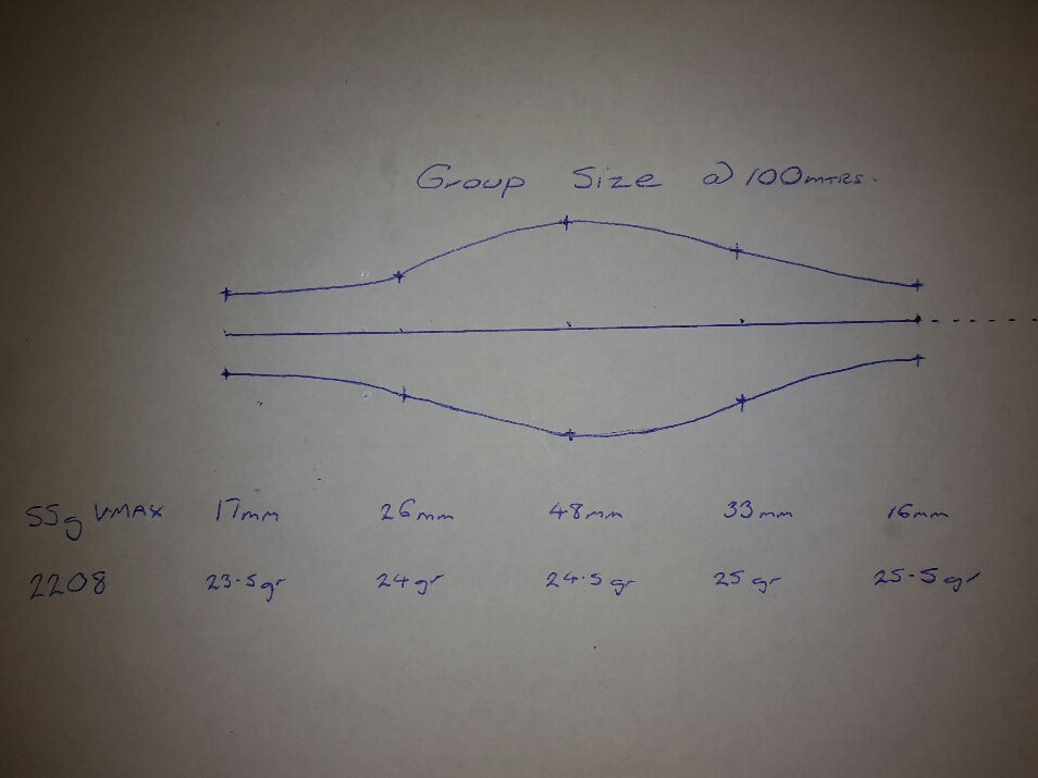

Post by on_one_wheel » 14 May 2016, 2:23 am
Here's today's findings with it's load development.
I recon I'll be pushing it a bit harder next session and work .25 gn incriminates between 25gn and 26gn looks like that's near where I need to be.
Looks interesting mapped out.

Average group size
Size in mm
Powder charge in grains
Fps ???? ( whish I had a chronograph )

Post by Chronos » 15 May 2016, 11:01 am
on_one_wheel wrote:Dose it give you concerns Chronos?
Yes the term linish gave me concerns, to linish means the use of a powered abrasive belt and generally that means heat and large amounts of metal being removed
Posts: 2078
Post by on_one_wheel » 15 May 2016, 4:20 pm
verb (transitive)
to polish and smooth the surface of a material by grinding or sanding
Ok I can see why you'd be concerned. .. all good though I wasn't able to create any sparks linishing by hand, but I was able to create a beautiful finish that looks as if it were finished mechanically.
I have done it exactly the same way on crankshafts before, I love getting a great finish by hand, it's much more satisfying.
