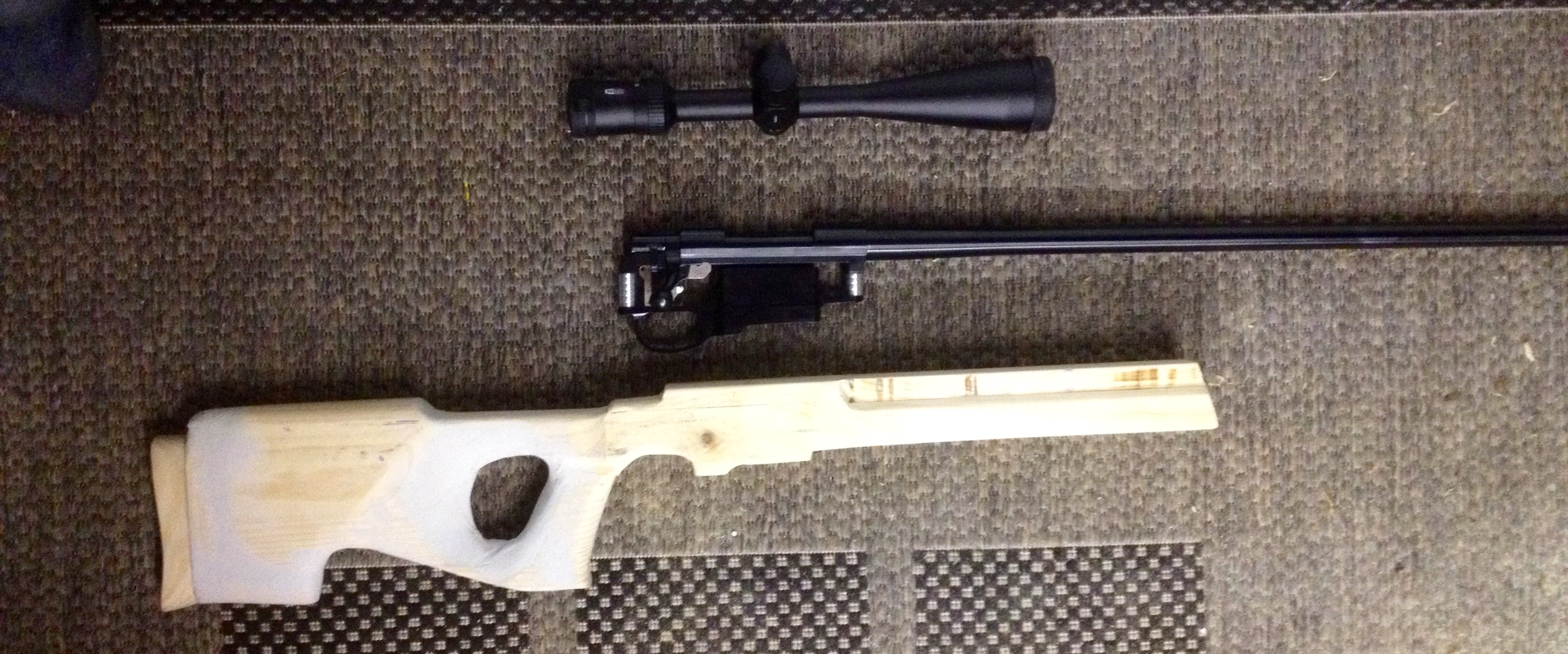

So I had some free time on Sunday , so I travelled down to the old man's place and began stage one of my project build.
I am a novice when it comes to building stocks , but I do know my way around a workshop and consider myself fairly handy with woodwork.
I had a few basic ideas of the rough shape I wanted. I scetched out a few basic designs on the blackboard. I also had an old hogue stock and a modern boyds stock with me to assist in working out basic proportions and measurements.

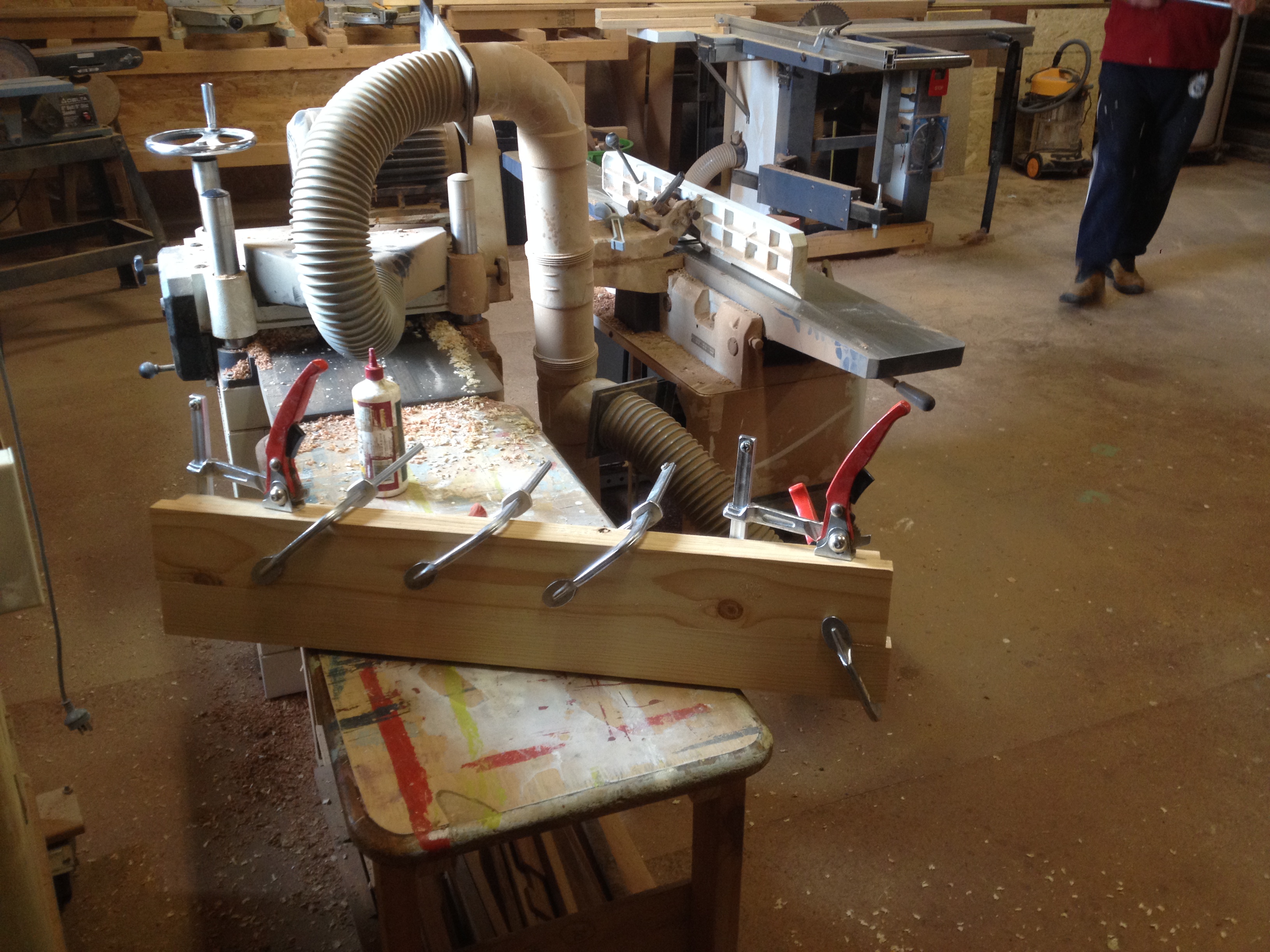

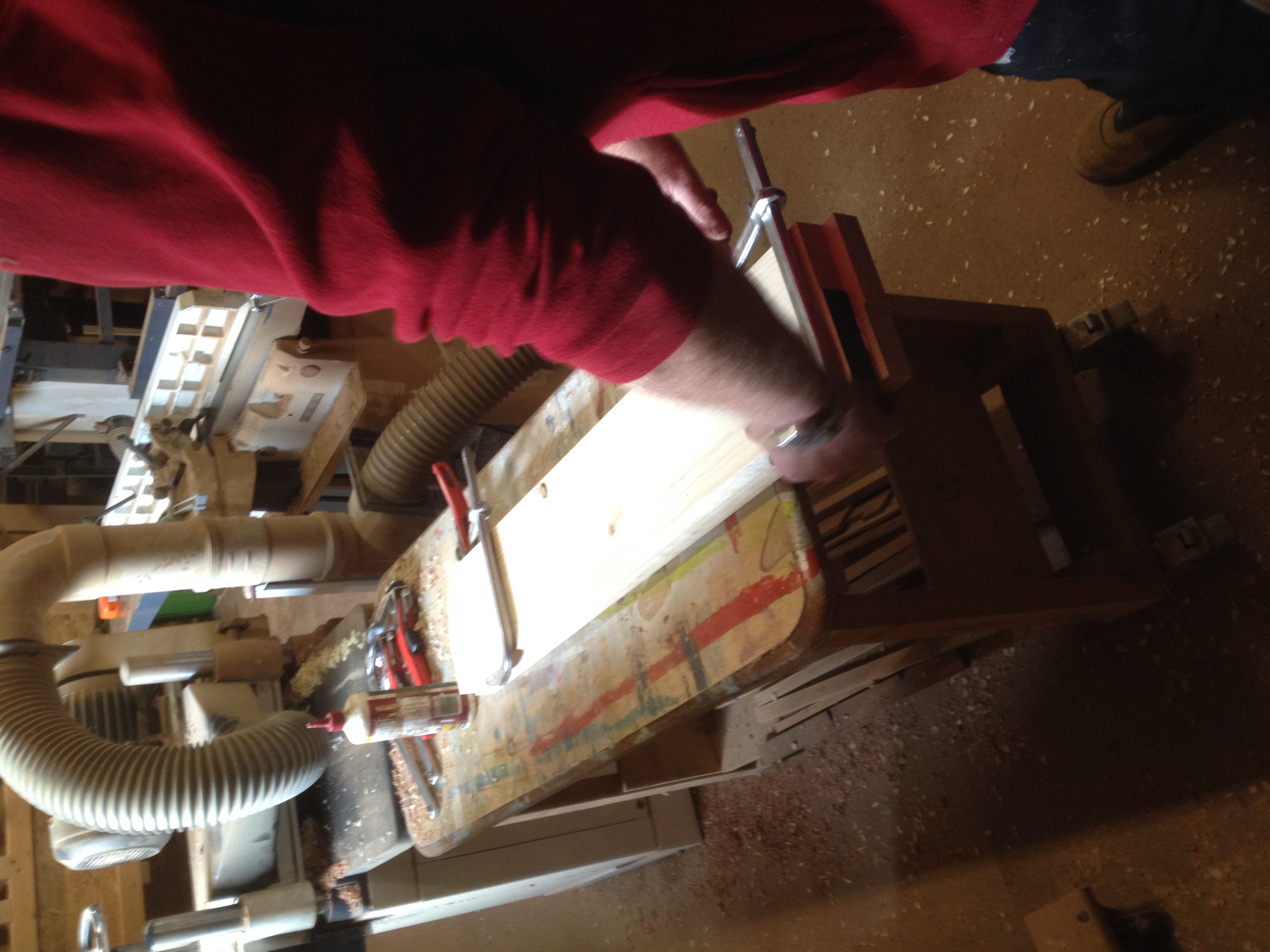

First decision was to knock up a blank out of cheap structural pine. I am using this as a test bed to see what works, what needs improvement and most importantly, what measurements and final shape will need to be achieved.
Supaduke
Posts: 1219
Re: New .308w target rifle build
Post by Supaduke » 23 May 2016, 10:53 am

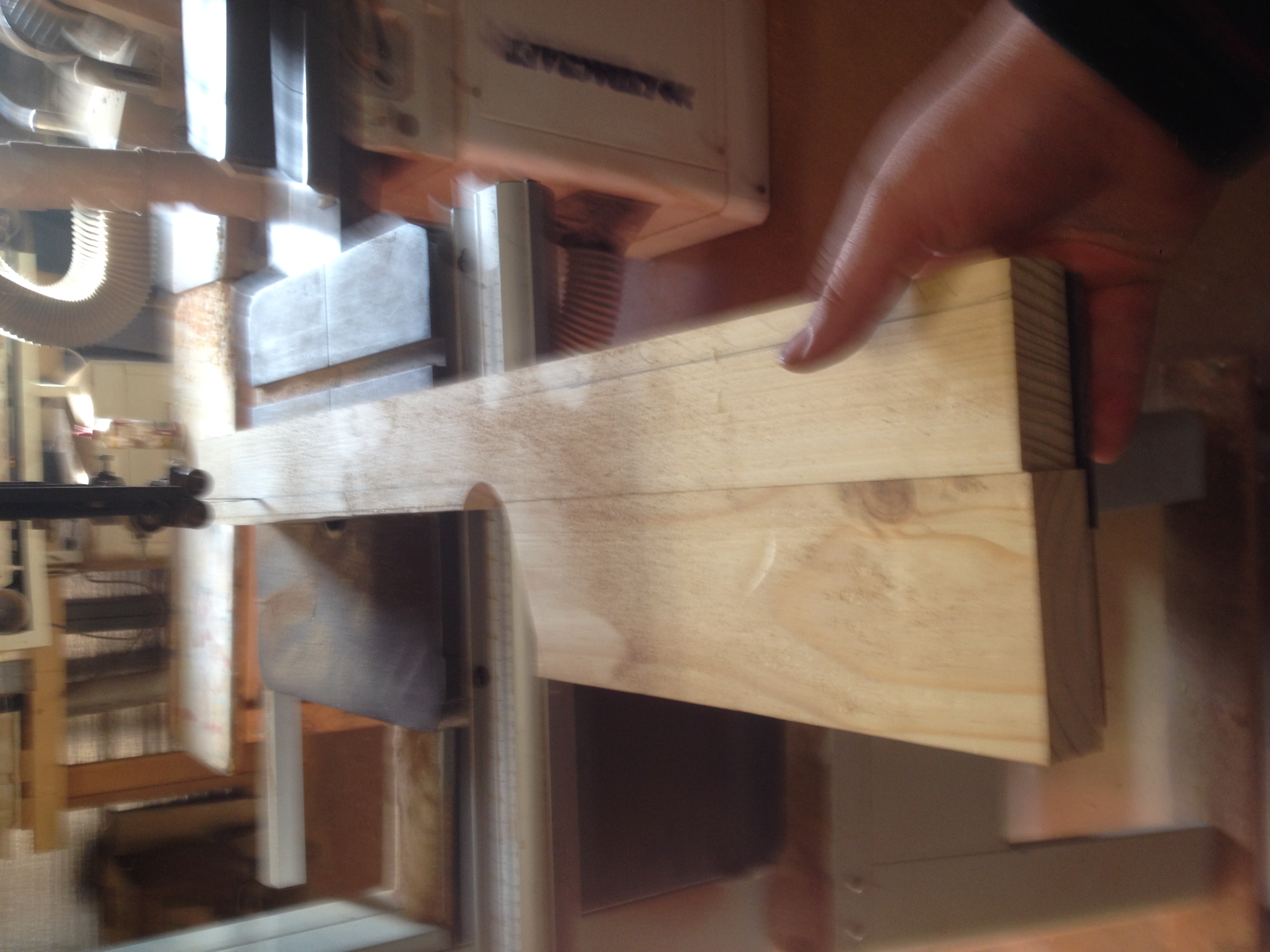

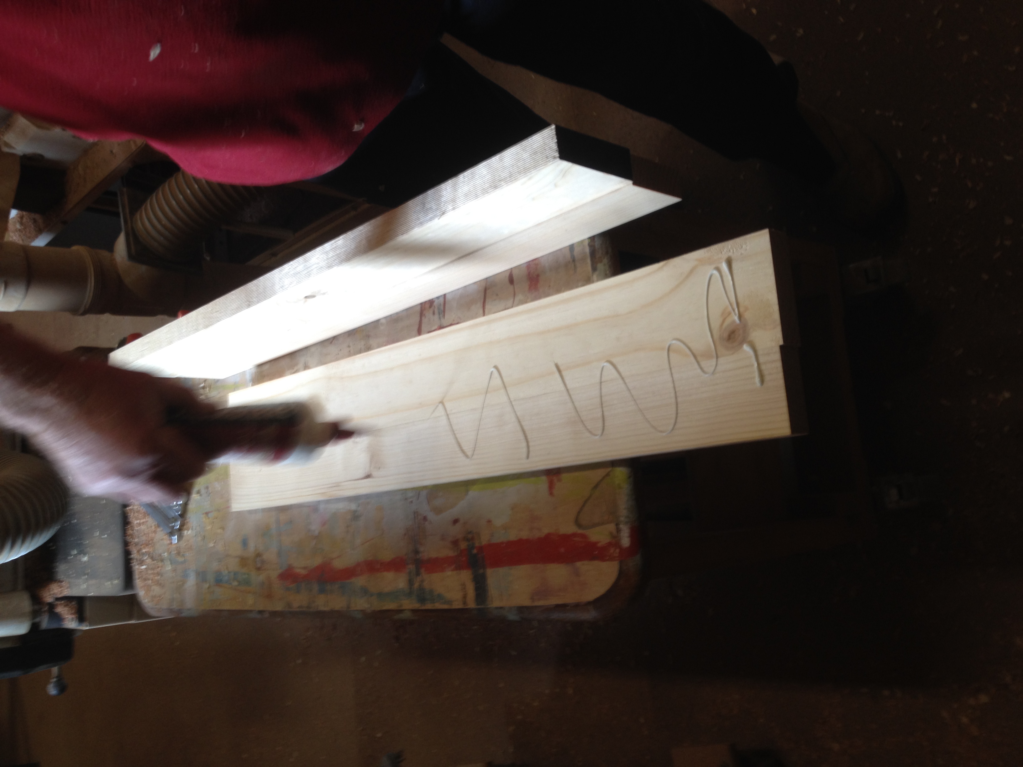

I used four pieces of pine, glued and clamped together. I then squared it up on the bench planer.

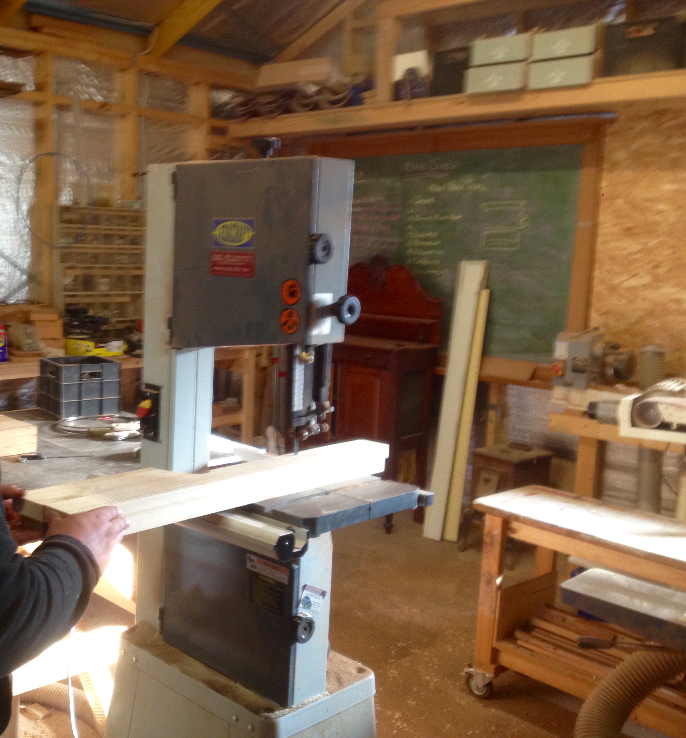

I then drew a basic outline of the stock and popped it on the bandsaw to cut out a basic shape
And we end up with a very basic shape

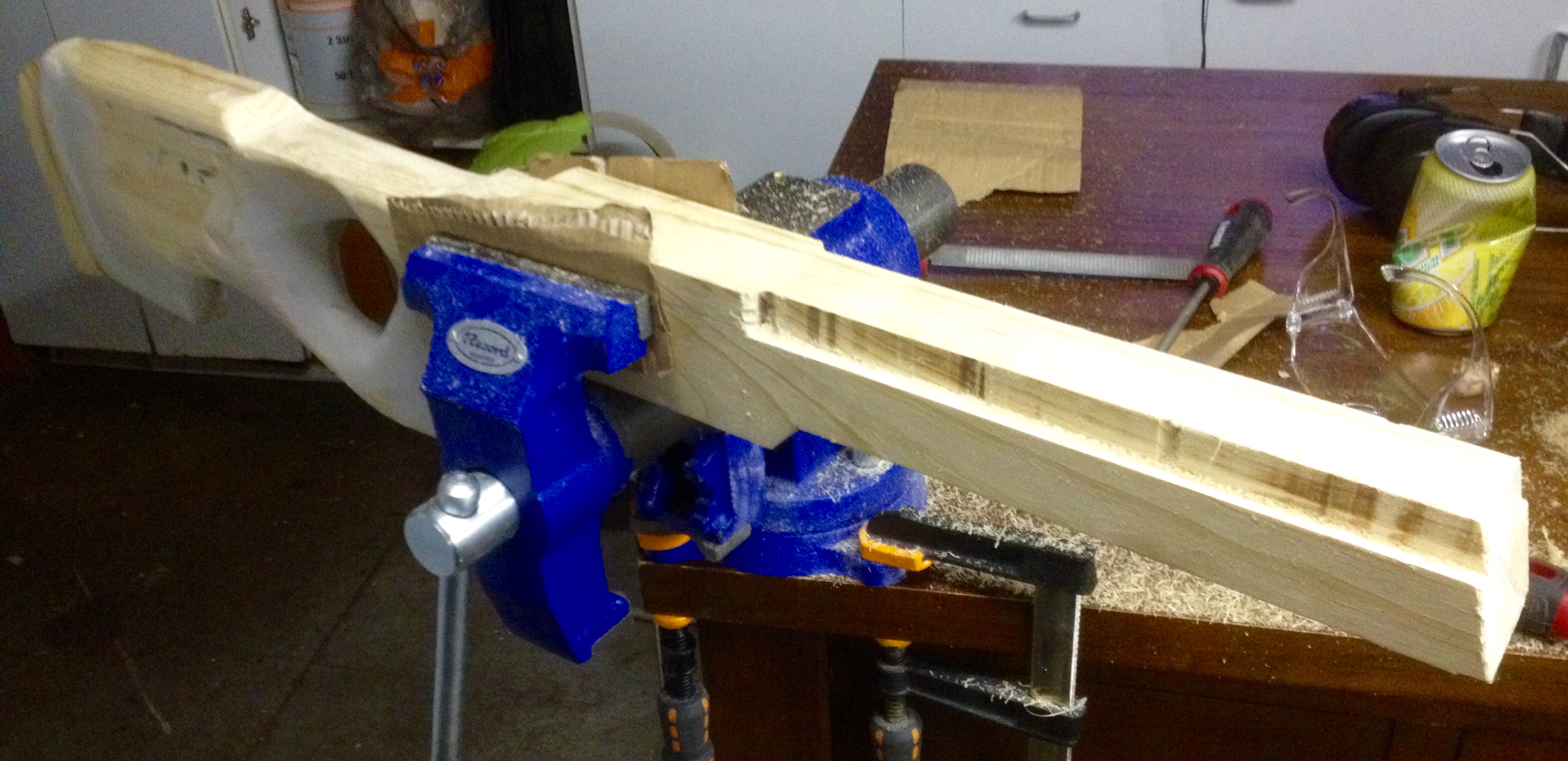

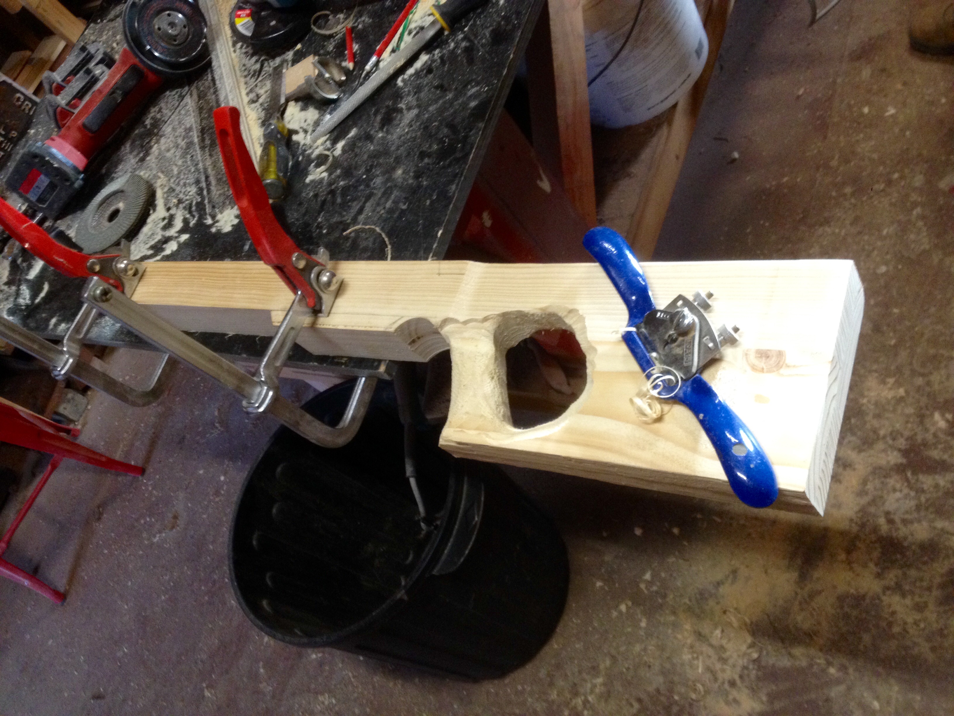

I then drilled some holes to get some corner radius and clearance to start shaping the thumb hole.
Then using a half-round rasp, a spokeshave and a flap wheel on a grinder I started carving out some contours.

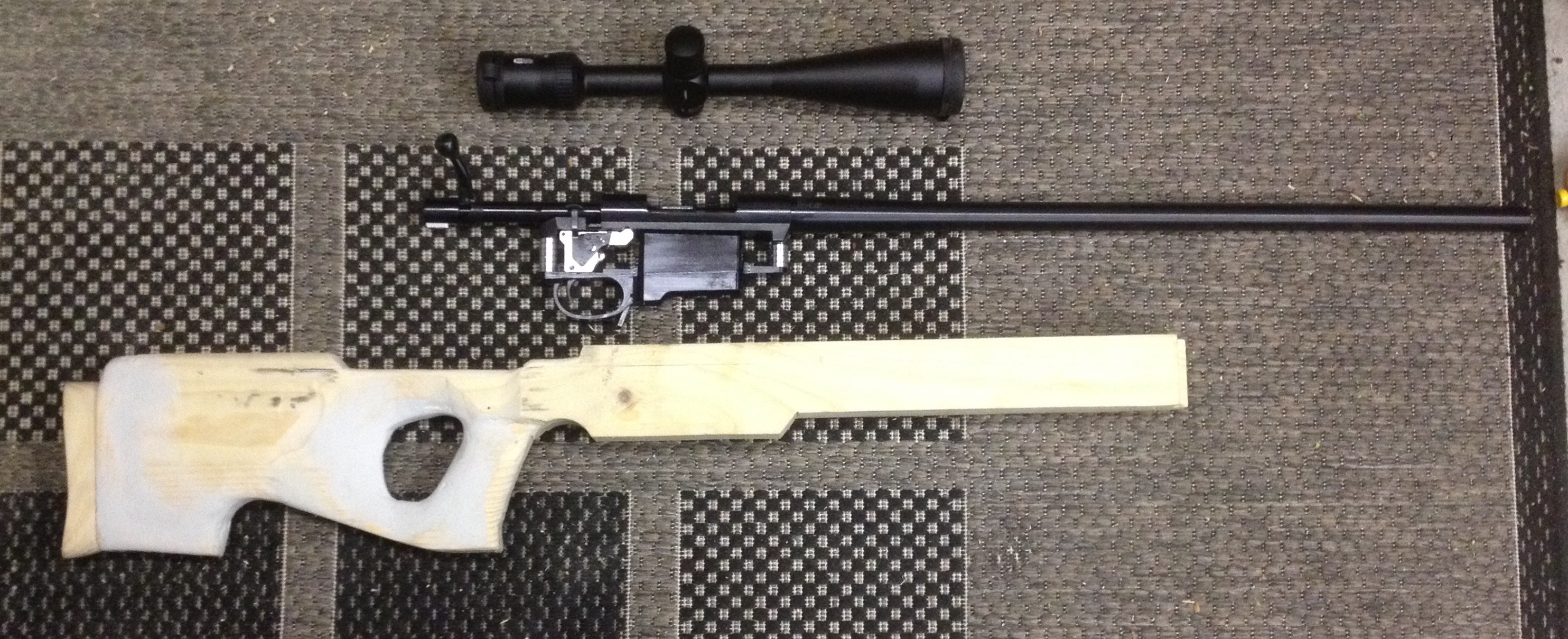

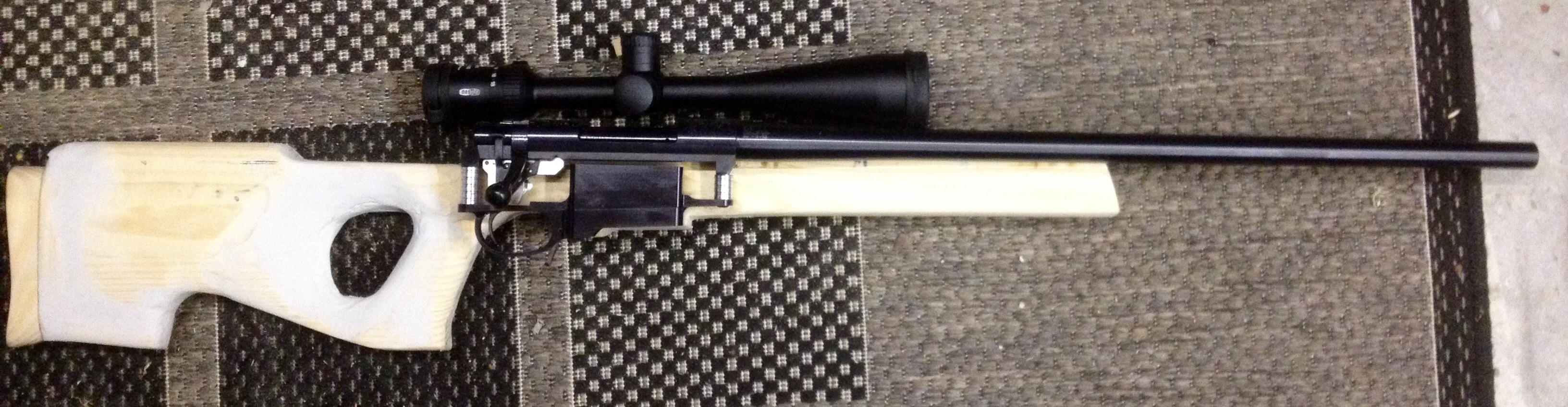

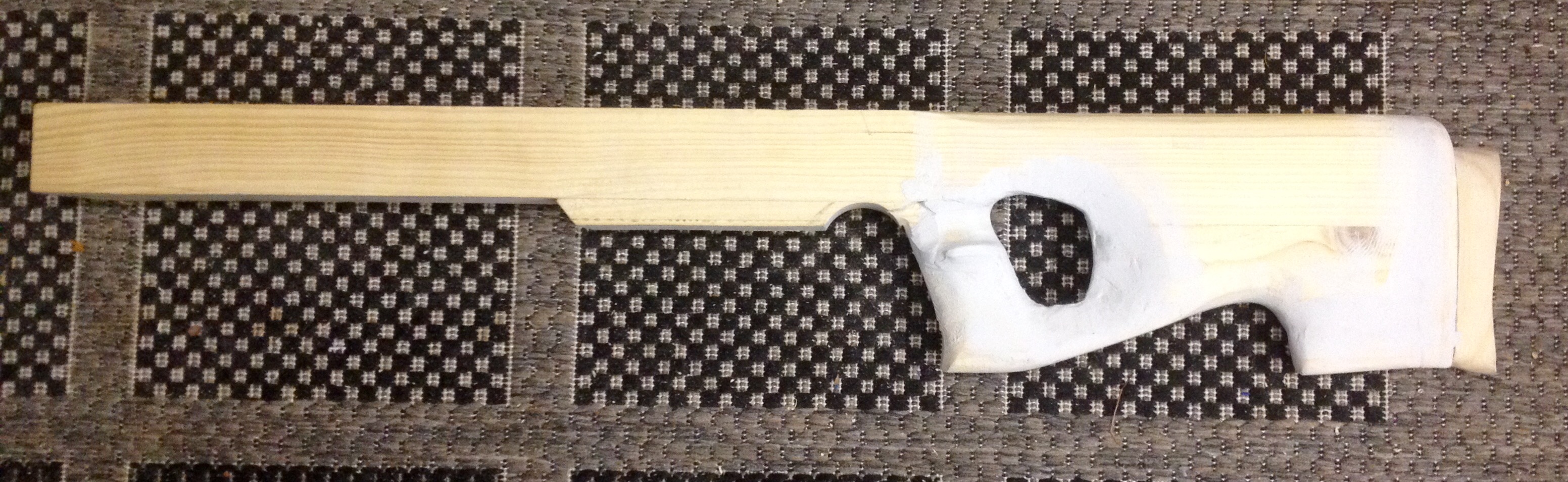

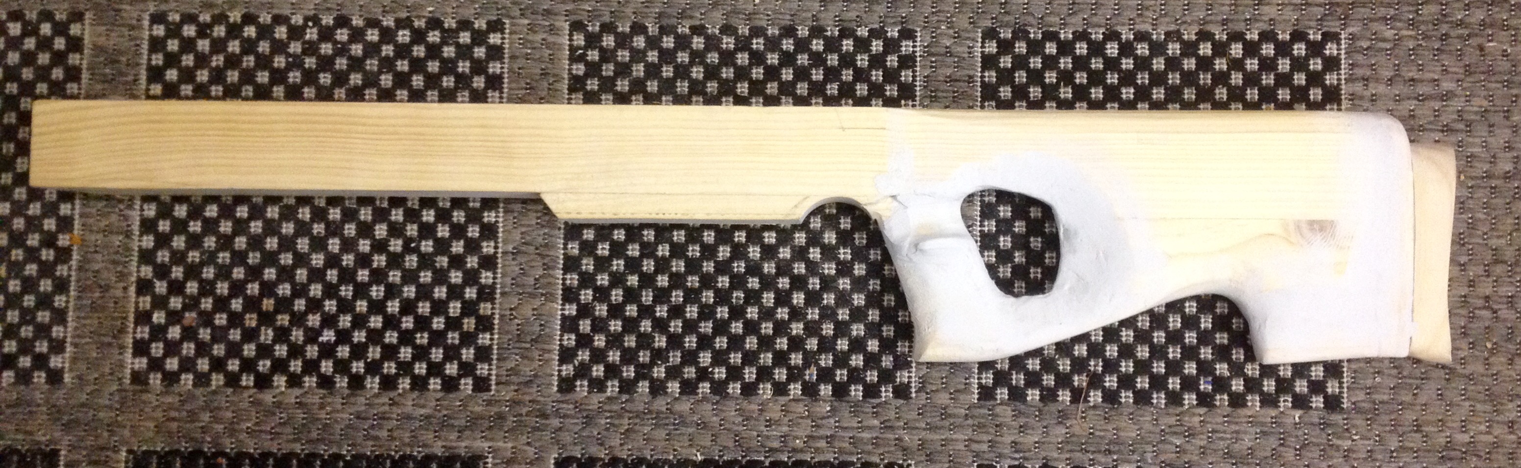

Post by Supaduke » 23 May 2016, 11:34 am
This is where I am at so far.
Already needs some modifications such as another inch or so LOP. The curved brace at the bottom of the pistol grip will be straightened and thicker.
I am working towards an AR style grip shape and a straight line recoil path. Plenty more shaping to go but I am happy with the basic ergonomics so far. Haven't touched the inletting or forend yet. Next step will be more shaping and the addition of some builders bog to help build up detail where needed. Cheek rest height and LOP will be sorted and then just more fine tuning. I will keep you guys posted on progress

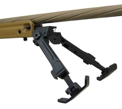

And is anyone able to offer their opinion on spigot style bipod attachments similar to this
In comparison to a traditional sling stud type mounting underneath the forend.
Pros and cons etc

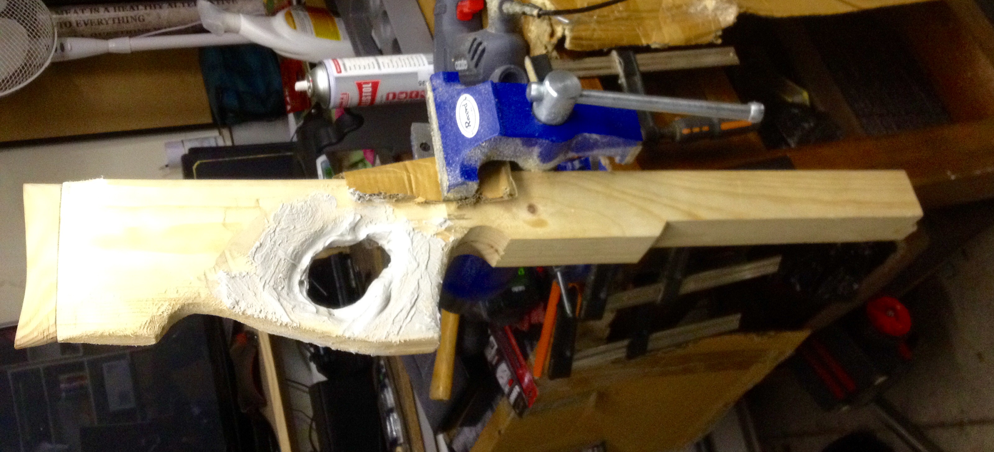

Post by Supaduke » 31 May 2016, 9:43 pm

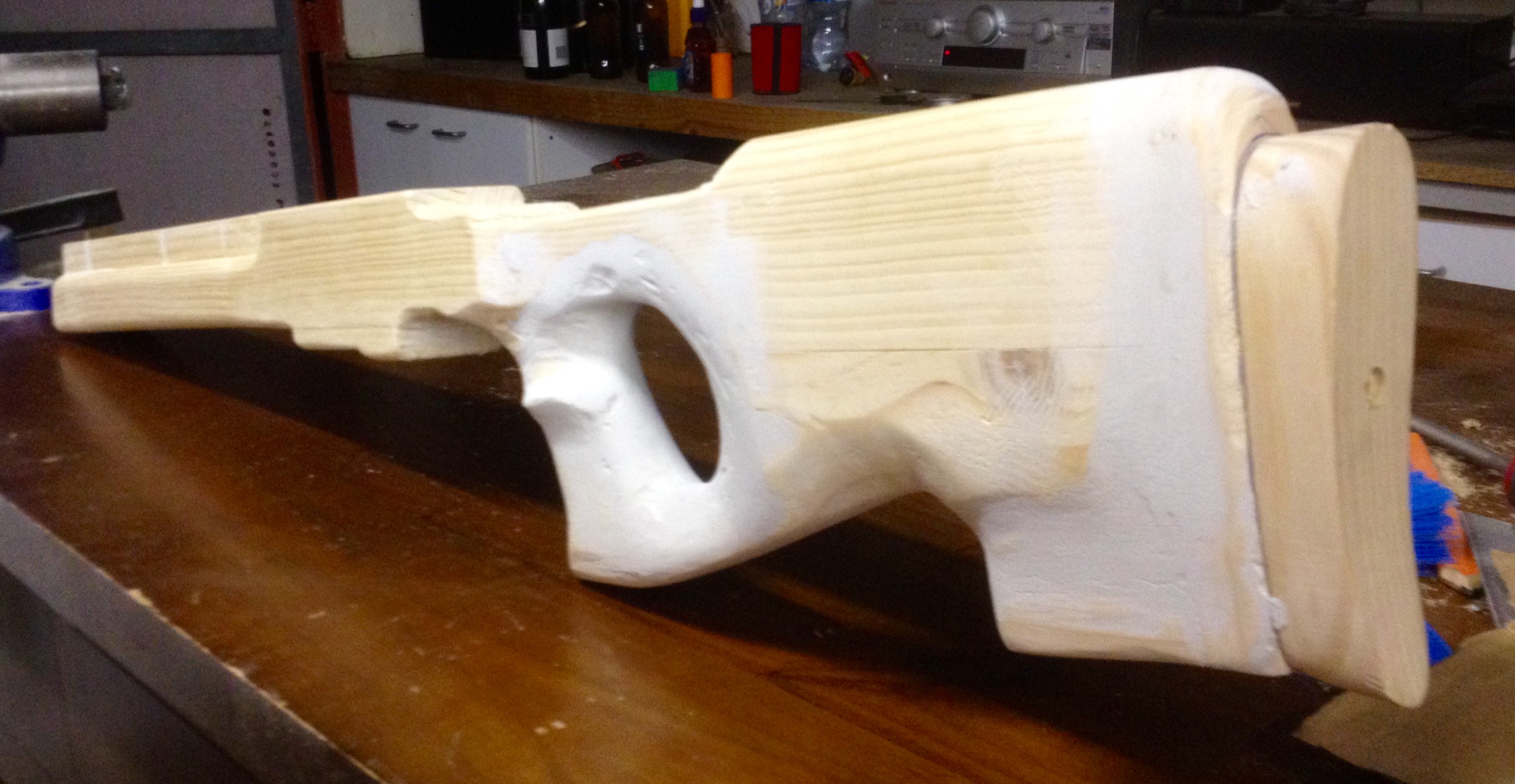

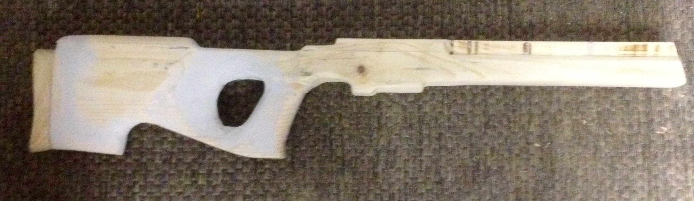

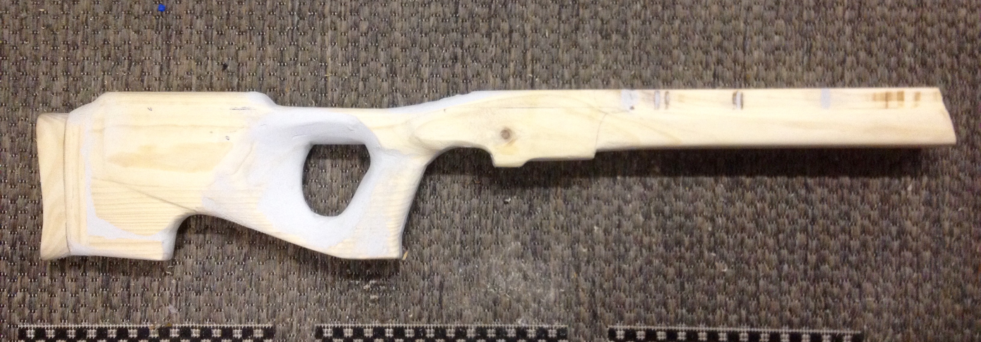

So I had some more free time and progress is slowly continuing on the build. More refining on the stock shaping. I added some builders bog to my initial rough shaping to return a bit of smoothness and allow a little easier shaping
Adjusted the LOP and changed the position of the recoil pad. Straightened a few lines and smoothed out some others. Added a thumb rest and generally adapted the shaping to my body.
Before
After

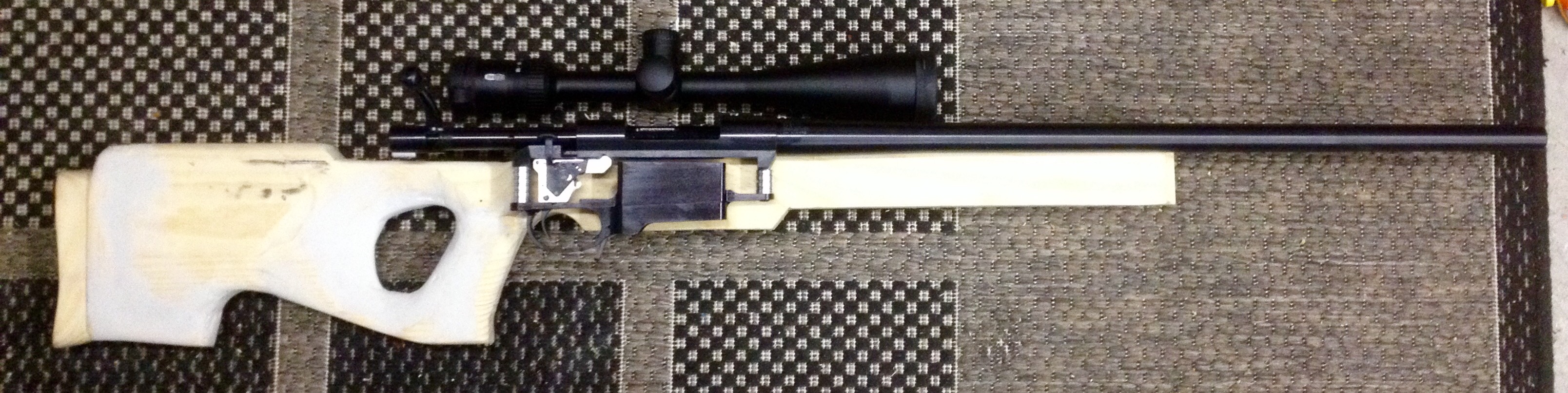

My PTG bottom metal arrived in the mail yesterday and looks quite nice.

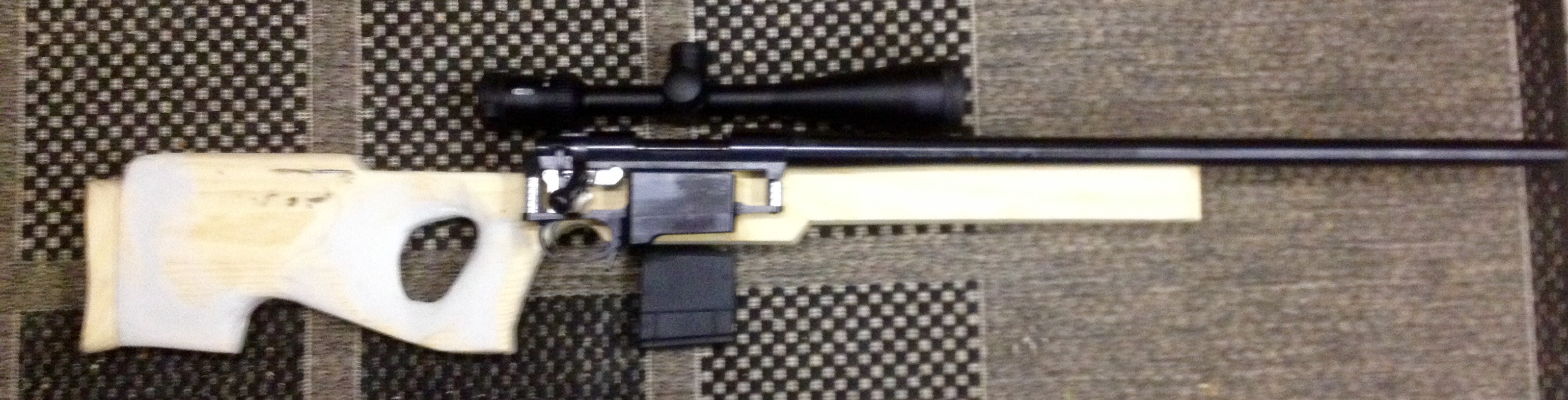

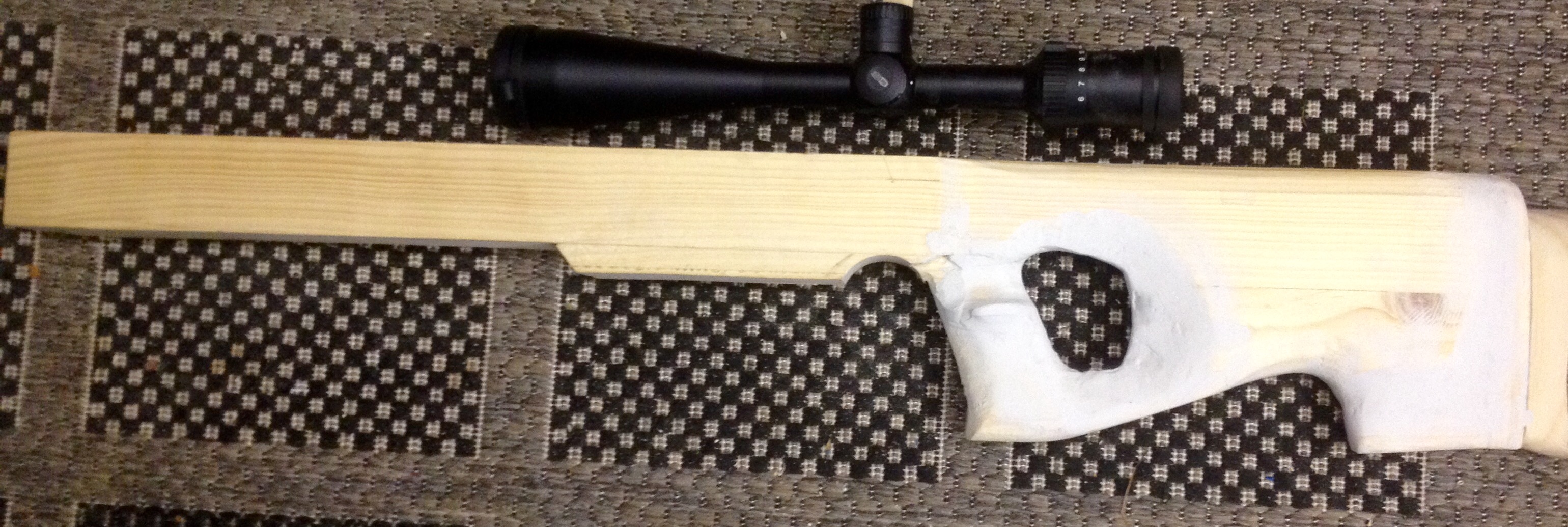

Removed some timber for bolt clearance. Thought I would mock up the barrelled action and scope just to get an idea of proportions. Overall pretty happen with the basic shape and proportions that are coming together. Still yet to start on the forend. The timber will come down flush with the bottom of the mag well. The forend will be thinner and slightly tapered. Free time is in such short supply.
Not an AICS mag but helps me visualise

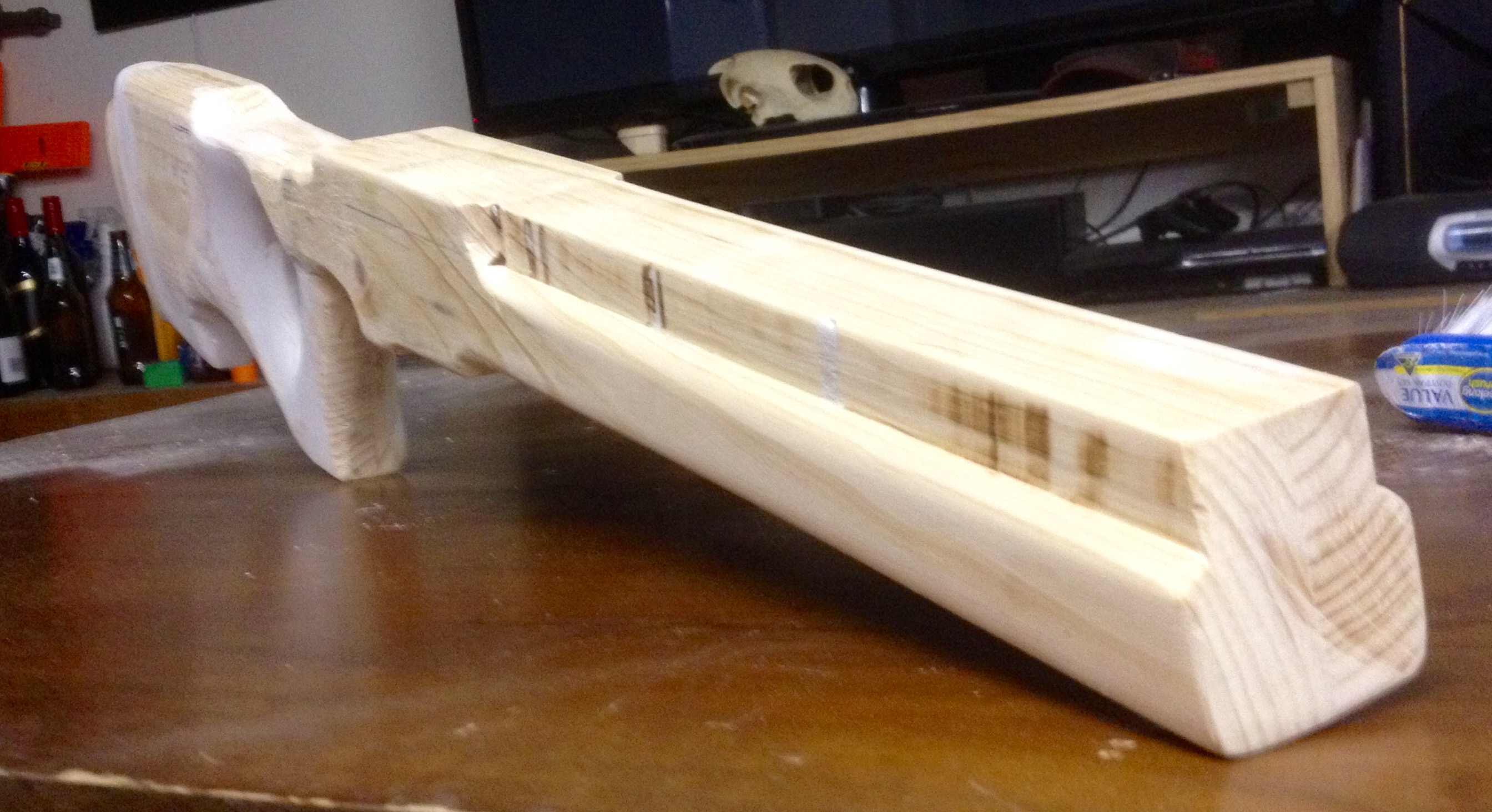

So a bit more free time over the long weekend and a chance to advance the stock building a little further. First go at the forend
Started by using a router to carve a channel along each side of the forend.
Added a little more builders bog and did some further refining of the butt. Started smoothing out some lines. Adjusted the underside to match the bottom metal profile. Still plenty of shaping and smoothing to go but it's getting there slowly.
Next step will be creating an even flow in the lines of the stock, blending and smoothing it all out.
Getting there slowly but surely. Pretty happy with the overall shape and proportions. The finesse stages, making it all flow together and be pleasing to the eye are next . A lot more sanding and shaping to be done.

Post by Supaduke » 22 Jun 2016, 6:58 pm
A little more progress. Working on smoothing the lines and getting a bit of flow. Also have a 10 round magazine on order. It's getting there slowly, I only really had a basic idea of what I wanted. The design and shaping has been quite organic. Rasping and sanding, rebuilding with bog when I'm not quite satisfied, it's a slow process when the design is all in your head. Anyway here is where I'm at....

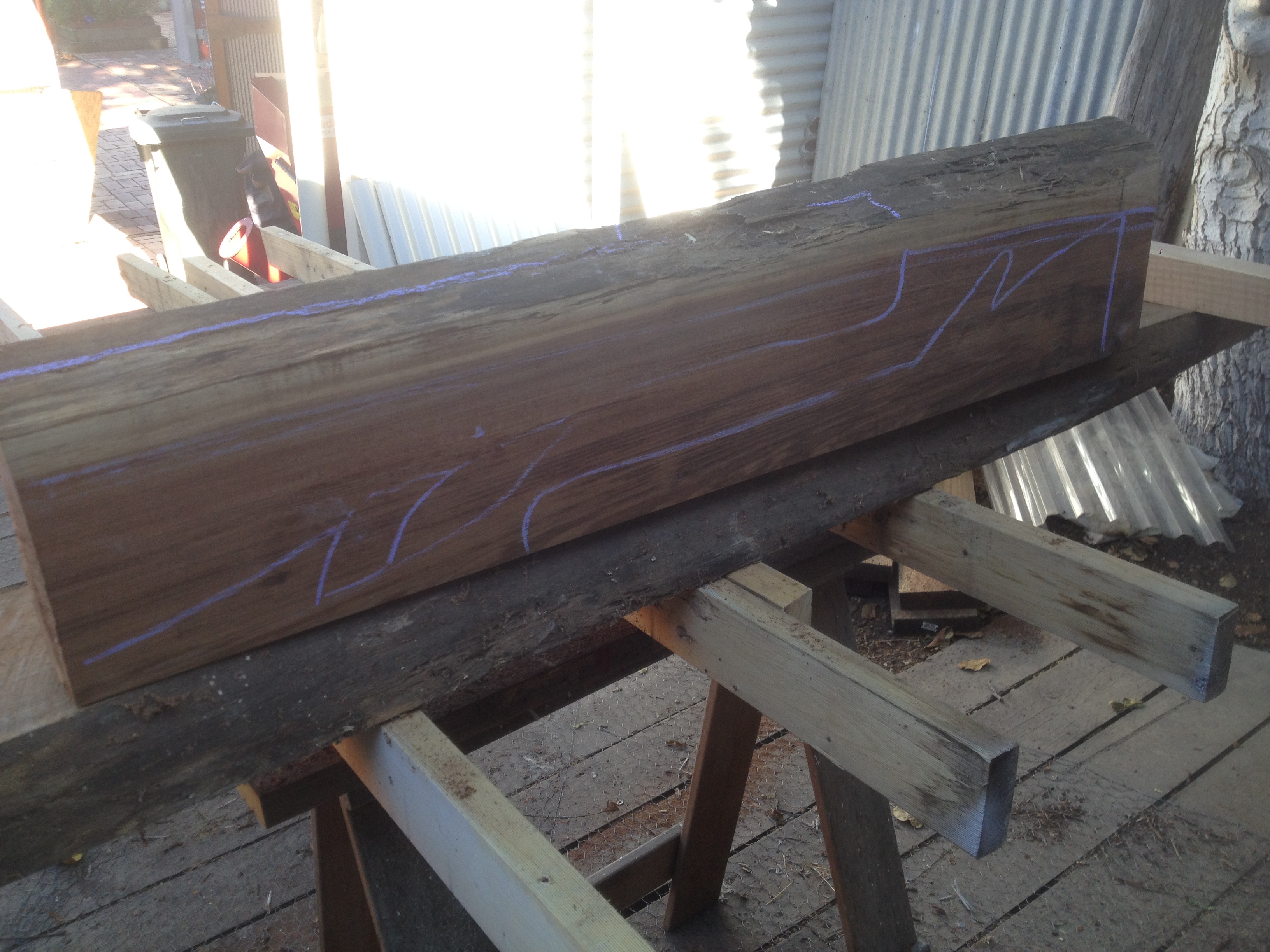

Cheers fellas!! My next step will be to fit a wooden barrel that sits at exactly the same height as the howa action, I will then make some timber scope mounts to sit the scope on and fine tune the stock and mount height so I get good eye alignment. Next step after that will be a second blank once the first is completed. The second one will be cut to precise measurements and won't have any bog. The first blank has all been done by eye and there are little bits that are not completely squared up or true. Only get one go at cutting the Blackwood so I want to be absolutely sure of the shape and measurements. Pine blanks cost me less than $10

Post by Supaduke » 25 Jun 2016, 4:40 pm
Bit more shaping around the trigger guard recess and around the butt. Also installed a sling stud on the forend and popped a Harris 6-9 notched bipod in to see how it sits. Popped it onto the bench in a shooting position and it shoulders beautifully. Working on the lines more and more, getting some nice symmetry and flow. Next step is fitting the wooden barrel.

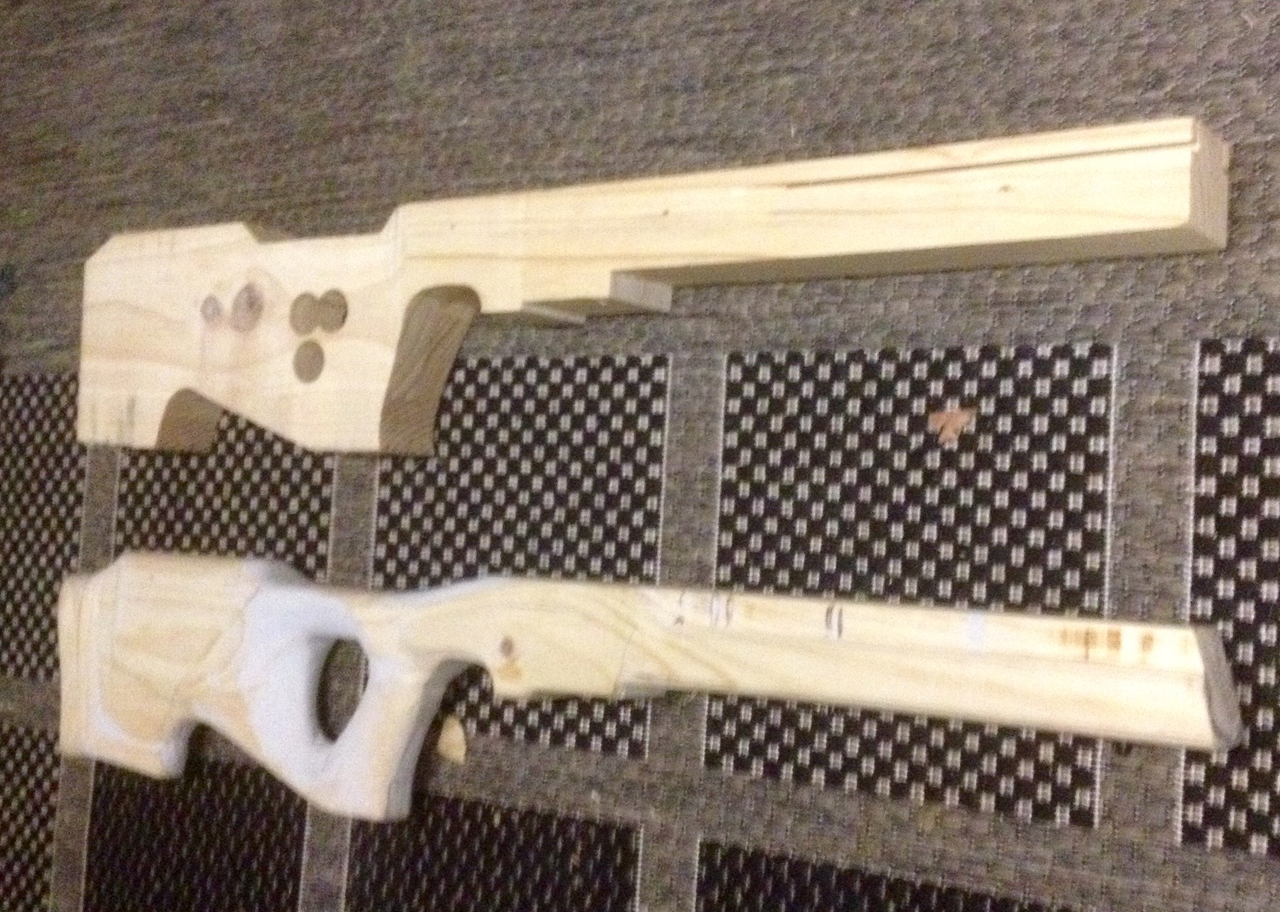

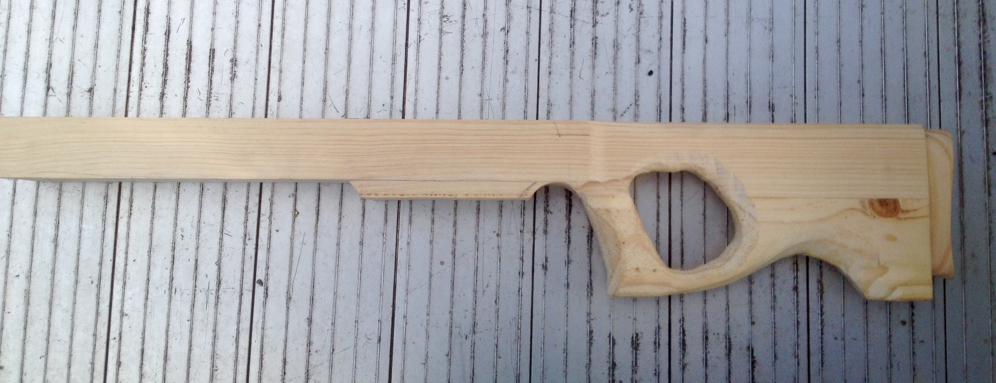

Post by Supaduke » 31 Jul 2016, 10:53 pm
Finally some more free time. Been a bit of a struggle lately getting any.

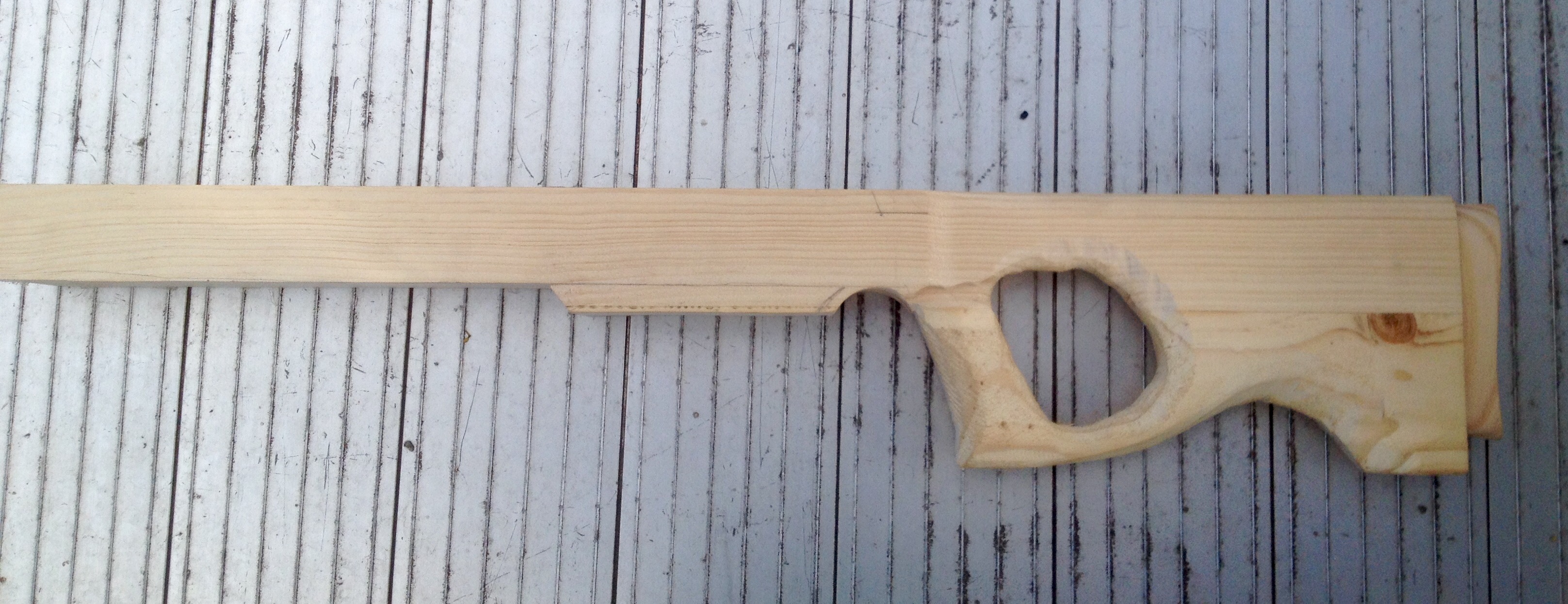

Ventured down to Ballarat to visit the old man and make use of the shed. Put together a new pine blank and went to work making version 2.0 of my rifle stock.
Having a pattern to work off made things much quicker this time round. A lot more simple measure and cut rather than painstaking shaping and sanding. Everything measured and square.
So far have done all the basic shaping with a bandsaw, table saw and drill press. The refinements and ideas from stock mk1 have been incorporated and all the main cuts have been made. The idea for this one is to fully inlet the stock and use no bog at all.

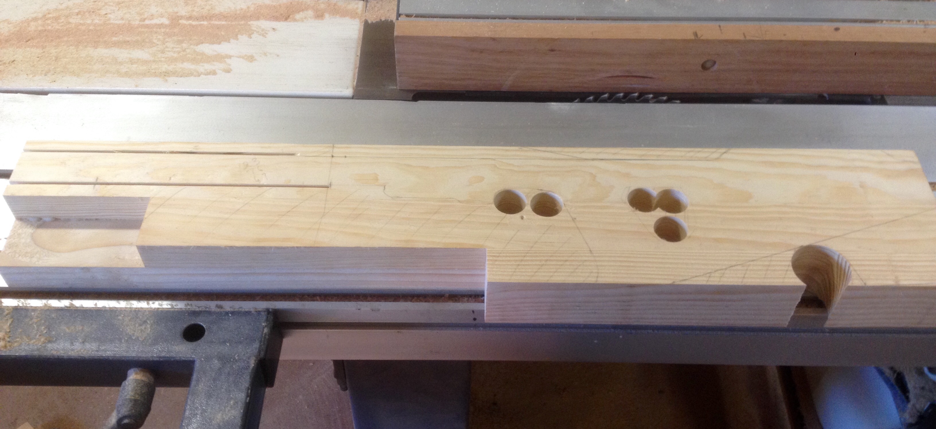

Radius cuts and outlay
Mk1 and Mk2
mk1 and mk2
