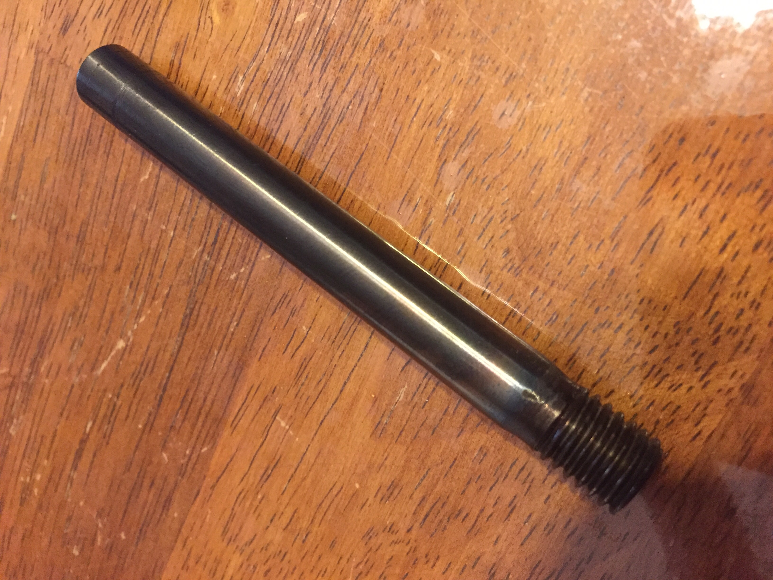

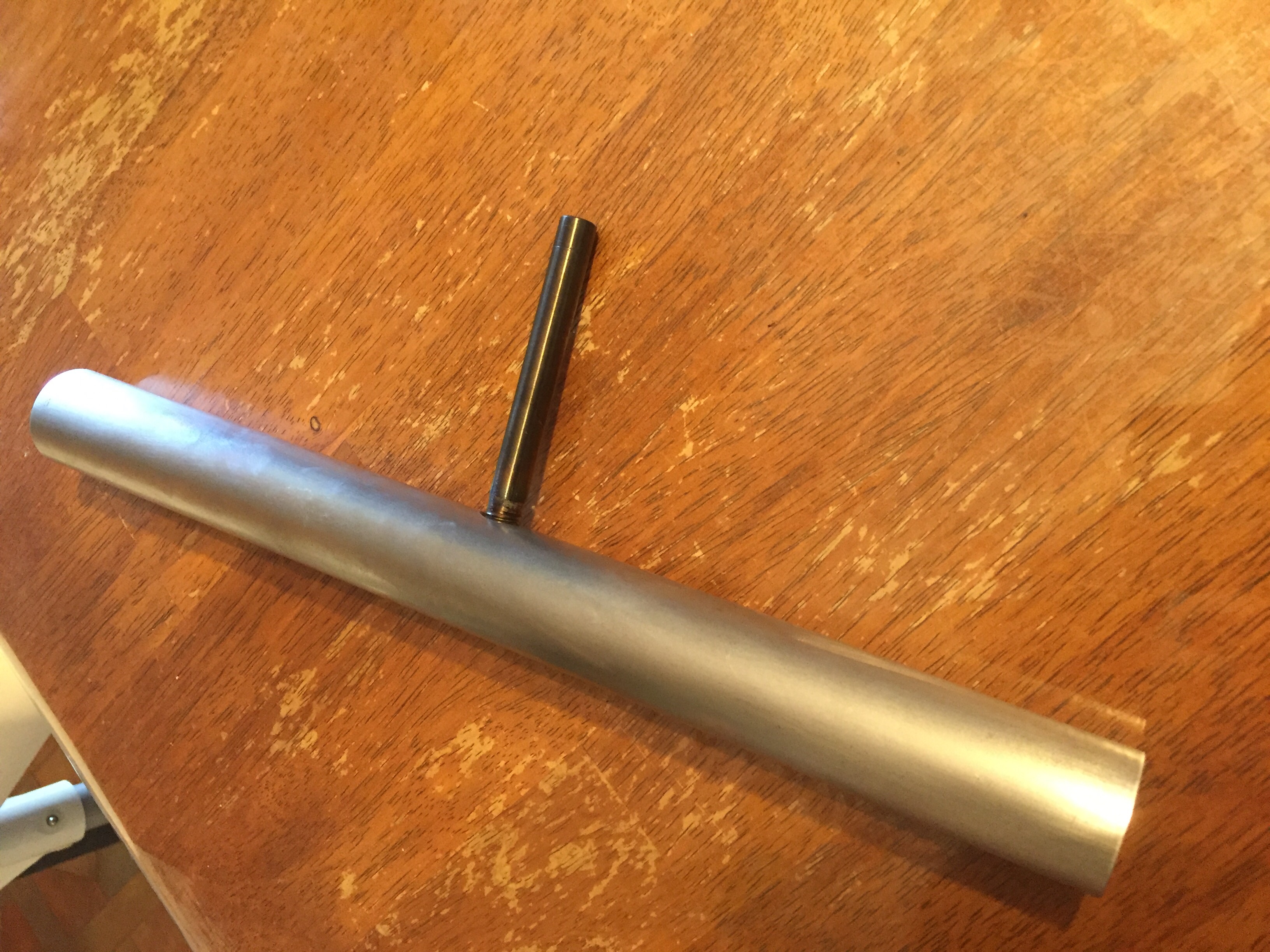

Post by MalleeFarmer » 25 Jun 2016, 9:58 am

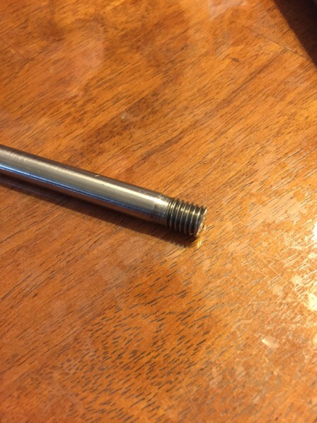

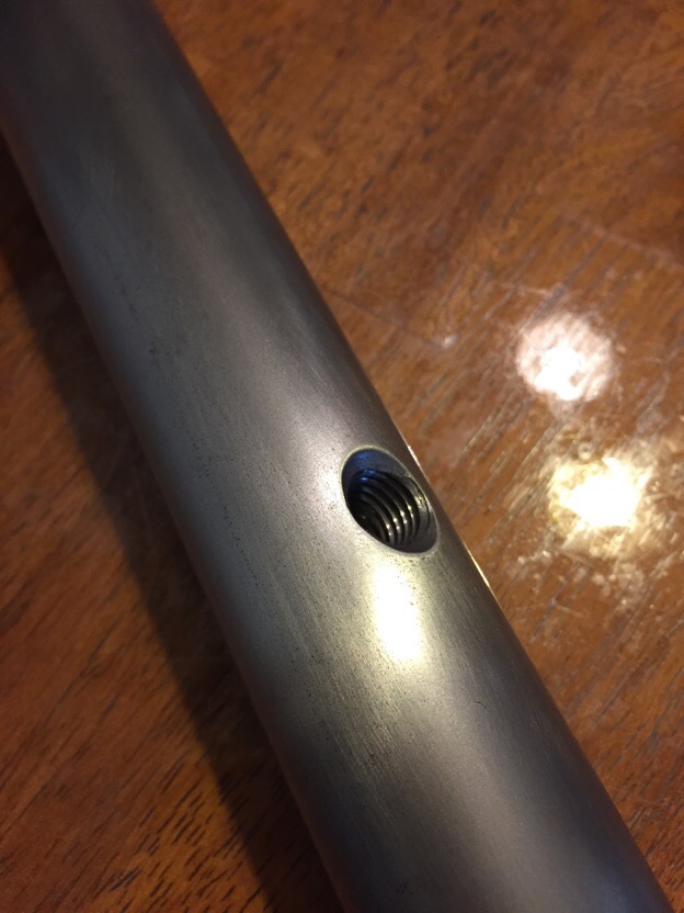

So I've never lapped scope rings before. So I made a lapping bar out of a piece of 30mm shaft. I think it will cost me around $15 (haven't got the account from the steel shop). I used 400grit emery paper to clean it up. And then I drilled a 3/8 hole and threaded it 16NC and cut a rusty bolt off and polished it up cut off the head and shortened the thread and used a drill press as a lathe to get the top cut straight and then filed it smooth and the edges off while in the press to make the handle. I have checked the shaft in a scope ring and it's a perfect 30mm fit.
1. Make Sure You Use 30mm SHAFT not just 30mm bar or rod. Shaft is made to a higher tensile and level of precision than just bar or rod.
2. Drill a pilot hole and then drill out to desired size. Also I used a 1/2 drill bit. To de burr the top of the threaded hole. And then filed the burrs off of that. And then sanded the whole bar to a nice finish.

Also I am interested in Linseed Oil Bluing so I decided I'd just heat the handle up in a gas torch and dunk it in pale boiled linseed oil then I repeated 3 times and got quite a good dark blue I think It could do a very good job if you were willing to repeat 5-6 times.
