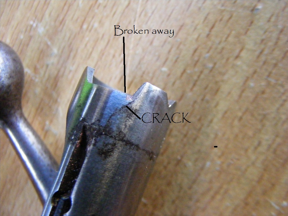

Post by SamHuntVic » 23 Aug 2016, 2:51 pm
Thanks for that detailed info Keg, most enlightening.
The situation is resolved.
The bolt had a crack in it and a piece has broken off during the reassembly. I can't see how this fault (crack) could possibly affect the striking ability of the FP but it is no longer an issue.
At first I thought that I had broken the thing myself but not the case. Normal pressure by hand was used to reassemble. The crack is shown in the pic.
So now old mate is looking for a bolt or old rifle complete to salvage a bolt as the original rifle is/was a top shooter.
1400 bolt crack.jpg (256 KiB) Viewed 4787 times
The pink stuff is not rust it's soap powder come off some steel wool, the discolouration is from years of neglect and was much worse before a steel wool polish.
Grant

Post by bladeracer » 23 Aug 2016, 3:23 pm
Bugger :-(
On the side where the crack runs out to the edge it looks to me like new metal, indicating both the crack and the missing piece let go at the same time. If it were a long-lasting crack the metal inside the crack should be oxidised. First thing you look for in an engine failure is did it let go all at once or are there discoloured cracks indicating a failure building up over time.
I'm not familiar with the action so I can't guess what might've caused the crack, but I'd prefer to know before putting another bolt in and having it do the same.
