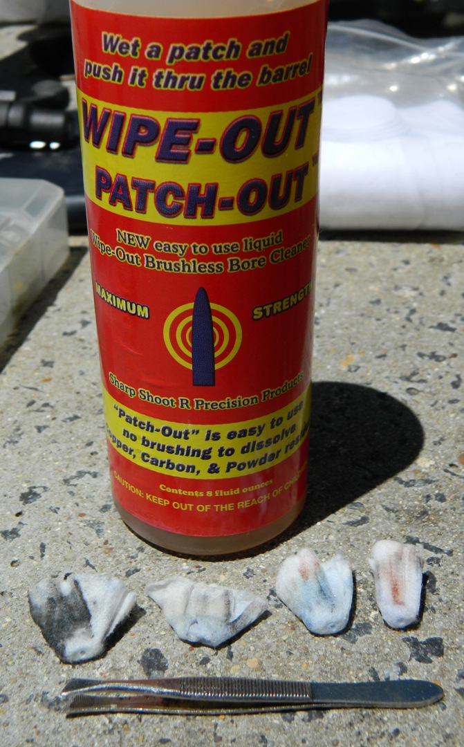

Without question the best bore cleaner on the market is Wipeout Bore cleaning foam. That's if you can get it. I just ordered a can from the US but it cost $80 landed here. .Go on the net to see what users think of it. I used it years ago and it is fantastic but generally not available in Oz.

Colin Bentley, I'm of the same opinion as you on this Wipe-Out, Patch-Out liquid version of this same bore solvent.
I'm so happy with it, this is the only bore solvent I use these days (I'm on my third bottle)!
If it helps, I get mine from http://www.sinclairintl.com
