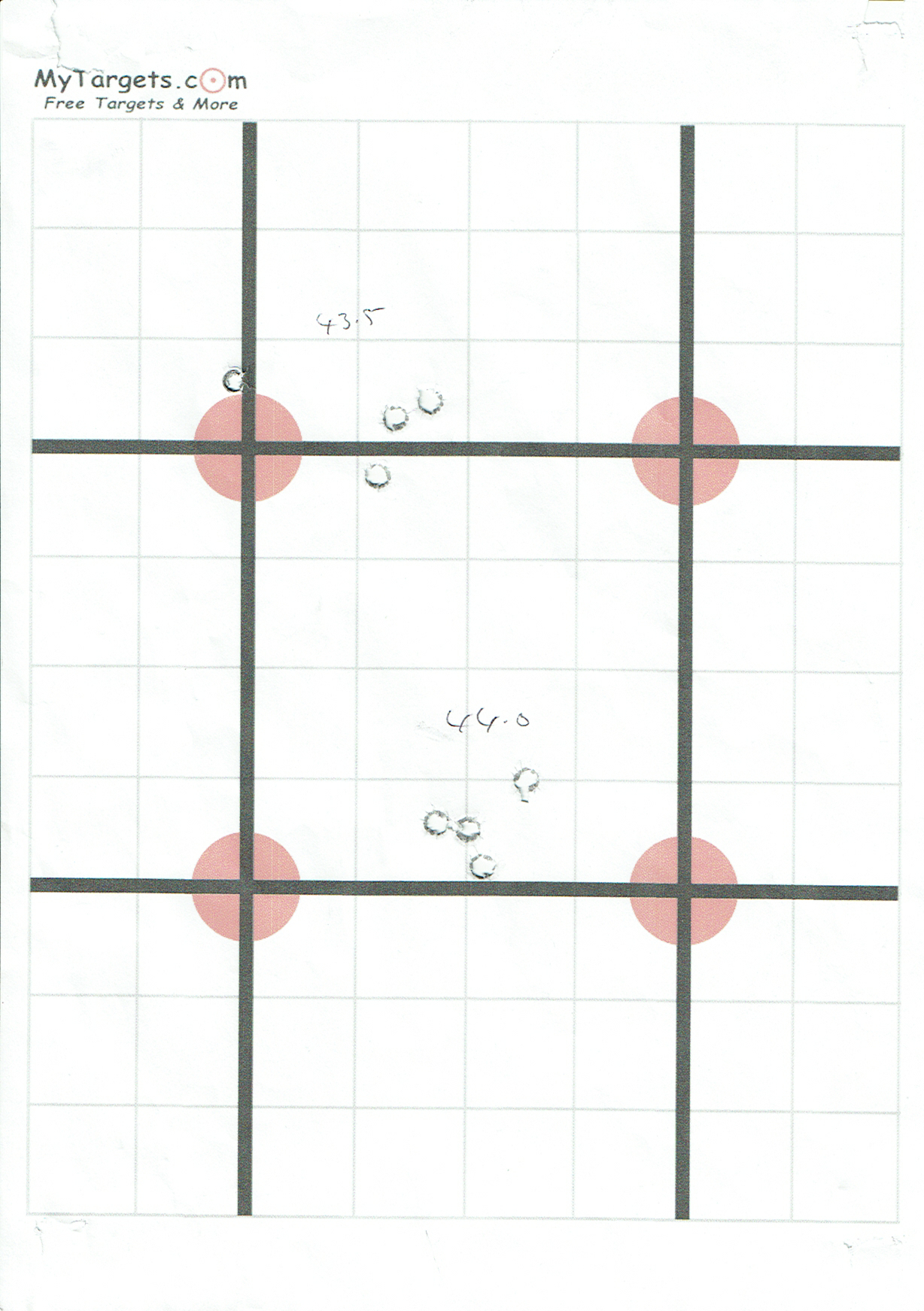

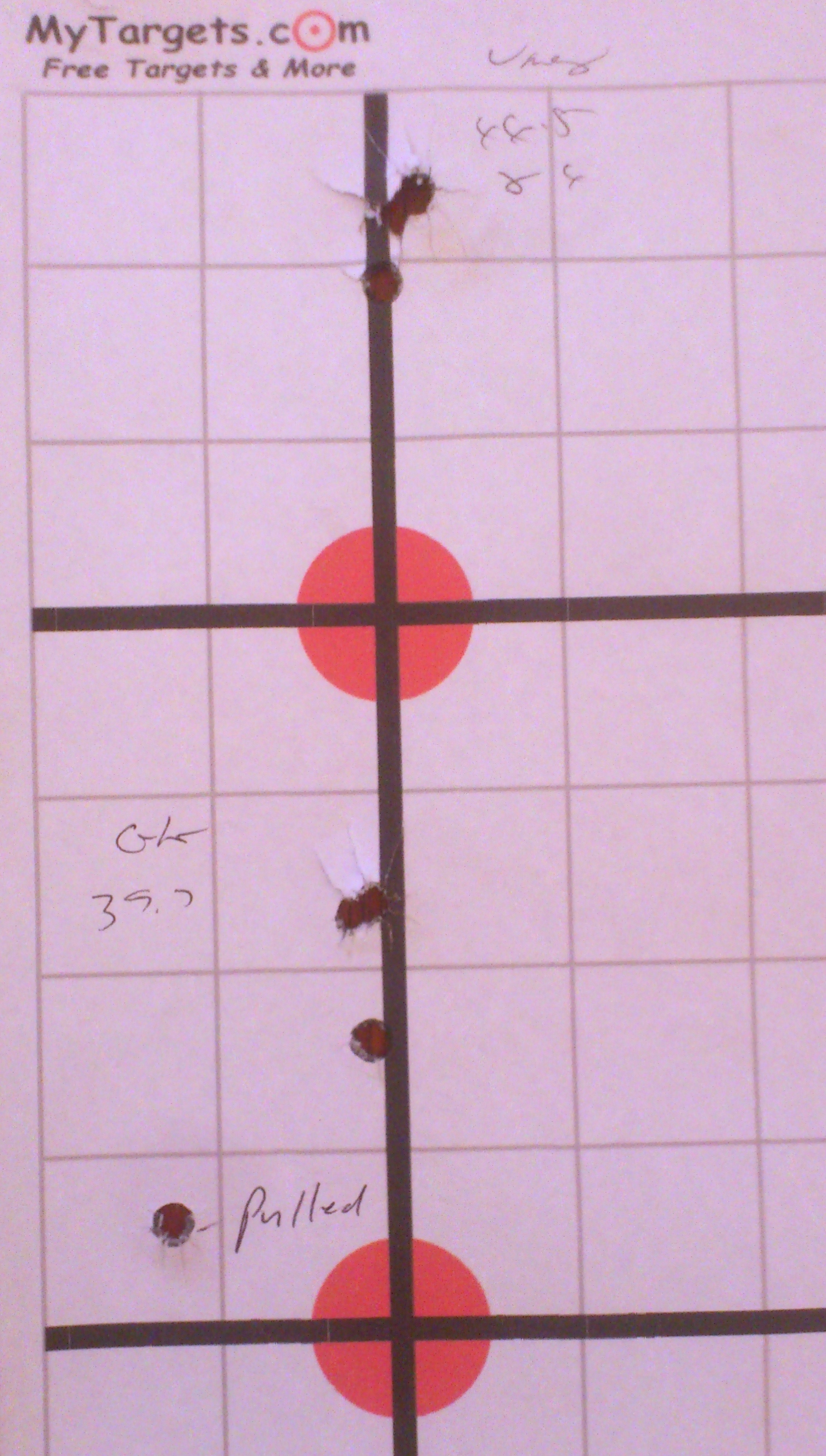

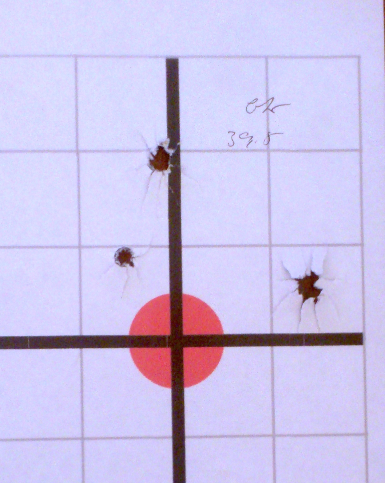

This thread pretty much highlights the issues I'm having, but it's essentially a random flier, always to the top left of the group as in the image below: viewtopic.php?f=3&t=7221&p=113246#p113246

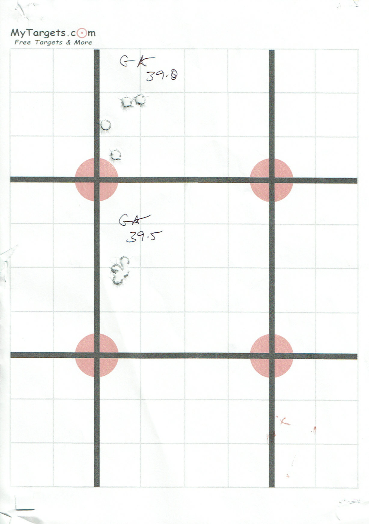

This was a 5-shot group at 200m, but I have lots or similar groups, always with that top left flier, or a double group top-left/bottom right. I'm fairly confident it's a bedding issue.

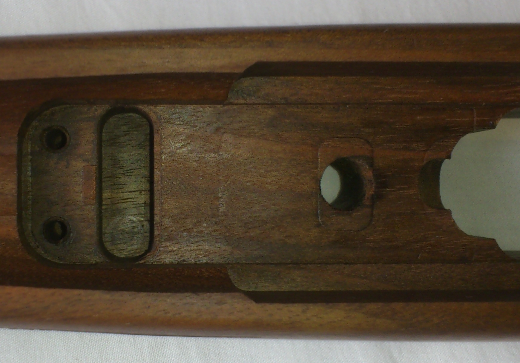

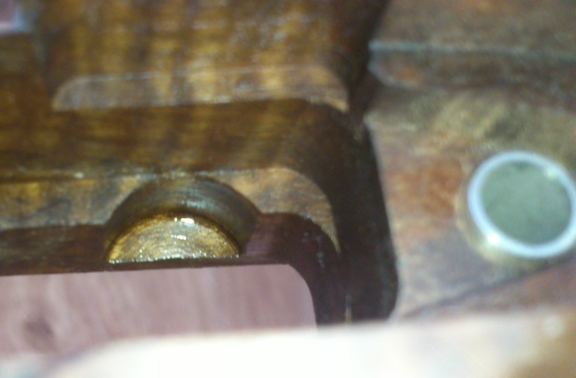

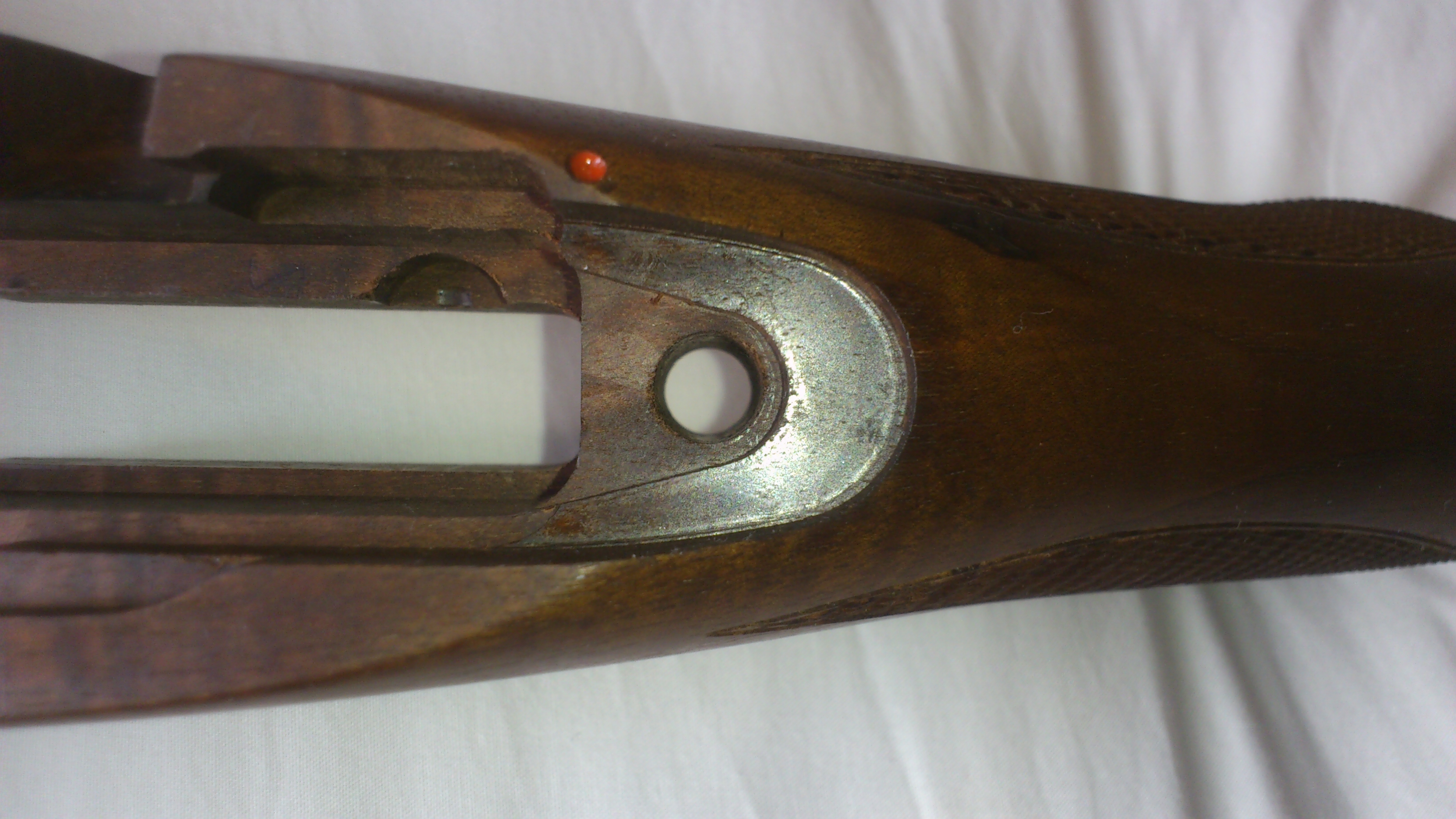

This is what I've found:

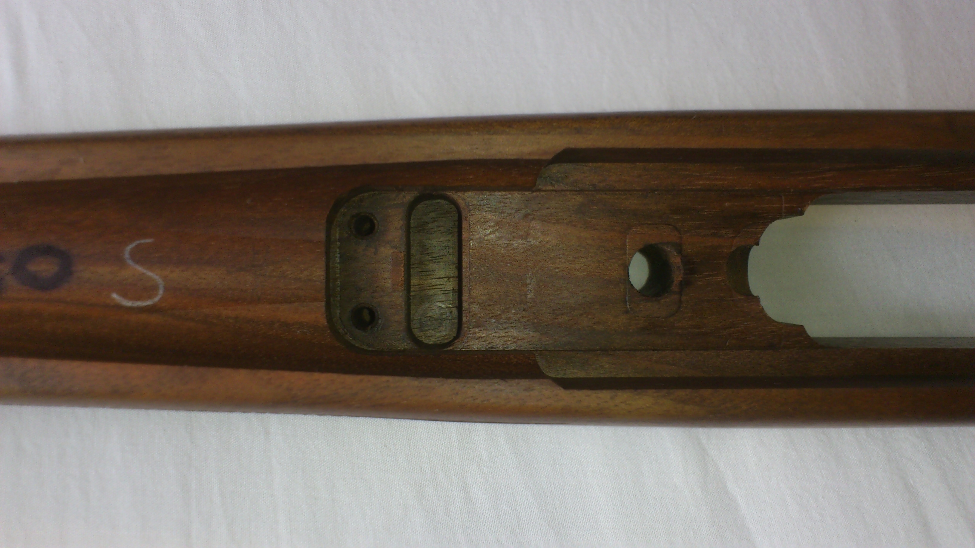

Though hard to see here, the rear action screw hole is not centred - it is about .030" off to the right (towards the top in this photo). Note the action screw housing marks (semi-circles behind the screw hole) in the wood showing the action has been jumping around.
There are marks on the right-hand side of the inner stock (on the left in this photo) where you can see the action screw housing has been hitting/bouncing off the wood. You can also see where the action screw has been rubbing on the same side. Note the two light rub marks to the left of the screw hole in this pic.
What I believe is happening is the rifle is recoiling into the right side of the wood - throwing a flier to the left - and then bouncing the action back into the middle of the stock where it shoots consistently for another 3-4 shots or more until it creeps over and hits the stock again.
Anyone here familiar with the Sako 85 action knows they have a complicated mish-mash recoil set-up with a recoil plate and two recoil lugs.
This looks like a real bastard to bed!
It has a recess for a Tikka-style floating lug, but is useless on the Sako. I wonder if a Tikka recoil lug could be retro-fitted with a bit of stock work?
So I've ordered some stainless tubing (9.54mm x 1.6mm) and am going to redrill that rear action hole to centre it, using the stainless sleeve/pillar.
I can either set the stainless sleeves in the stock, or leave them floating (CZ527 style) - how much clearance do I need between the action screw and the inside of the pillar? I was thinking a tighter fit might keep the rifle centred without using any bedding compound. The stainless pillars have about .008" clearance either side (.016" larger ID than screw diameter), and my preference would be to have them floating (though compressed against the action and trigger guard).
Is this a good idea? How on earth can I bed the rifle using bedding compound (Devcon) without entirely sealing that front recoil plate?
Does anyone have any ideas how to bed a Sako 85?

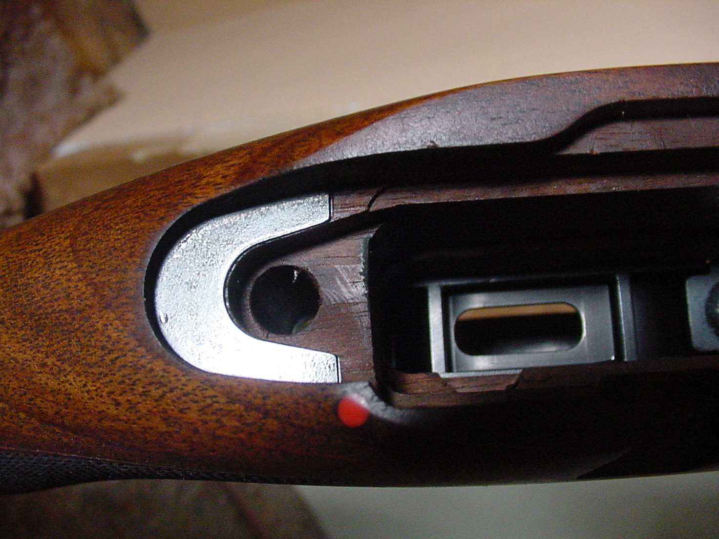

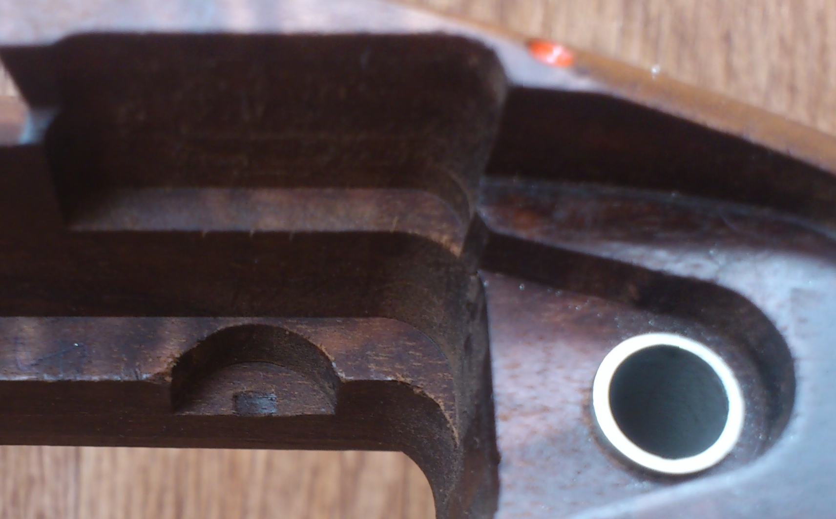

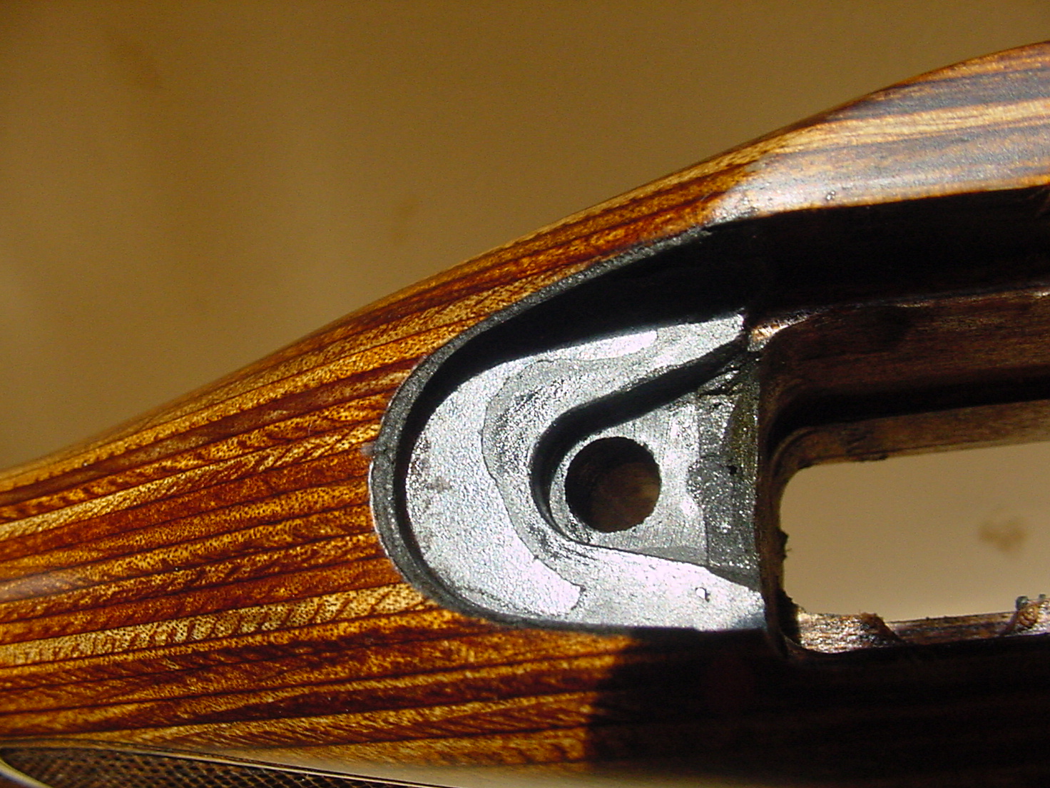

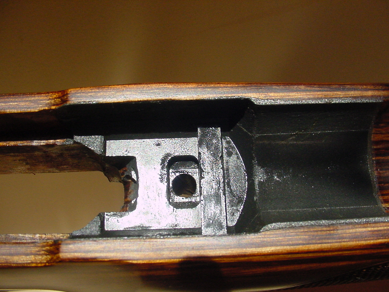

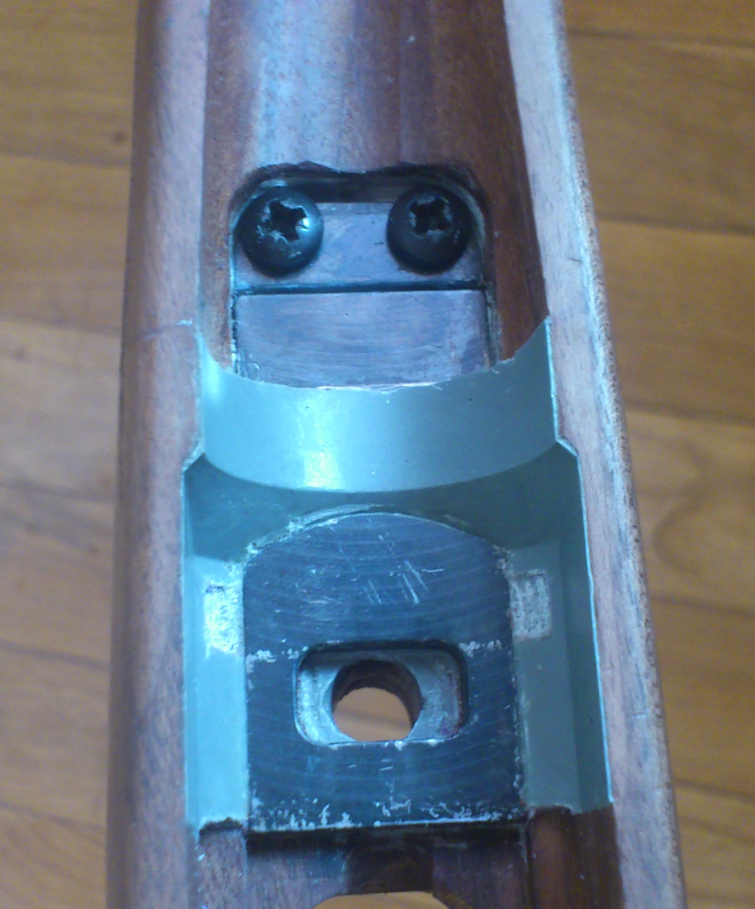

This is the bedding work done to my Sako 85 .243W Laminate Varmint by Hennessy´s Gunsmithing Service Townsville. The rifle was purchased secondhand so I don't know what it looked like prior to this work.
However, my Sako 85 .204R Walnut Varmint has the same front recoil plate as you have pictured plus a steel washer 0.020" thick on the stock under the rear tang the exact shape of the tang around the mounting hole.
When I first ever removed the stock I did a rough measurement of the screw tensions. The front was about 90 inch pounds and the rear about 50 inch pounds. That was the way it came from the Sako factory.
Neither rifle has any pillars installed.

That's interesting. Mine's a .243 Bavarian, which I bought second-hand. It was in near-new condition, despite being maybe five or six years old. There's no rear washer on mine, as you can see.
If your 204 walnut was new, and the rear washer is from the factory, then that suggests Sako may have known about issues stabilising the rear action on older, wood-stock models. Maybe a rear pillar or bedding is the way to go?
As for the 243 laminate, it's hard to tell from the photo, but is that a metal plate embedded in the bedding compound for the action screw housing to sit in as a recoil lug? Or has the entire front action been bedded in bedding compound?

First thing I would do is find a piece of steel 0.020" thick and make up a washer, then tension the action down a little more than you have been doing. I realise the Sako suggestion of tension but as I said mine had a hell of a lot more tension especially up the front.
My 204R was new and that is the first time the action has been out of the stock.
The .243W Laminate. No there is nothing embedded in the bedding compound. The entire front section, including the parallel section of the barrel is just in bedding compound.
They both shoot very well, the 204R about 0.4moa and the 243W is better than 0.3moa. I have a Tikka T3 Stainless Barrel that I am testing at present on the Sako 243W using Berger 90gr Boat Tail bullets that have been pointed and moly coated, using about 42.6gr AR2209 and these will group 5 shots around 1/2" at 200 metres. This is my 300 metre target rifle for competition. Bullets are seated to be around 0.020" jammed into the lands. The Fluted Sako Stainless Barrel does even better but also has less rounds down the tube, like just 125 rounds so far. The trigger on this has been very much lightened to well under 8ozs pull.

With your 243 laminate, there are two levels of bedding around the tang - a lower step around the rear action screw housing, and a higher step under the tang itself . . . does any part of the rifle touch the walls of the bedding (upper or lower level) or are the tang and action screw housing both clearanced on all sides, sitting only on each floor of the bedding compound?
I'm trying to figure out if the rear should be nice and snug, or if there should be a gap behind the tang, the rear action screw housing or both to prevent the rifle recoiling into the back of it and chipping the compound or wood behind the tang. To my eye it looks clearanced around each level.

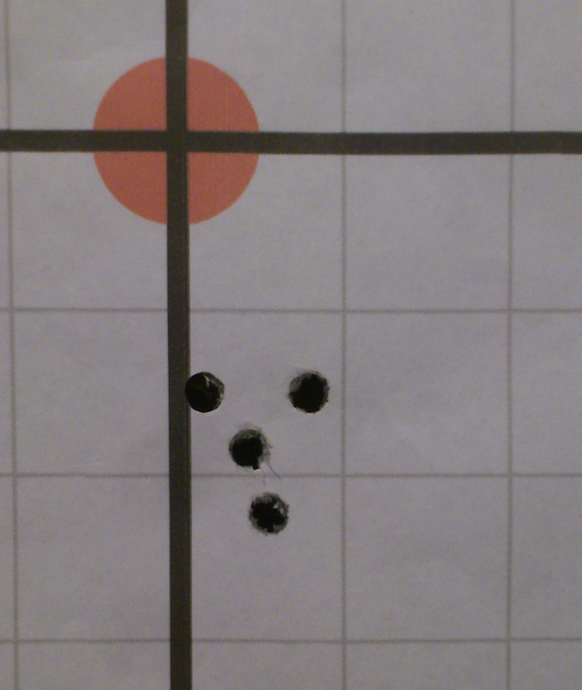

This is a four-shot test load I shot last week (100gr Sierra Game King, 39.5gr of 2209), so my rifle definitely has potential . . . when it's behaving itself.

Yep, I used the same tension as it was in the first place and the same for the .243W. Will check accuracy next time I set up to do some further load testing.
The washer on the .204R is just sitting on top of the timber, it is a tight fit around the outside so much so it won't fall out. I had to lift it to grab it at one end to remove it.
The bedding in the .243W is a tight fit all around including the sides, there is no room for anything to move side to side or even forward to back. It takes a little pressure to remove and/or replace the barreled action in/out of the stock. When it's all assembled there are no gaps anywhere including around the parallel section of the barrel. Done like any other bedding I have done or seen, bedding compound applied and then action/barrel pushed in and held in place with probably slight tension then excess material removed all around then let set. As my own Gunsmith said when he was working on it "very good bedding job" .
Looking at the shiny parts of the bedding it's the whole bedded part front and back including the section that looks like where a recoil block (like the Tikka T3) could be fitted that is taking any recoil affect. Without the action screws installed you cannot move the action sitting in the stock in any direction other than up and out of the stock.

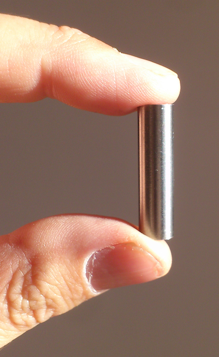

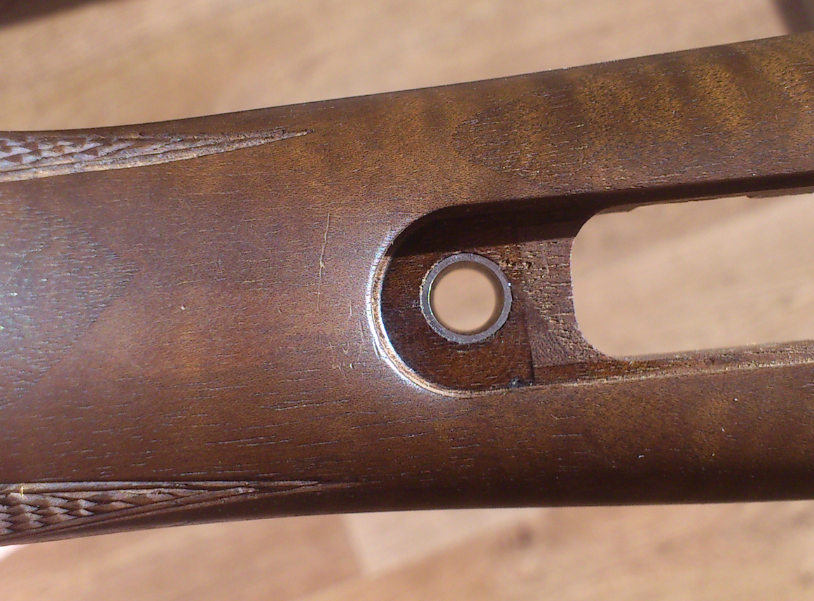

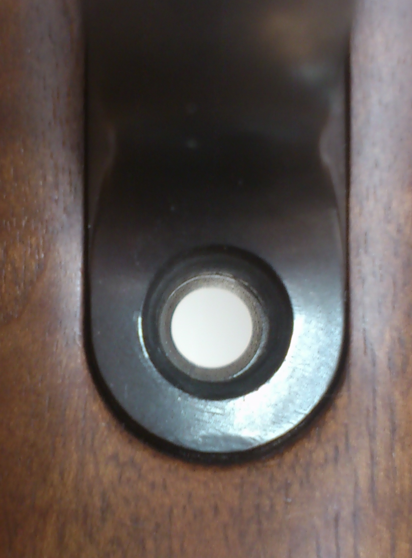

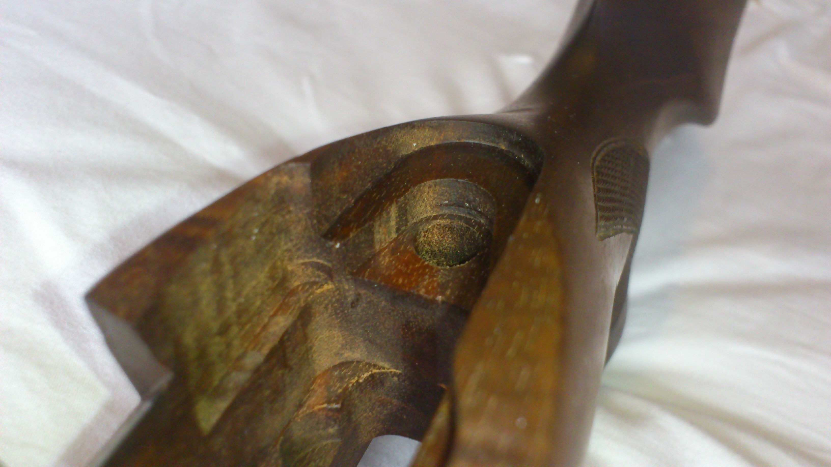

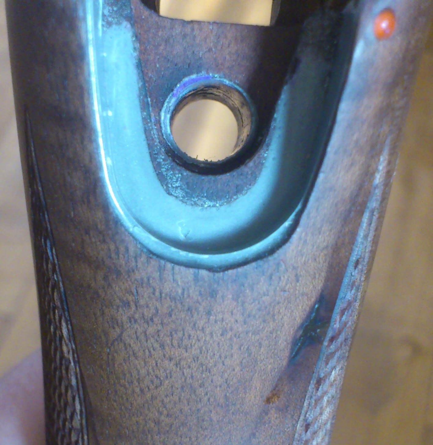

So now we're getting somewhere. I made up a stainless steel pillar for the rear action using 8mmx1mm tubing, which has a slight interference fit with the rear screw hole (it fits nice and snuggly). Here's what it looks like:
Fitted to the stock, you can see how the pillar supports the rear action screw housing, which doesn't touch the wood - only the rear tang (upper level) touches the wood).
To make the pillar, I first had to cut it over-length and fit it, then put some plasticine under the rear tang to see how much more I needed to shave off (about .030" initially). Once the plasticine indicated the tang was touching the wood with the pillar in place, I then had to shave a few thousandths of an inch off at a time so that the rear tang had good contact with the wood (slight compression) with the pillar holding the action in place. This way, the rear tang (action) is not being held off the stock by the pillar when tightened up.
Once I bed the rear tang properly with Devcon, it will set at precisely the right height - this is just a trial run for now to see how it works without having to alter the stock.
You can see the underside of the pillar flush with the trigger guard housing. Once the action is held in place, you can turn the rifle over to see if the pillar is too long or short by where it protrudes through the trigger guard.
You can also see from this photo that the rear action hole is drilled off-centre (towards the left in this photo, but towards the right of the stock as you hold it). The importance of this will be explained in a minute . . .

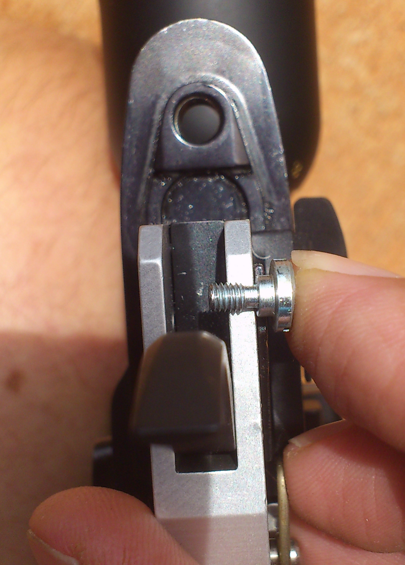

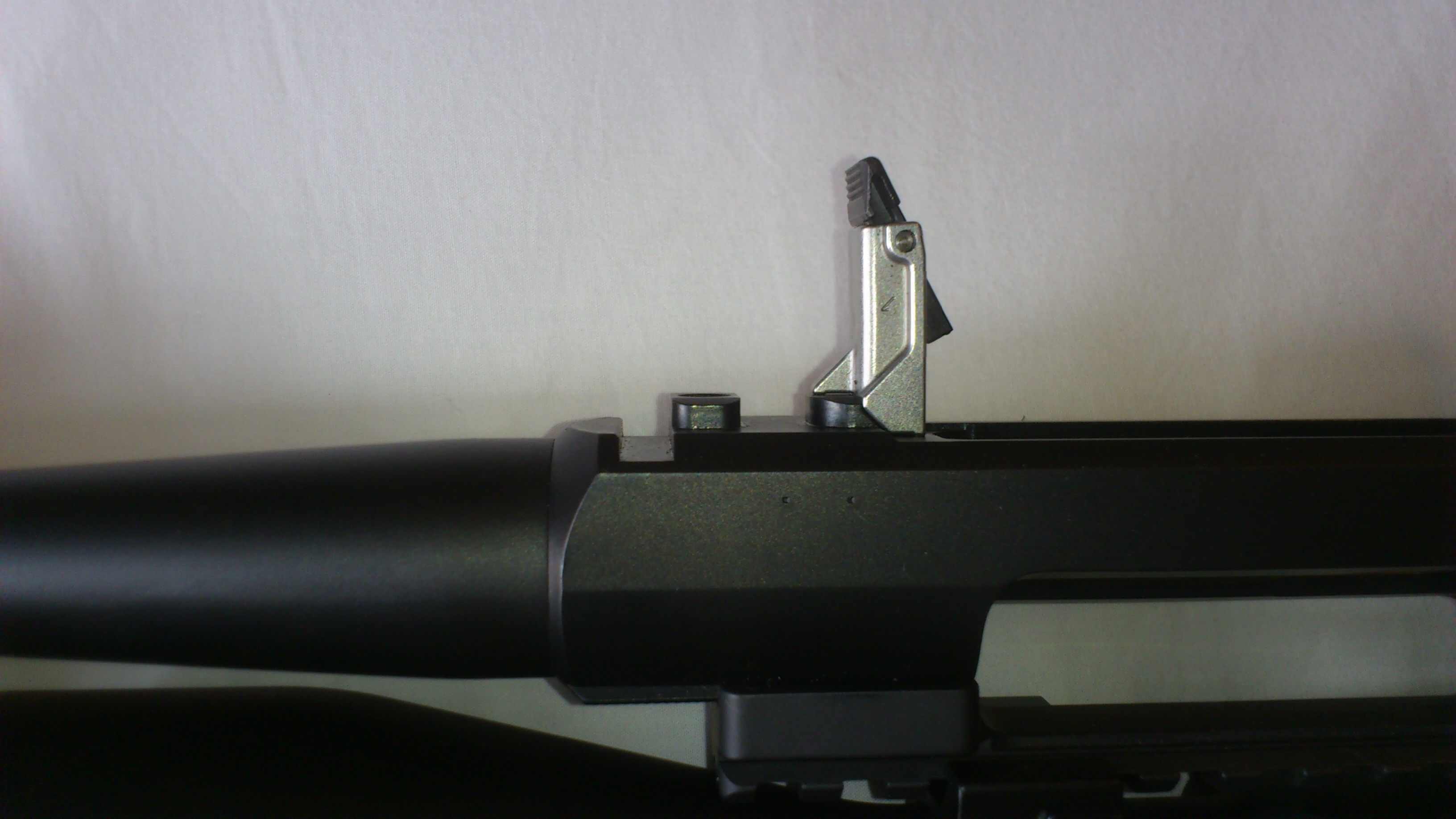

This is where things get interesting . . . After pulling the rifle apart again, I discovered safety screw had left an imprint on the stock where it was hitting. It is the dent in the middle of the half-moon shape in this pic. This cannot be good for accuracy and I can't believe it took me this long to see it.
There are possibly three reasons why the safety screw is hitting the stock
1) not enough clearance;
2) the rear action is moving around;
3) the safety screw itself is defective and sticking out too much.
I discovered it was probably a combination of all three. Have a look at the screw - there is a shank between the thread and the step where the screw seats against the trigger. You can see when properly screwed in, only a few threads hold the screw in place. On my rife, the screw was sticking out. It seems like a defective screw.
I will either need to find another screw, or use a dab of Devcon around the shank to create more threads to ensure the screw stays in place once tightened into position.

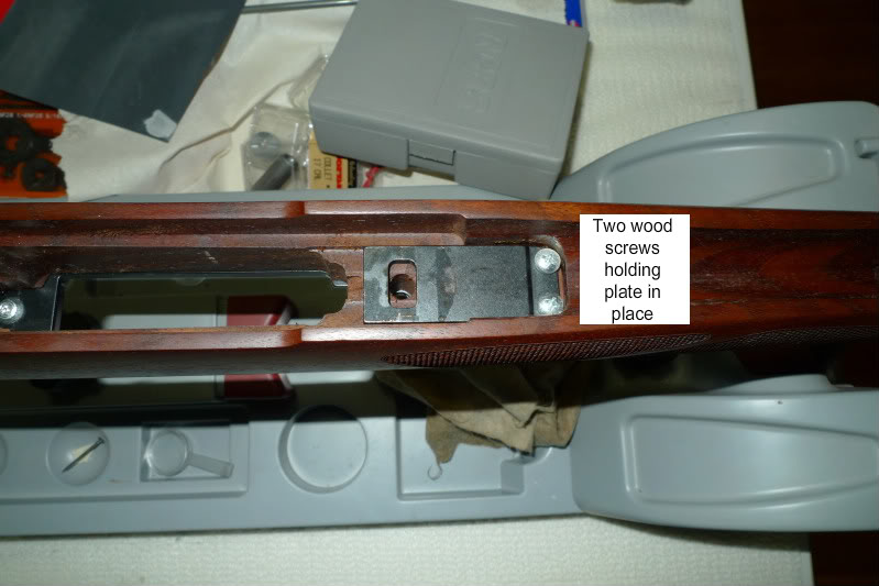

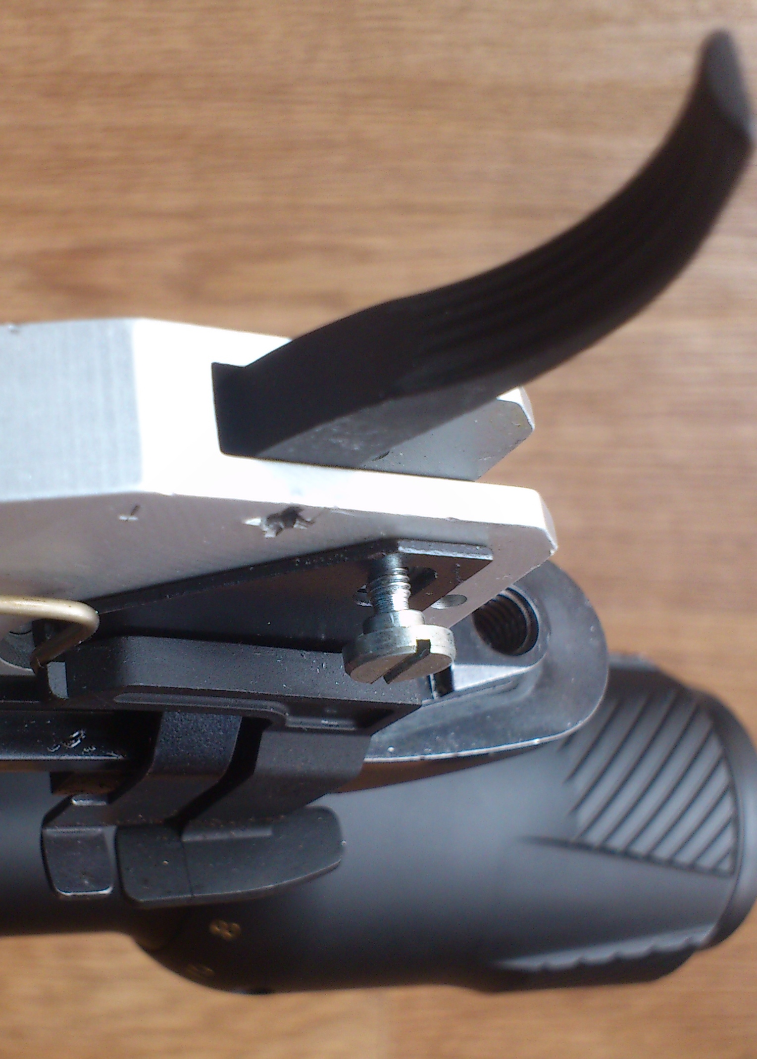

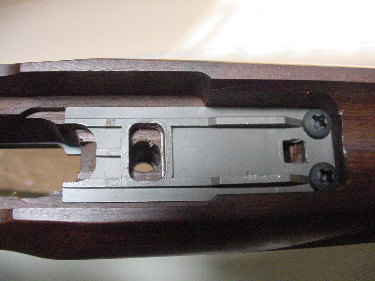

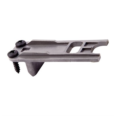

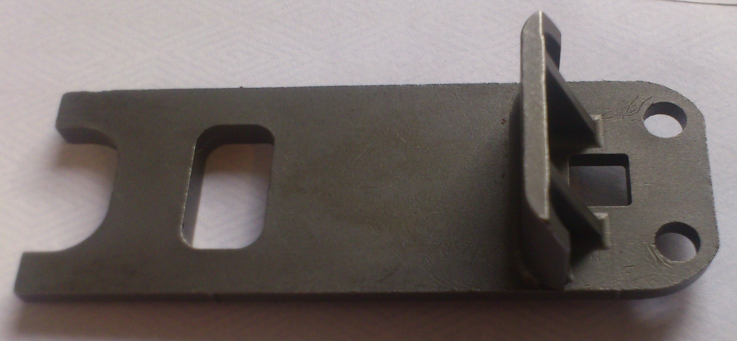

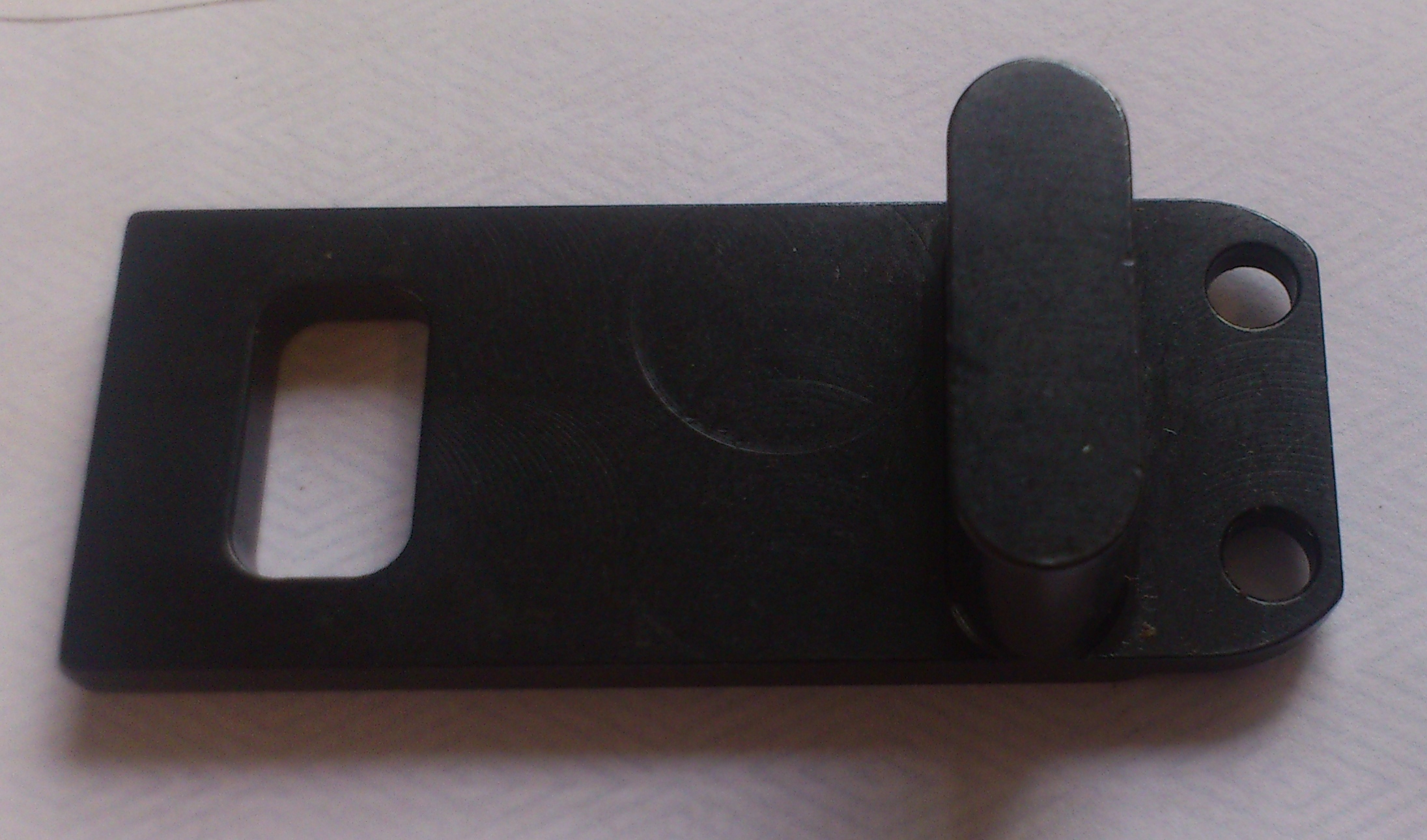

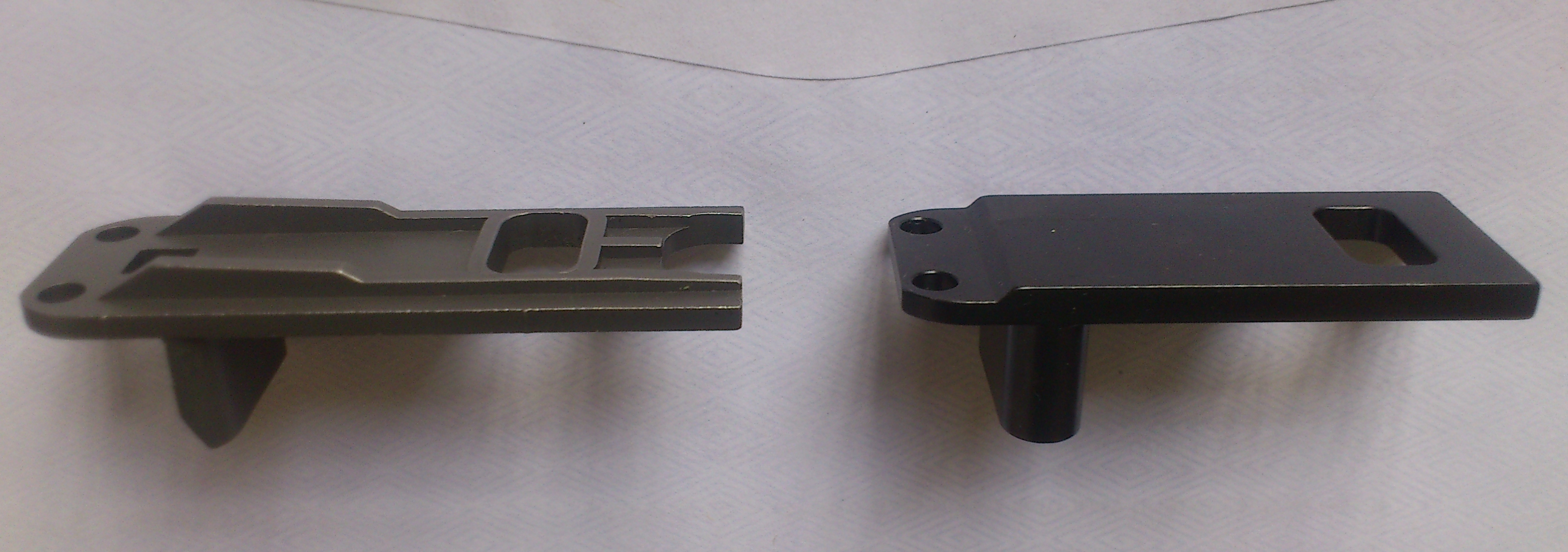

With the rear action sorted (at least, with most issues discovered), it was time to look at the front action. A friend of mine let me pull his new (12 months old) Sako 85 Bavarian apart and I discovered it had a different recoil plate to mine.
This is what mine looks like:
And this is the other design - which is much stronger and more stable (not my friend's rifle, but the same type of recoil plate):
It is difficult to see in the photo below, but my recoil plate is see-sawing and moving around on the stock - you can see faint impressions of where it has been moving around. Clearly I need to get a new-design recoil plate and bed it properly in the stock.

First mod: deepening the safety screw hole/recess so it doesn't bottom out anymore. Shiny stuff is new wood sealant. I also put a little dab of Devcon on the safety screw thread and snugged it into place. I'll put the rifle back together without the rear pillar, initially, to see if clearancing the safety screw makes any difference. Always best to eliminate one possible bedding issue at a time until the problem is narrowed down.

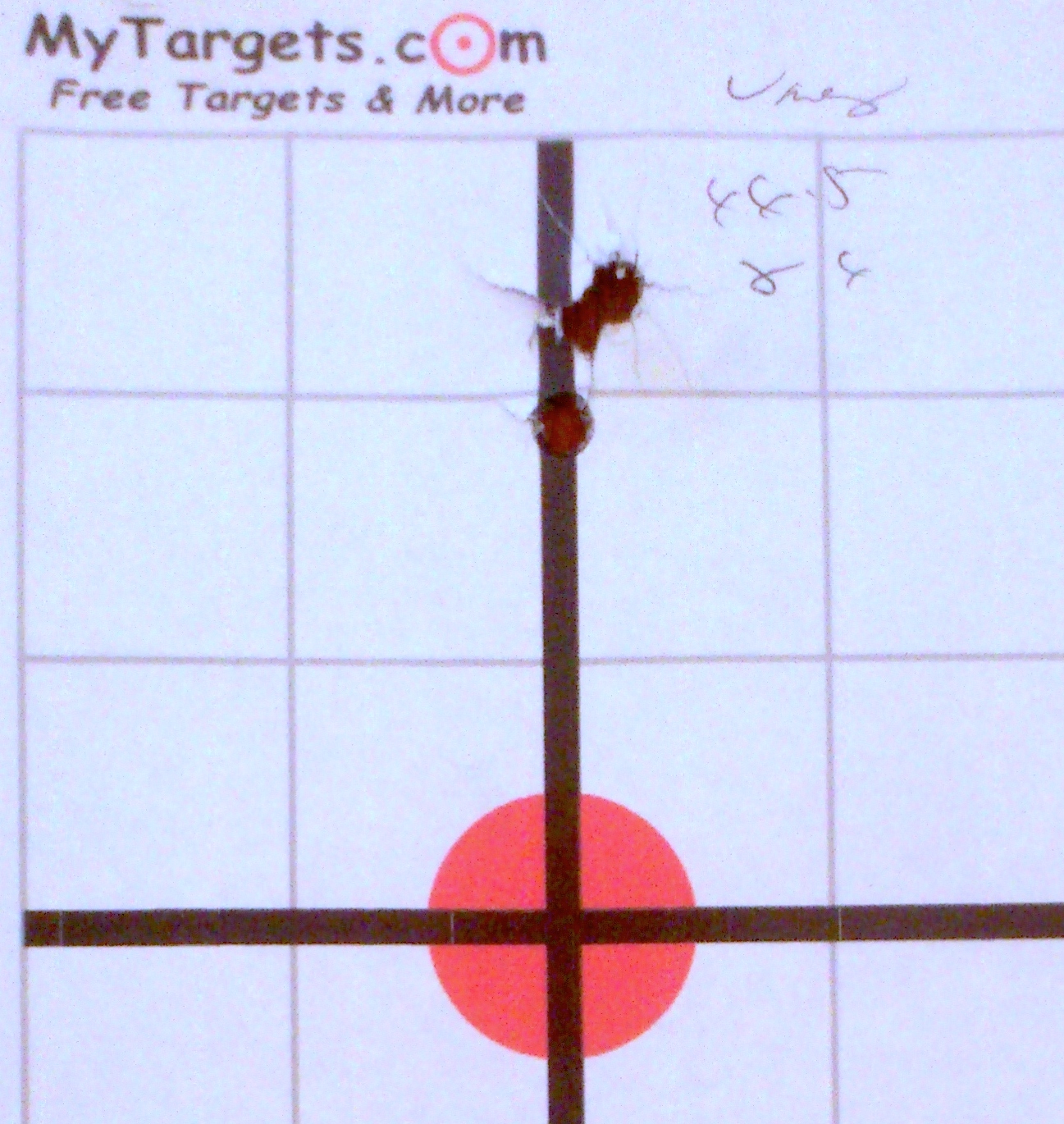

Hit the range today. Shot without the rear pillar in place and the rifle double grouped again. I put a little extra torque on the rear screw, too (40inlb), which didn't seem to make much difference:
I also noticed the barrel had moved in the stock, from the centre of the barrel channel to the left, after shooting a few rounds through it:
As soon as I replaced the pillar, the rifle started shooting a lot more consistently. All groups were at 100m:

I have not pillared the front, but I have bought a new recoil plate which I have now bedded. I'm also in the process - after lots of trial and error - of fully bedding the rifle (over the recoil plate).

First thing's first: I replaced the front recoil plate with the new/old design. I say "new/old" because I have seen this recoil plate on both new and old original Sako 85s, but somewhere in the middle they changed the design and then went back. The dimensions that count (thickness, width, screw hole placement etc) are exactly the same. They are also the same (interchangeable) throughout the Sako 85 range, from XS to S, SM, M and L actions.
Original recoil plate left, and the new one I bought from Beretta right.
New recoil plate
Old recoil plate
I then set about bedding the rifle. First, I bedded the recoil plate into the stock so that it was level and would not move in the channel. I used masking tape on three sides of the receiver lug - front and sides - that fits into the square hole at the rear of the recoil plate so that the rifle action sat level, with the rear of the receiver lug making contact with the recoil plate. I used masking tape around the barrel to centre it in the channel, then tipped the rifle on its stock and tapped it on the ground to settle recoil plate, lug and receiver at their rear-most point to ensure proper battery. I then torqued the rifle down so the action screws were nipped up front and back.
After bedding the recoil plate, I then bedded the action and rear tang. I also redrilled the rear action screw hole and centred it in the stock using 8mm tube and bedding compound.
You can see where I have bedded over the recoil plate. My main concern with this is that the recoil plate is made of steel and the bedding compound is mostly aluminium (Devcon). If the steel expands when it heats up, there is the possibility it could rise and dislodge the bedding compound. However, after shooting the rifle and pulling the action out of the stock when hot, I've discovered the recoil plate does not heat up much and so far there are no signs of disturbance.
I also plugged the action with plasticine where the old floating recoil lug would have gone (same as the Sako 75s and Tikkas). You can see a couple of rough patches either side of the bedding compound where I have plugged the gap.
Yes, I have a plan "B". If the bedding compound is compromised in any way, I will simply remove it from the recoil plate and leave the remainder attached to the stock (the bits on either side) to keep the action centred. The recoil plate is where the action beds to the bottom of the rifle - the bedding compound along each side of the inner stock simply keeps it centred during assembly and battery.
I only bedded under the rear tang, and not the lower level (I can always do this later). Like the recoil plate, I left some wood untouched as a guide, then removed some wood around it with the Dremel and bedded the bottom, sides and rear of the tang. After bedding, I clearanced a very small amount of bedding compound around the very rear of the tang to prevent the tang hitting it under battery and chipping the wooden stock. I needn't have bothered, as I discovered the action is now rock-solidly bedded in the stock and does not move at all when the action screws are tightened and loosened.
So, did this make any difference to the way my rifle shot?
No. And yes.
My first five shots were all over the place. The bedding had made absolutely no difference at all. I was dumbfounded! So I tried my old trick again, and put the stainless steel pillar back in the rear of the rifle and tightened both front and rear screws to 6nm.
I could not believe it. The first shot went 1/4" low at 100m. The next two shots went into the same hole, just above. I loaded a fourth round and it, too, went into the same hole. That's a .150" three-shot group opening to .400" with the first shot. This is the best group I have shot so far with the rifle, and the bedding does seem to have worked. It certainly hasn't hurt. This was with my 87gr V-max load of 44.5gr of 2209 chronoed at about 3300fps.
So I pulled out another accuracy round, 100gr Game Kings with 39.5gr of 2209 at about 3000fps. The first shot was pulled after the guy next to me let off his 243 just as I pulled the trigger and jumped out of my seat. The next two shots went into the same place as the Vmax (almost the same hole). The third shot was a little lower. Everything seems OK . . .
The next group is when things started to fall apart. Two shots into the same hole 2" above the target - same as the others, then two very wayward shots low and left-right.
Just out of curiosity, I got my torque wrench out and put it on the rear action screw - it was loose.
I have noticed that each time I shoot the rifle without the steel pillar, it's all over the place. As soon as I put the pillar in and torque it down, the rifle shoots dead-straight. I was seeing a pattern developing . . .
When I first got the rifle, it shot really well. But then I noticed the action rattling around in the stock. When I pulled the action screws out, I found remnants of thread locker on the action screws and thought nothing of it. This oversight is what has probably cause me all my grief.
What I have learned in all this is that the stainless steel pillar not only helps stabilise the rear of the rifle, but it allows me to torque the rifle up tight without putting too much pressure on the wooden stock. Without the pillar, the rear action does not like to be too tight in the stock (the more you tighten it, the more groups spread). However, with the correct torque - and no locking compound on the threads - the screw simply works its way loose after a few shots and shoots like a pig. With the steel pillar in, you can tighten it with the correct tension on the stock, but it also stays in place longer (but eventually it, too, vibrates loose).
So what to do? I just bought some Loctite :lol: The next stage may be to bed the stainless steel pillar into the stock and simply leave it there and Loctite the action screws into place and be done with it.
If my rifle shoots consistently after all that, I will have reached a number of conclusions:
