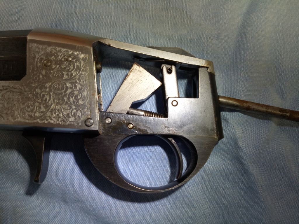

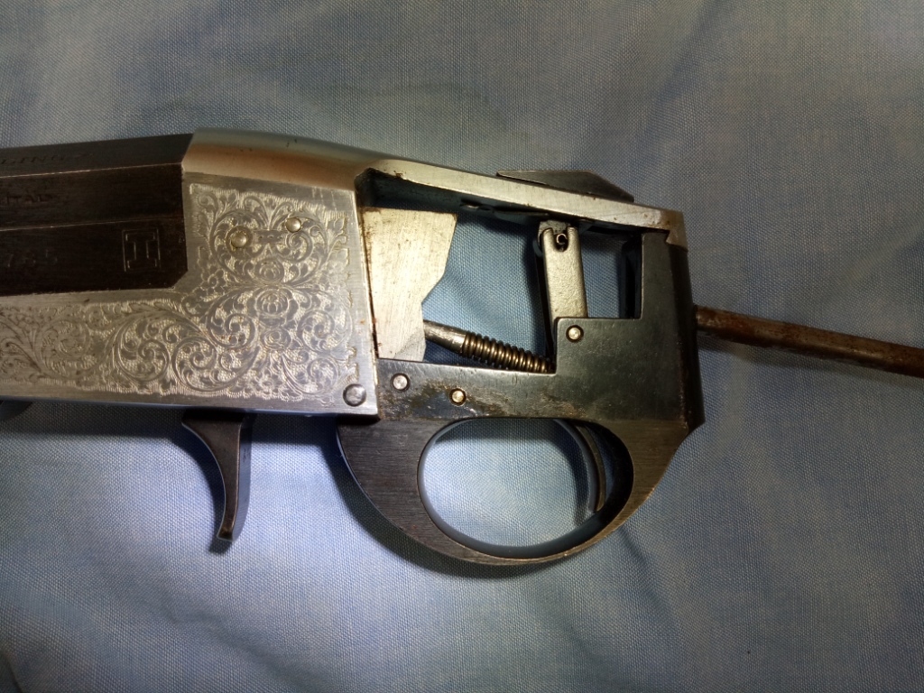

Hi,
I have an old single barrel Stirling 12 g that I recently refurbished the stock & added a red bead.
Its in good nick and I am using it as a camp gun. I'm getting older so its light weight is appealing compared to my U/O.
My problem is the trigger pull on the Stirling is currently 3.5 kg compared with the U/O is about 2.3 kg. So it is fairly heavy. If I could reduce the pull to about 2.5kg it would be great.
Can any one assist with whats involved in lightening the trigger a little. I assume I will need to polish the sear a little & perhaps some other adjustments.
Are they complicated to dismantle and re-assemble?
Just looking for some guidance. The gun isn't worth much so taking it to a gun smith would be a bit silly.

Maybe a lighter spring perhaps?

bentaz wrote:Thats what i was thinking too but it depends on the type of spring and the way the actions set out.
Yep I can't imagine it would be too flash, so should be reasonable simple I would imagine but hard to say until we see some pics and a quick polish in the appropriate areas should see it working a lot better I would think. :thumbsup:

Post by Oldbloke » 02 Jan 2017, 11:51 am
So, here are 2 pics. Cocked and fired. I don't think I can change the spring for a softer one as it will increase lock time.
I'm guessing knock out the two pins at the bottom to remove the trigger and striker. Then polish the sears? I just don't want it all to go "boing"
and not be able to re-assemble it?

Got it apart and resembled OK. The sear on the hammer was rough. Gave it a few rubs with 600 wet and dry wrapped around a needle file. It's still 3.5kg but noticeably smoother so will leave it at that I think. Quit while I'm ahead. :)
Re: Shotgun trigger help
Post by Oldbloke » 02 Jan 2017, 5:18 pm
No hole in the pin but pointy nose pliers did the job OK. Thanks gents.
