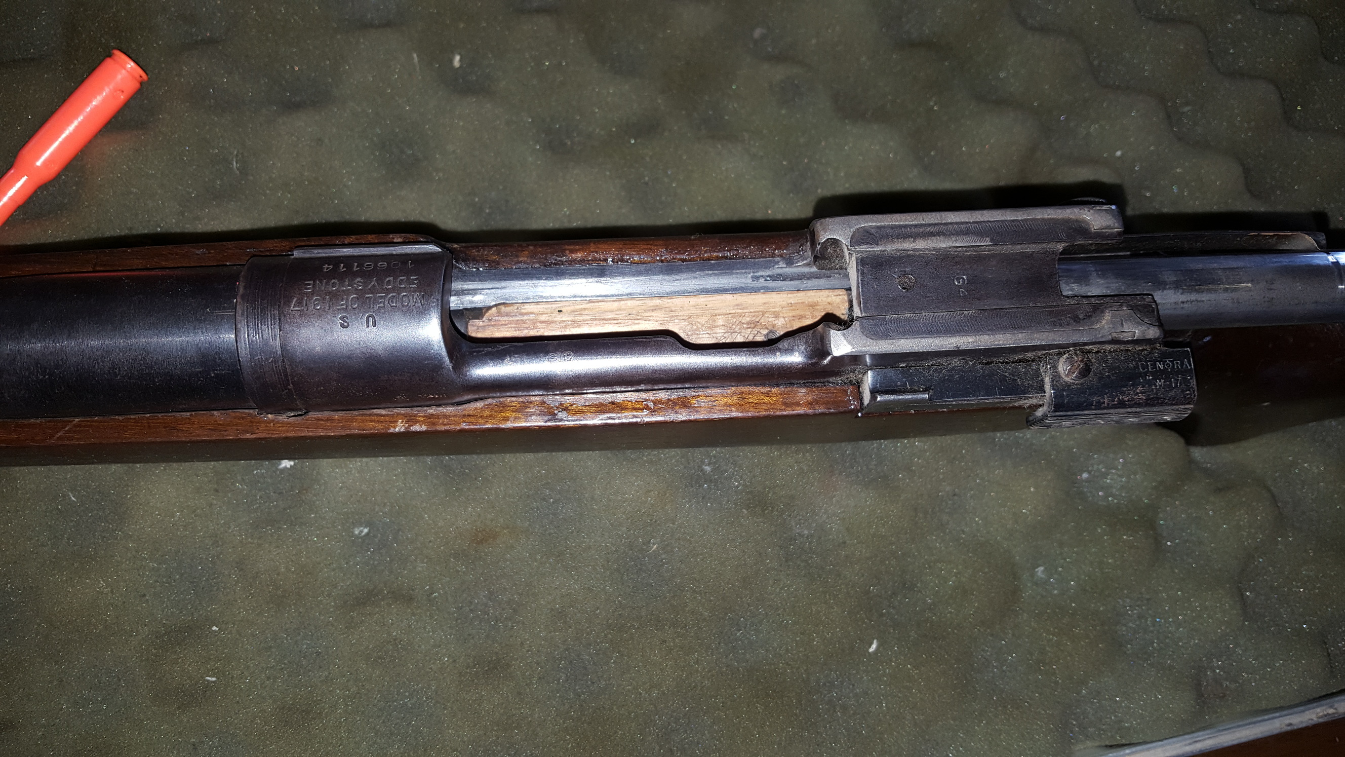

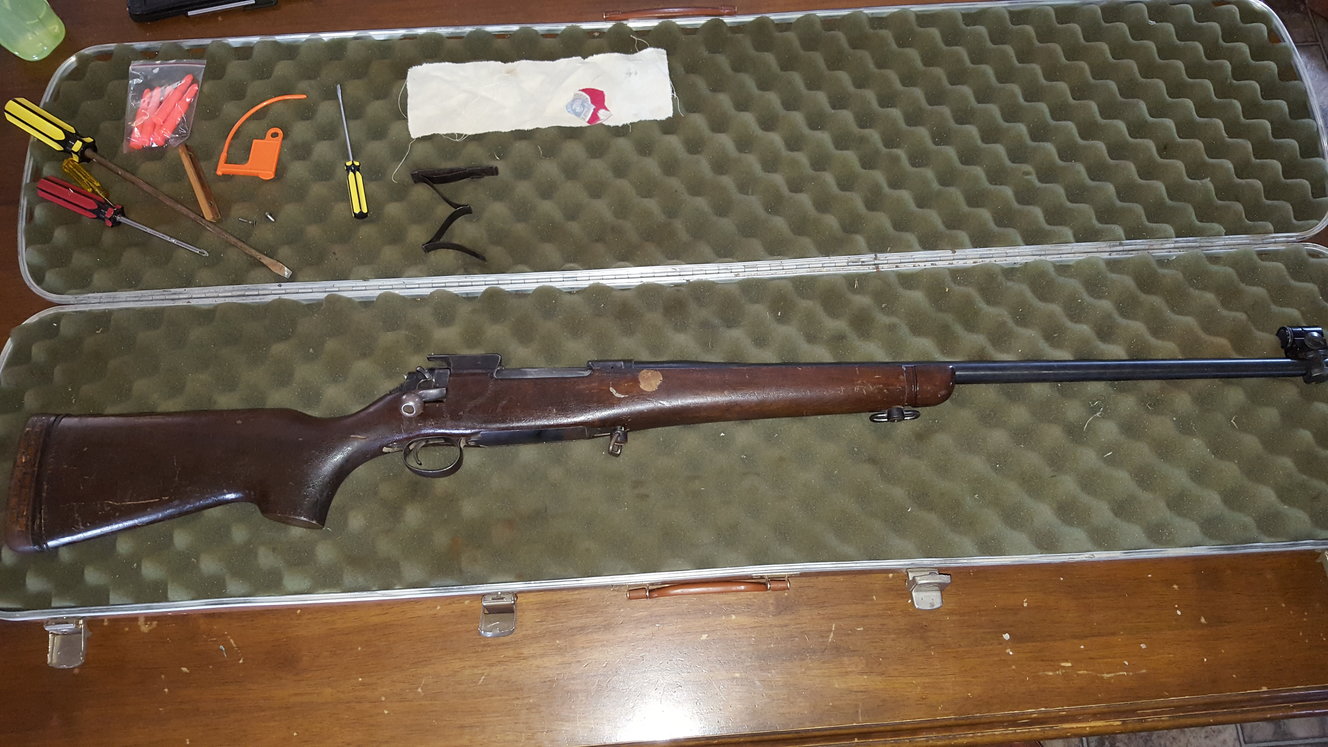

Thanks for all the responses - to clarify - I am customising a previously converted Eddystone M17 ( not by me).
M17 side1.jpg (214.01 KiB) Viewed 5743 times
The rifle had been converted to 308, had the stock fore-end cut down, sight wings hacked off and the box mag removed, wood insert glued in mag well under floorplate and wooden plug screwed on top of insert to be a feed ramp. So far I have sourced the parts ( box mag, follower and spring ) to restore multi-shot capability, bought a boyds thumbhole blank that needs inletting, have sling and mounting hardware and got a quote from Allan Swann to modify bolt face and rechamber to 300 H & H.
I bought the missing target peep to go with existing foresight and side mount block on rifle but have changed direction & am thinking of just going with a scope & mounts. I have a scope & rings but need bases - which means the bastardisation of the rear sight area needs attention and either a custom flat base mount fabbed up, a set of existing bases modified & fitted or smooth rear receiver to a suitable curve.
I have been thinking of fitting dovetailed iron sights ( as a just in case ), a muzzle brake, a dayton traister speedlock/trigger combo and (re)parkerising - but all but the parkerising may go by the wayside in favour of a trigger job, bipod and going shooting much sooner. Bought it for $100 and should come away pretty close to a grand when finished depending how much I do myself and if I add the bells and whistles. Plenty of daydreaming and "what about this..." style planning have gone into this one so far. Pics to follow

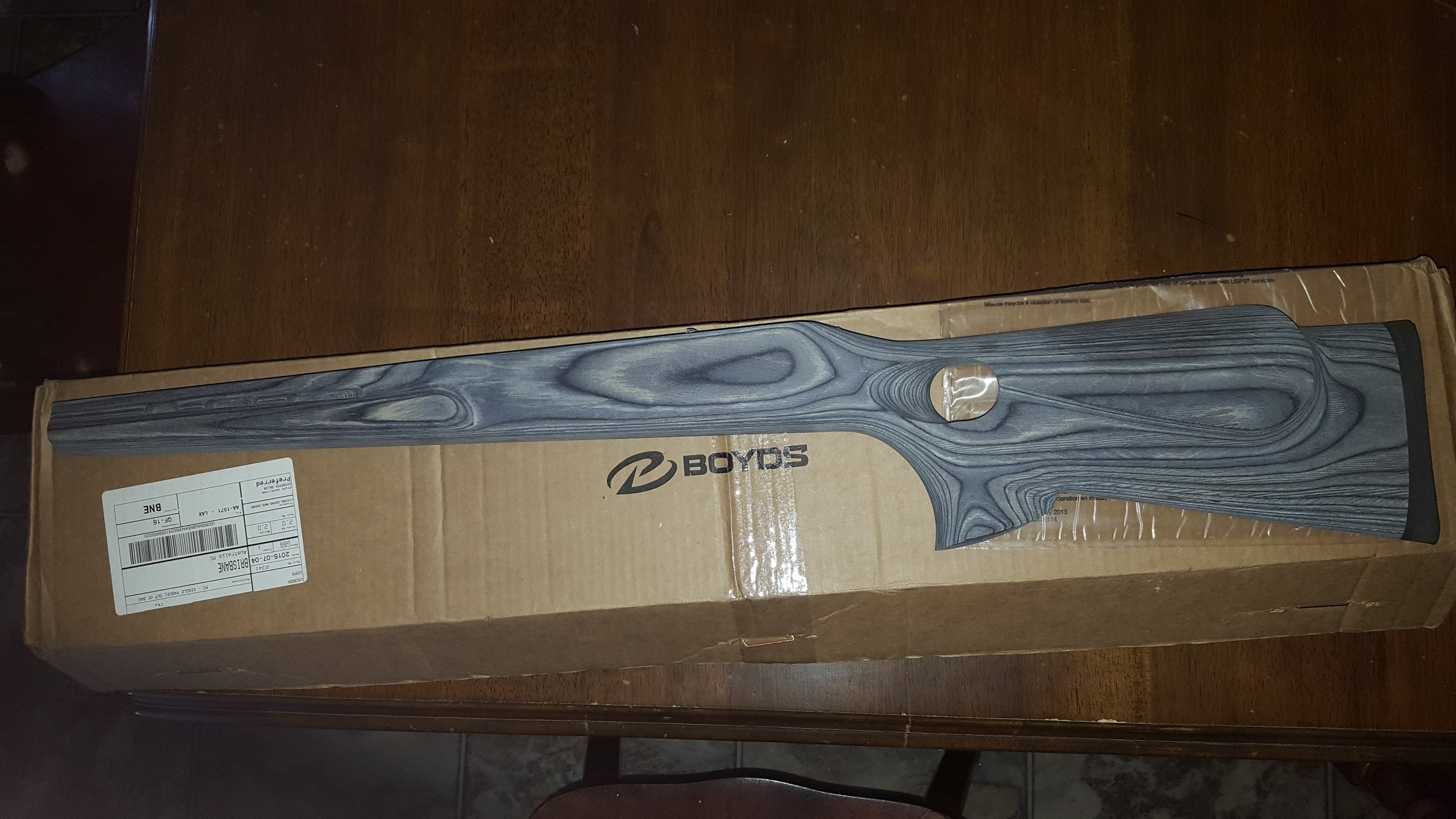

Any chance of a picture of the Boyds stock, where did you source it..????....how much did you pay...????....is it for expressly for M17/p14 ..???.....or is more thgot one of these M17's in 308 that is running cut down mil timber on it and would love a sporting stock.

Sounds like James is using the Prairie Hunter stock.
Collector Boyds are now making Pro Varmint, Pairie Hunter and Classic for the P14 / M17. I had to get my stock from Richards Microfits as Boyds were only doing the Prairie hunter. The prairie hunter forend wasnt wide enough to fit the barrel I'm running.
Also Cameron Hatcher is now making stocks for the 14 & 17 as well. He can also do a thumbhole as well. Which I will eventually go with.
Boyds are a belly mag
Richards can do either belly or the coverted straight floor plate version.
Cameron can either as well

The stock came from "The Barn" in QLD. I saw it up on a gun sales site and rang them the next morning. It doesn't have any designation to help out with style or variant but it looks like this:
It was $190 + 25 post which was a bit better than the model specific options that were listed at ~$295 + post and compared favourably to Hatchers at $285.
It was a fine balance between what fitted into my "projects" budget and being able to grab it right now!

Looks like a Prairie Hunter stock.
Check the bottom metal for fitment by the pictures looks like it may suit a converted bottom metal. What they did was to cut and re weld and with some grinding to straighten the bottom metal, which did away with the belly mag. This conversion also reduced the magazine capacity as well.
