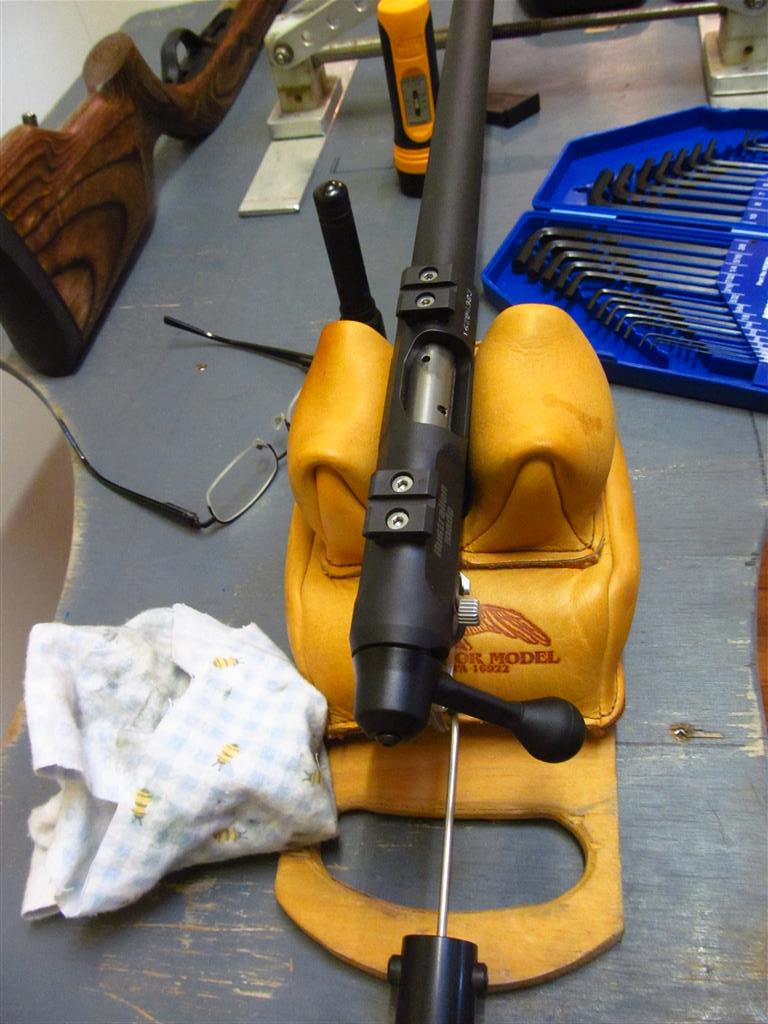

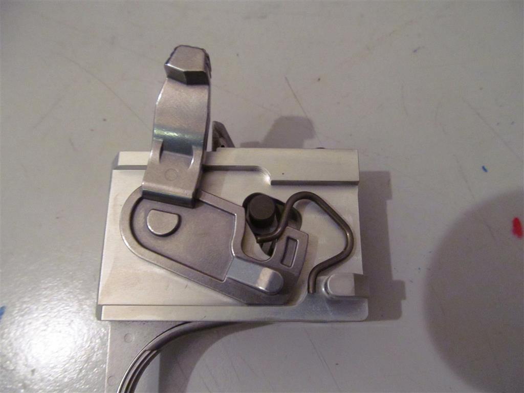

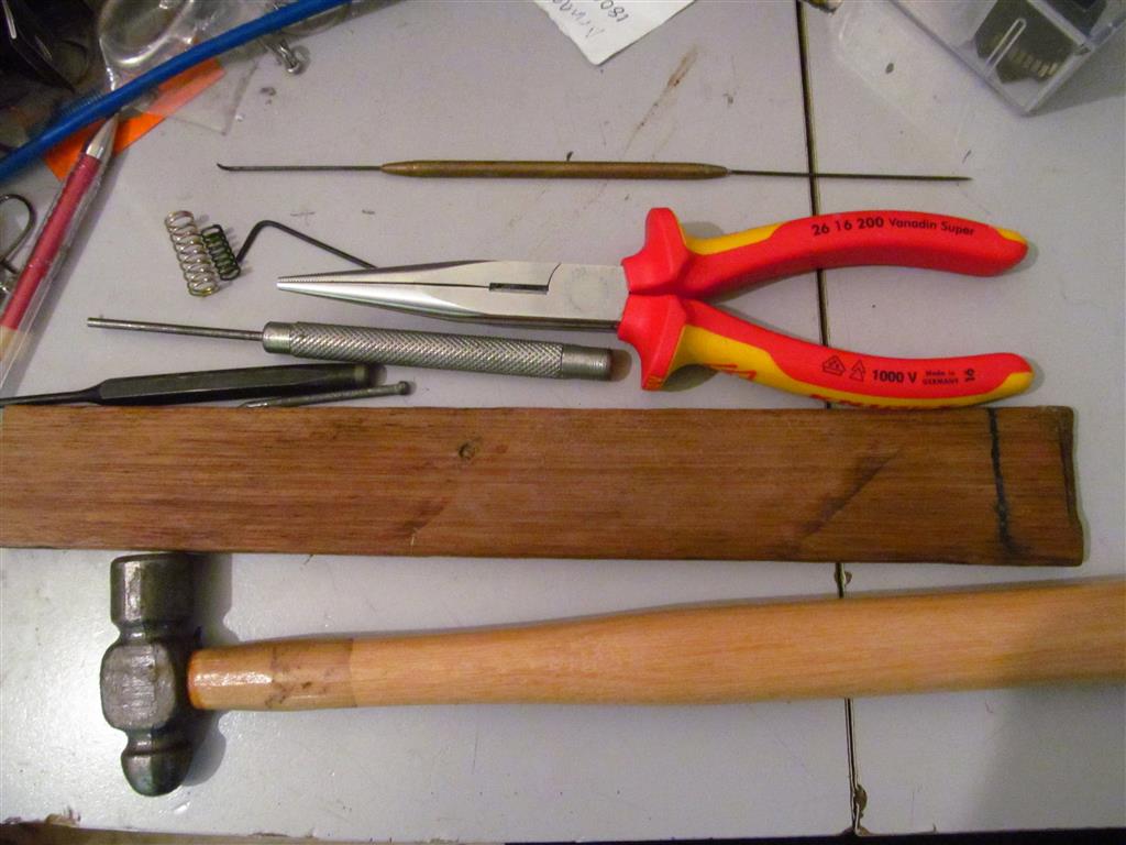

well I did the trigger today and wile still a bit heavy for me it is a lot better than it was and will do until the smith has at it
the tools
IMG_3772 (Medium).JPG (95.61 KiB) Viewed 7317 times
off with the trigger assembly
IMG_3767 (Medium).JPG (67.02 KiB) Viewed 7317 times
