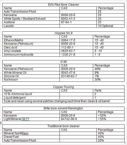

I have always struggled with the cost of some of this commercial cleaners. Mostly just kero. I have collected a few over the last 2 or 3 years. here they are. Let us all know what they are like if you try them. I mainly just use Eds Red.
Gun solvent recipes.JPG (96.45 KiB) Viewed 4622 times
