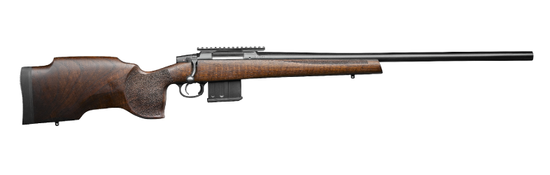

Hi,
I'm considering one of these as my next purchase to be used primarliy for centerfire hunting rifle (metallic silhouette), but I'd like to do the odd trek with it too:
(in case you want more info, here's a link to it's specs: http://cz-usa.com/product/cz-557-varmint/)
The only problem is would I need to shave 1.2kg of weight off it to comply with the rules (it weighs 5kg unscoped), but I really want to keep the walnut stock because I absolutely love the look and target ergonomics of it - (love me a nice target comb) .
I guess the first port of call would be to chop the barrel down; it's a 26" so I guess I'd need to take at least 1/4 of the barrel away, bringing it back to around 19". Possibly I could bore the stock as well to reduce some weight towards the rear.
Question: do you guys think this is a viable idea? And besides from the drop of velocity, how detrimental do you think such a cut would be to the rifle's harmonics (and subsequent accuracy)?
Any speculation is welcome.
In2.

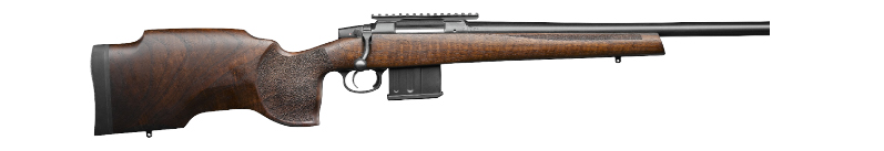

Here's a concept pic at 18":

Mate... That is a nice looking rifle. I do think it looks a little weird with that stock and a short barrel.
When i chopped down my Howa heavy barrel it reduced weight LESS (edit) than i expected. From memory 6' chop only saved 120g or so!
This may be a case of "no free lunch". Maybe you are best off with one rifle fore target and one rifle for hunting.
In response to your question on harmonics, etc, you will find the shorter barrel is stiffer and so a good cut and crown will have no detrimental effect on precision and may improve it.

As long as you keep the cut perfectly square or get it recrowned you'll lose no accuracy.
I've done it a few times with a hacksaw and lost no appreciable accuracy lol

Also, (best ask one of the silhouette guys, like GameRancher, but) i'm not sure that style of stock is best suited to off-hand shooting. More designed for prone & bench shooting.
I agree, i do like it too but maybe you are better off with a hunter weight rifle and trim the barrel of that down to shave a bit more weight for alpine work as well as stiffen the barrel up (shorter cylinder of the same diameter is stiffer). Might be better for both silhouette and mountain hunting with both stock and rifle weight better meeting requirements.
