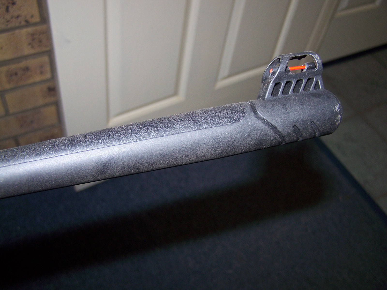

I have a Stoeger X20 air rifle and want to remove the plastic cover over the tip of the barrel.
It appears to slide onto the muzzle, and is held in place by ( 1 ) grub screw.
I have removed the screw, and pulled and twisted the plastic cover, but to no avail.
It won't come off.
Can't see any other grub screws or pins in it.
Anybody know how it comes off ???????? :unknown:

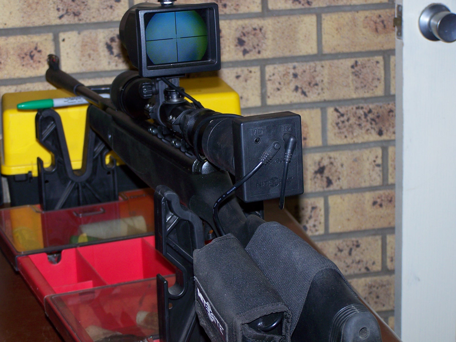

Only reason why I want it off is because when I put the NiteSite on the scope the fore end cap and fibre optic blade creates a shadow.

From the picture, judging by the moulding part line extending beyond only the tip you want to remove I would suggest that the whole thing is a moulding that extends down the barrel and possibly also contains the rear sight as well.
Check for more screws or pins further down or some other form of attachment.
It could also be that the front grub screw is in fact a sight adjustment and not an attachment at all.

straightshooter wrote:From the picture, judging by the moulding part line extending beyond only the tip you want to remove I would suggest that the whole thing is a moulding that extends down the barrel and possibly also contains the rear sight as well.
Grub screw is underneath the barrel, and when taken out,,, the steel barrel under is plainly visible, so that takes care of the possibility that its a sight adjusting screw.
The pics don't show it but the plastic molding ends completely only another 10 mm or so away,,,,, and there is definately no other screws or pins.
Thanks for your input tho,,,, :drinks:

The manufacturers booklet that comes with the unit states that it is suitable for use with springer air rifles.
I checked this before I started using it with the air rifle,,,,,, good pick up though,, a lot of people may not have thought of it.
Manufacturer also states "The NiteSite units did not suffer any damage when tested with 100 rounds consecutively fired from a range of centre fire rifles up to and including 0.450 calibre rifle without moderators."
In the pics, its amazing how ragged the surface of the plastic comes up under the camera flash.
Not made any better looking by the small piece fractured out of the hood, (did that the last time I used it)

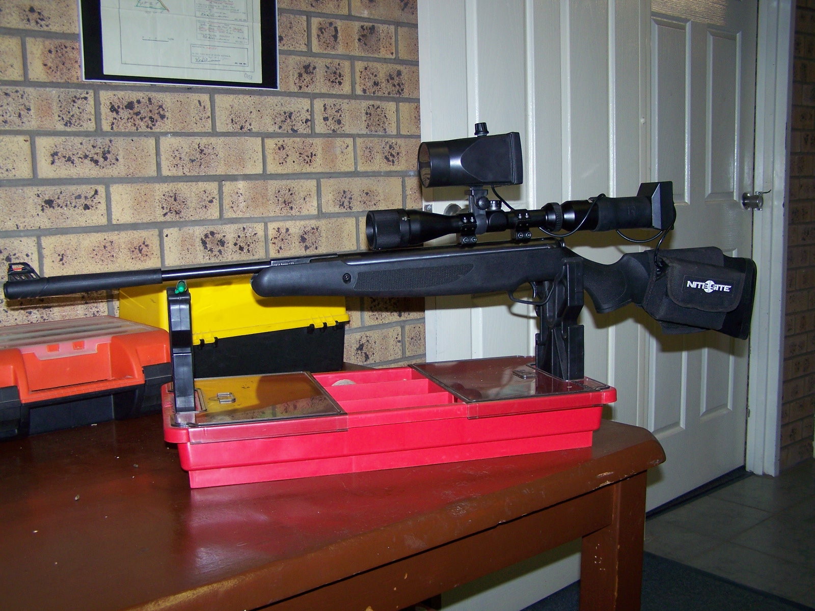

Post by marksman » 29 Sep 2017, 7:36 pm
do you think you could put up a picture of the complete rifle with nite sight
I am just interested in how it is mounted
Re: Advice on removing muzzle cover/shroud ?
Post by Die Judicii » 29 Sep 2017, 9:19 pm
Pics as requested,
Posts: 4427
Post by marksman » 29 Sep 2017, 9:44 pm
thanks for that :thumbsup:

I would hazard a guess and say its screwed on and the grub screw is to lock in place when tight , think of it like and extended barrel cap back along the barrel hold barrel in vice with timber ether side try to wiggle the shroud it may have loctite on it as well. what brand of firearm

pomemax wrote:I would hazard a guess and say its screwed on and the grub screw is to lock in place when tight , think of it like and extended barrel cap back along the barrel hold barrel in vice with timber ether side try to wiggle the shroud it may have loctite on it as well. what brand of firearm
Tried this to within a few thou of doing damage,,,,, with no joy.
It is a Stoeger X20

Having now seen the larger pictures it is apparent that it is intended to be a cocking grip as well as a front sight and as such it needs to be robustly attached.
So what methods of attachment are possible.
Moulded on - unlikely and it wouldn't need a grub screw.
Threaded on - unlikely, too expensive to manufacture.
That leaves pressed on or glued on both of which probably will be very resistant to removal.
I would suggest you contact the importer and ask to speak with their warranty repair gunsmith to find out if it can be safely removed as well as finding out if the replacement part is available.

Another idea that I recently thought of trying, is to tape a cardboard tube (maybe out of a dunny roll) over the objective lens.
In the book they suggest using a sunshade if the foresight or moderator interferes.
Must be worth a try.
