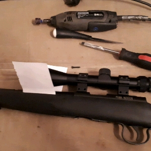

Post by Cherza » 21 Oct 2017, 5:57 pm
I took a few burrs off with a stone I use for my knifes it worked a treat.
Safety is still a bit stiff I might try some synthetic grease.
I managed to get out for a shot today it didnt shoot to bad.
Tonight im going to free float the barrel.
Cherza
Posts: 37
Re: .22 Norinco jw15 or puma hunter mods
Post by Cherza » 21 Oct 2017, 7:37 pm
Just finished free floating the barrel.
I was going to upload some pics but having a few dramas with the 1g limit
Cherza
Posts: 37
Post by Cherza » 21 Oct 2017, 7:49 pm
The free floating barrel has come up well I had to take allot out.
Cherza
Post by Cherza » 22 Oct 2017, 10:20 pm
Well I just finished my first trigger job.
It actually feels ok now im pretty sure they have a two stage trigger correct me if im wrong.
It was so heavy before you had to keep on squeezing it and just wait for it to break.
I found two pen springs the first being to light.
After a bit of playing with the adjustment screw and adding a few shims to limit over travel becuase the sear kept on catching, the slightly heavier spring felt pretty good.
After that i closed the bolt hard and gave it the bump test and it passed.
I havn't tested the weight yet but the first stage is nice and light then you can feel when its going to break hopefully this is two stage and its not just creep?
Ether way I can live with it its heaps better.
