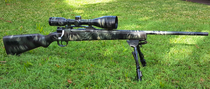

Hi,
I currently have a Mauser FN chambered in 308. (fab nat d'armes de guerre herstal belgique)
It has been modified years ago into a sporter style rifle.
I'm considering getting it a new barrel as the current one has served its time.
This is a budget project.
I see a few ex military 6.5x55 being sold for between $80 and $150 on the net. Can these be fitted..? I know the internal mag length is huge.
Or are there other aftermarket options. Anything that will fit a 308 bolt face.
I'm told that it will cost me around the $150 for a gunsmith to change the barrel and do the headspacing.
Any advise would be greatly appreciated.

Forget about an ex military 6.5 barrel as it will likely be for a small ring mauser so the barrel tenon major diameter will be too small at 1.0" instead of 1.1" for a large ring mauser such as yours.
More importantly how have you established that your present barrel is unserviceable?
Have you considered the wisdom of spending $500+ on a rifle that will still only be worth $500 or even less when this camo fad falls out of fashion.
