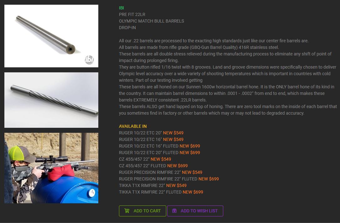

Post by bladeracer » 22 Jun 2020, 2:57 pm
Bugger, $550 for a barrel for the RPR .22LR looks like something worth investigating :-)
RPR barrel.JPG (106.6 KiB) Viewed 7356 times
Re: Anyone make/supply Barrels for Ruger Precision Rifles in
Post by in2anity » 22 Jun 2020, 3:05 pm
bladeracer wrote:Bugger, $550 for a barrel for the RPR .22LR looks like something worth investigating :-)
Priced well aye. Can confirm blade, without question that IBI barrel groups measurebly better than the factory.
