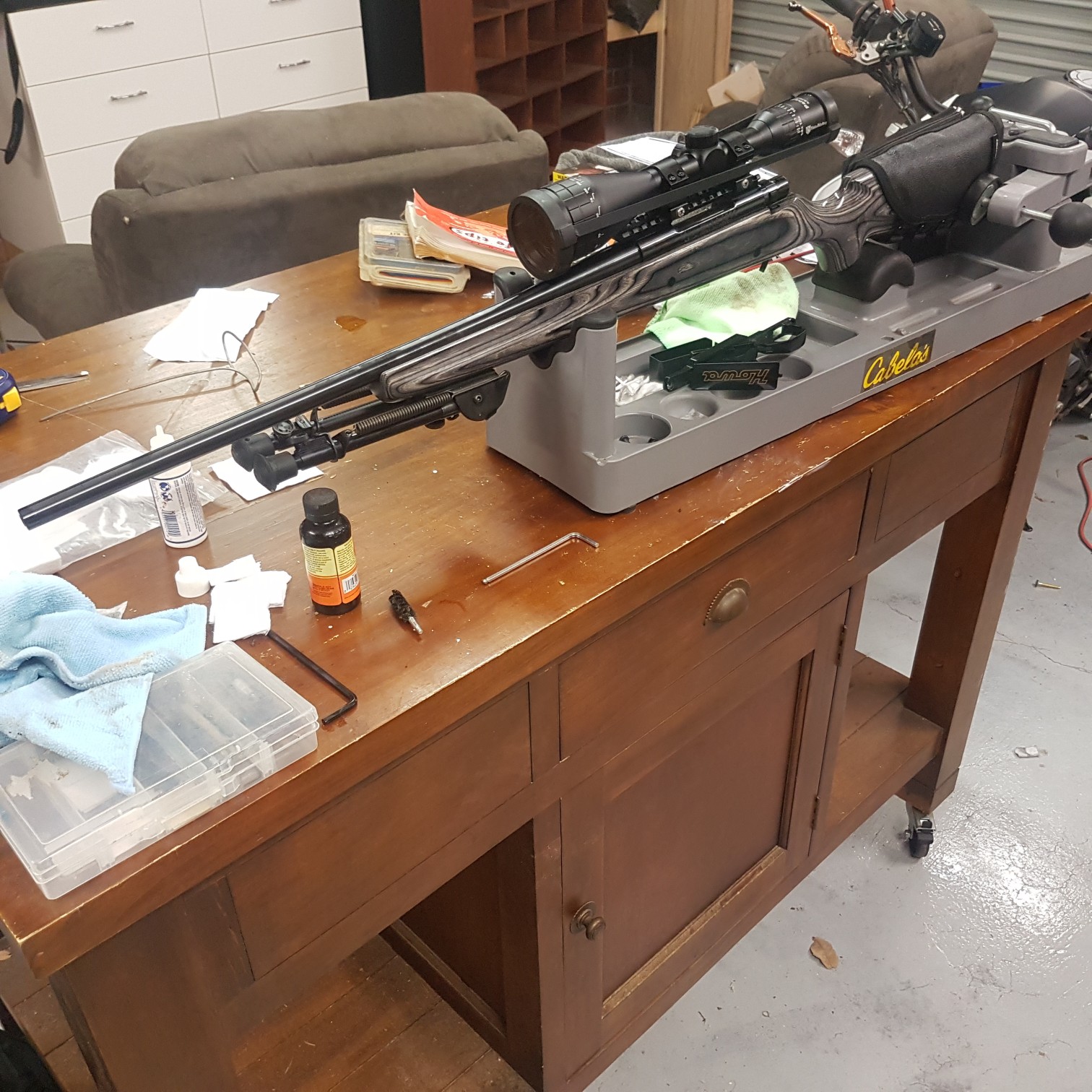

Far from ready to admit defeat, I cleaned and pulled it apart tonight in anticipation of an overhaul and some new parts.
First thing I did before pulling it apart was check that all screws were tight. I nipped up the action screws and one scope mount screw needed a quarter turn, nothing substantial. After tightening, I cycled the bolt and it now one of the locking lugs gently clips the receiver as you cycle it.
Stock
So we have found the culprit. The stock must not be 100% square as the action is slightly twisting when the action is tightened. I have had a few Boyd's stocks and this is the first time I have run into any really problems.

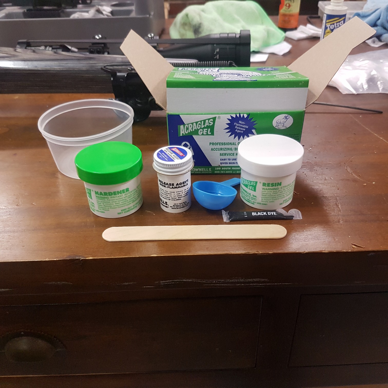

So I look over at the acraglass bedding kit I bought a while ago and decide it's time to bed this thing. And while I'm at it I will put some pillars into it.
Acraglass
Acraglass contents
Never felt the need to bed a rifle before.
Most modern rifles I have owned have already had some degree of pillar bedding. And I've never really had a lemon that couldnt be fixed with some mild tinkering or proper finishing.
I have read plenty of literature and watched lots of videos on the subject of pillar and glass bedding. Everyone has a slightly different take on the subject , and there are several variations of the same theme. They all do essentially the same thing though.
So I am going to document my journey , bedding a rifle for the first time. I will post my results wether they be flawless or fcked up.
First of all though, I would open the floor to any tips or tricks you guys may have learnt. Pitfalls to be wary of. Products you have used and recommend. Products you would not use again etc.

Do it in steps. ie the bottom metal first. Then drill out the holes for the pillars and part glue them in place. Then do the top bedding job. I have seen it all done in one sitting on U tube but when everything is floating and nothing is fixed it is a absolute ...... Putting the pillars in first may be the best starting point but just glue them in at one end so the glass can do the rest of the gluing in .

The conclusion comes from the fact that in the previous stock it cycled flawlessly. With zero tension on action screws the bolt cycles flawlessly. In the new stock with mild tension on the action screws the bolt has a very light bind. Further tightening makes the bolt bind quite badly. Therefore logic would dictate that the action is not sitting square in the new stock, it's twisting ever so slightly as tension is increased on the action screws. Could be something as simple as a little burr I'm not seeing, sitting right in a perfect corner, adding just enough leverage as you tighten it down to induce a twist. I will clean out all the inletting with a Dremel as well as make some holes/divots to anchor the bedding.

Just finished doin the same to my howa and m39 rifle the 308 is now a tack driver i used jb weld for mine it was also a rubber over mould. Best advise i can give you is make sure that your chosen release agent is going to work well with the chosen bedding compound. I ended up working out that the lanolin case lube that i made worked better than one shot and boot polish. Scariest part about the whole job is the removal of the action. The rest is easy.

I used JB weld with Lee Lube as the release agent sprinkled graphite just to be sure. worked really well. From what other have said since it appears the JB is a bit runnier than devcon. It still starts to set pretty quick though so you need to be prepared. But then once its all together let it set a day or so other wise thin sections tend to crumble or crack so patience is also key. On the flip side not too long as it is easy to trim when still a bit soft. :unknown:

As you say, rough out your inlet by about 1.5mm but don't go over board. You don't want the bedding compound too thin but you also don't want it too thick. I would also wait to do that until you have fit your pillars.
To correct any skew in the screw holes, ream them out as much as possible before fitting your pillars then fit your pillars to thee action by screwing them to it with screws of the same thread as your action screws. Wrap the screws in tape first so that they are centered in the pillars. Apply bedding compound around the pillars and in screw holes. Be sure there is plenty of release agent on action and between pillars and action and pillars and screw heads because you don't want it all sticking together.
Drop the action and gooed up screws into the inlet and fix in place with rubber tubing so it is held firmly inplace with no torque applied. When it goes off, remove screws and action and then go about the full length bedding of the action.
Have fun and take your time and clean everything well as you go. Wear disdposable surgical/food handling gloves and have the box on hand. It will save you spreading compound every frea king where.....

All good advice. I also have some modelling clay on order from eBay, awaiting delivery.
