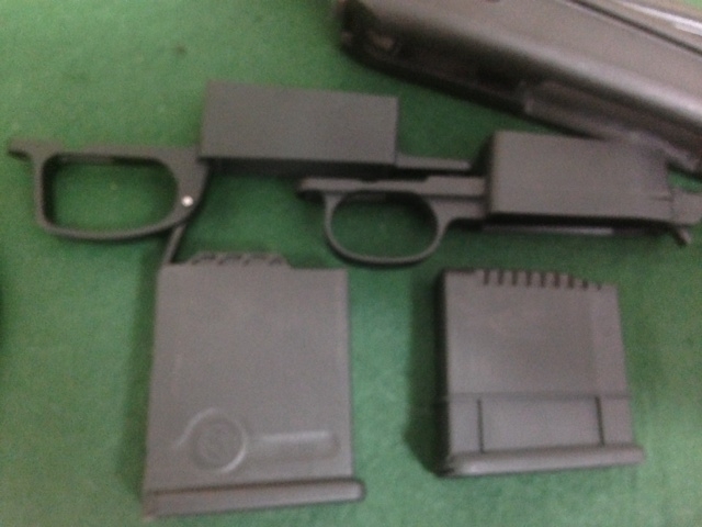

Post by Frog » 25 Jul 2014, 7:46 pm
Hi Kaine, I tried to upload pics but apparently are too big to load...
In comparison every thing is totally similar, holes line up, the recesses for the magazine line up the whole kit n caboodle. The Atlasworx unit fitted very easily into the inlet of the stock once I zinged out the smallest bit of material with the Drem tool.. So disappointed. I spoke with the guys from Delta Tac who I ordered the mag from and they have been really helpful but it seems like I have the correct mag....
Frog
Posts: 4
Re: Atlasworx DBM?
Post by Frog » 26 Jul 2014, 12:21 am

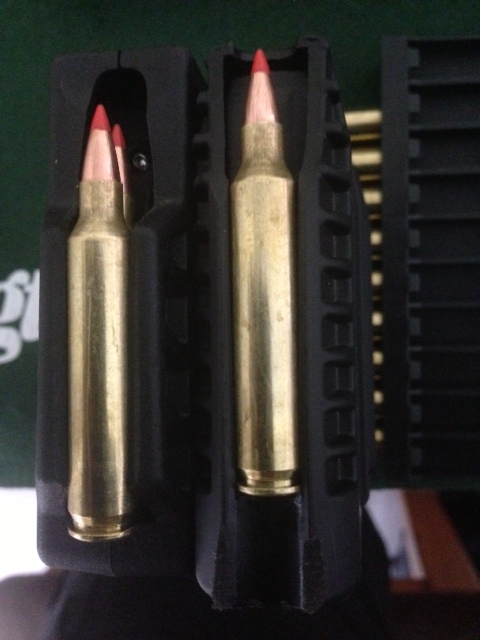

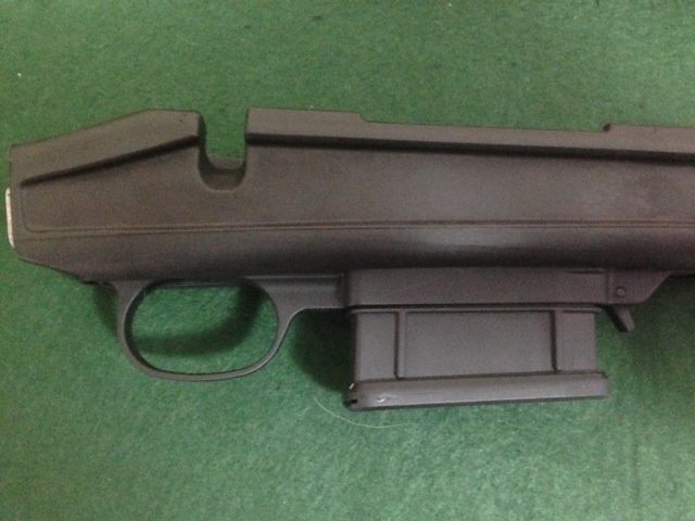

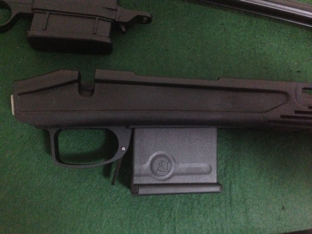

With the mags lined up side by side, AI (left) Legacy (right)
Legacy Polymer base and mag
AI mag and metal in stock, note it lines up at the rear the same as the legacy polymer unit
Frog
Posts: 4
Re: Atlasworx DBM?
Post by Frog » 26 Jul 2014, 12:31 am
Note in picture 1 how the legacy mag spaces the 204 round to the front edge of the mag.
In (picture 3) the side shot of the legacy mag and the AI mag, the base or rear of the 204 round lines up approximately with the polymer reinforcment rib that runs down the side and to the rear of the mag (see photo 1 as reference).
Also in photo 1 note where the base of the round sits in the AI mag in referece to the legacy mag then note photo 4 and you can see when comparing the pics how far back the round is sitting in the mag and its relationship to its position in the stock once mag is placed in the mag well (see photo 4).
Also of note with the mags installed in the stock if you were to draw a 180 deg line up the rear of each mag you will notice that they both locate in the same position of the stock. (Photos 3 & 4)
Personally I think unless the AI mag is retro fitted with some sort of limiting bock or spacer to move the round forward then this thing is not going to work unless the floor plate is cut and shut by moving the mag well forward by the distance of the spacer block as seen in the legacy mag which is a totally unrealistic option because of the front action mounting screws that pass through the front of the floor plate, pillar bed and screw into the action....

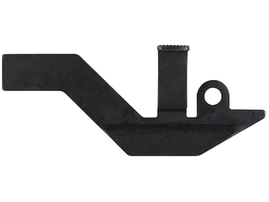

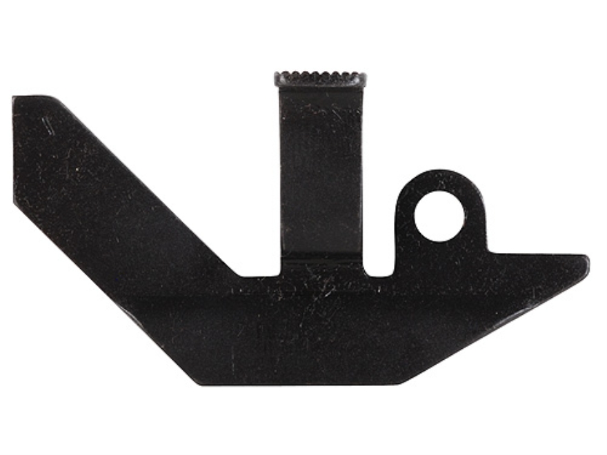

Just in case someone else stumbles across this post fitting a DBM to a 223 Howa/Vanguard
The 223 has a different bolt stop to the 308 etc. & to get it to feed from the AI mags all you need to do is cut the bolt stop down or replace it with a 308 bolt stop.
223 bolt stop.jpg (91.85 KiB) Viewed 8975 times
308 bolt stop2.jpg (119.38 KiB) Viewed 8975 times
