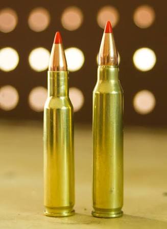

Post by yoshie » 03 Sep 2017, 9:40 pm
222v223
images (4).jpg (14.06 KiB) Viewed 6103 times

Different body taper as well as length. Case head the same and same neck diameter, that's it. Get the proper dies.

Post by marksman » 10 Sep 2017, 4:13 pm
yoshie wrote:222v223
a fairly heavy crimp on the 223 yoshie
Re: RCBS reloading dies - Are 222 Rem and 223 the same?
Post by yoshie » 10 Sep 2017, 4:39 pm
It's a google image, i dont load 222 but i do load 223 & 222Rimmed.
yoshie
Posts: 676
Post by marksman » 10 Sep 2017, 6:32 pm
:thumbsup: no worries
