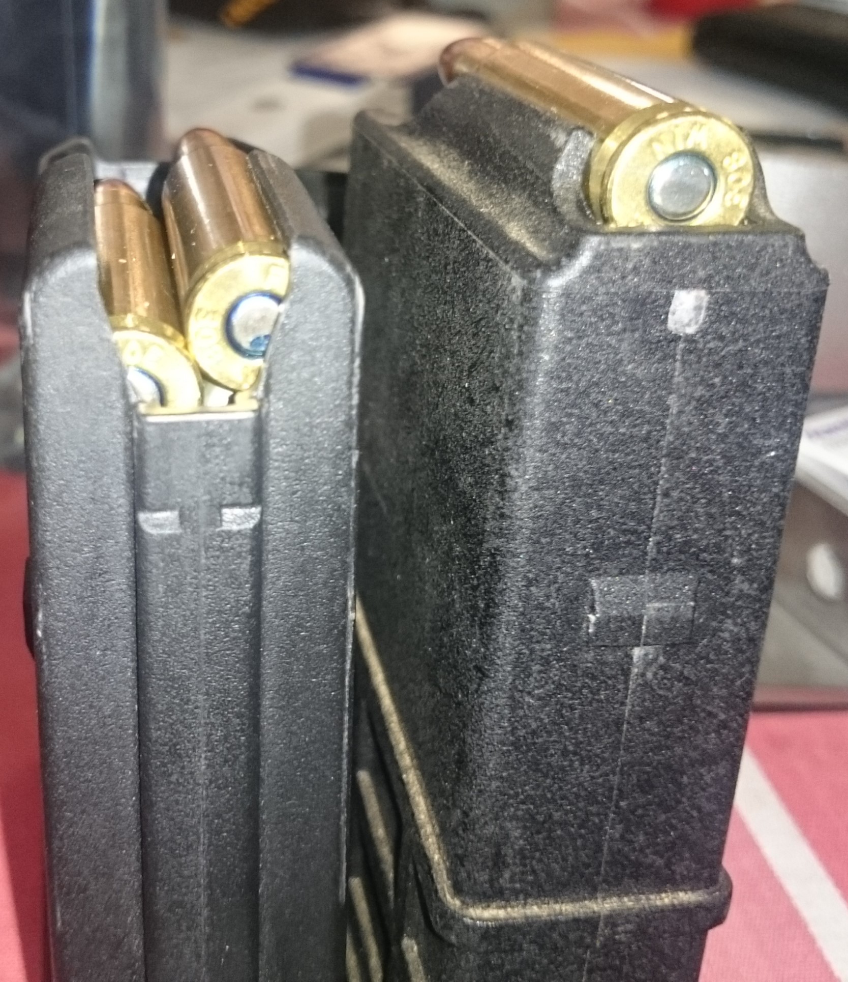

Looking at it a bit further, we note the lips on the Ruger-supplied P-Mags are deforming when the mag-follower is putting any pressure on them (when there are rounds in the mag), and causing the lips to splay out and up, and so fouling the bolt.
These mags are just on 6 months old, and havent been left in a hot car or anywhere they could be exposed to excessive heat.
See attached image.
The Ruger P-Mag is on the left, and if you look down beside the shoulder on the RH side, you can see a score mark where the bolt is dragging across the lip.
The P-Mag on the right is an MDT-TAC P-Mag, and much stiffer lips, due to the single stack feed.
The AI metal mags, and the MDT-TAC P-Mags, all work perfectly.
However, in just 6 months, the RPR mags are pretty much stuffed.
My intial bright idea was to lightly sand the lips where they are fouling the bolt, but then we realised that 'give in the design of the lips will keep it happening until I run out of lip to sand away!
My mate was really surprised, and hadnt seen the same on his .223 mags.
I do keep my mags full most of the time, but havent seen any warnings against this, and it isnt the springs that are losing tension!.
Given I use my RPR a couple of times most days, they get a fair amount of use.
However, I'm not impressed with how quickly they've become junk..

Addendum: Turns out I was supplied with MagPul P-mags, and not Ruger P-mags.
Apparently, some people got supplied with Magpul, and some Ruger.
Local Gun Shop (where I bought it) is getting onto the supplier to ask about it; he's also NOT impressed.

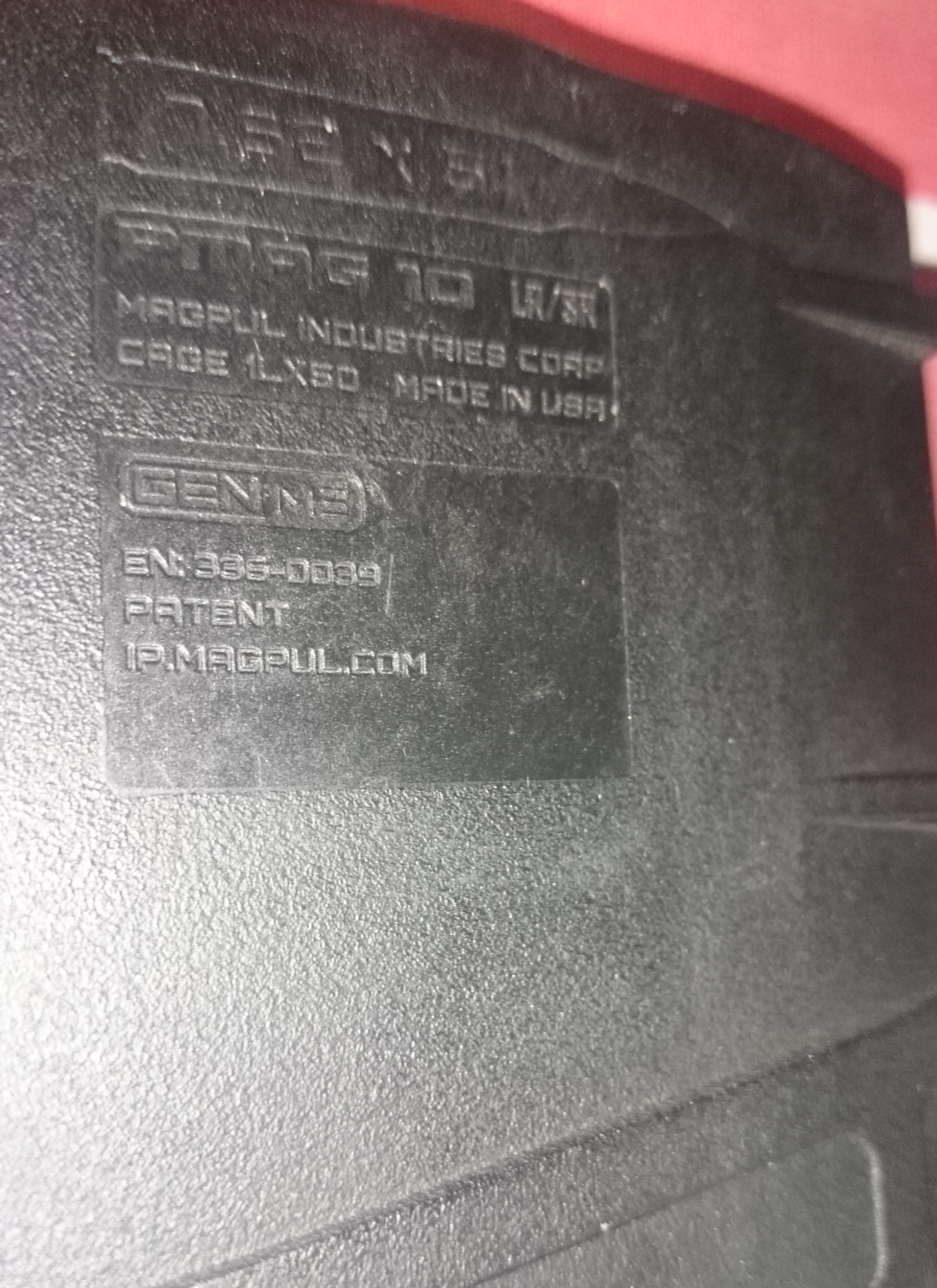

Hmm I wonder what I got supplied with as I did notice similar. Ie it's easier to close the bolt when no mag... compared to when I have mag with a couple of bullets.
Any chance you can share a size picture of your mag... or know how to tell what I have

Post by Rod_outbak » 23 May 2018, 6:09 pm
Ziad,
My Local Gun Shop tells me the genuine Ruger mags have a big Ruger logo on the side of them.
The MagPul mags have their name in 'too-small-for-my-tired-eyes' on one side; about 2 inches down from the top of the mag.
I cant really give you a size comparison photo with a genuine Ruger mag; it seems I dont have any!

Post by Sergeant Hartman » 24 May 2018, 11:16 am
Thanks mate mine is exactly like that. So either ruger or noia here are swapping the mags. Can you please keep us in the loop as top what your lgs do regarding the mag.
I noticed mine being hard to cycle the bolt as well. The mags are always empty. Only sent about 80 rounds through the gun though
