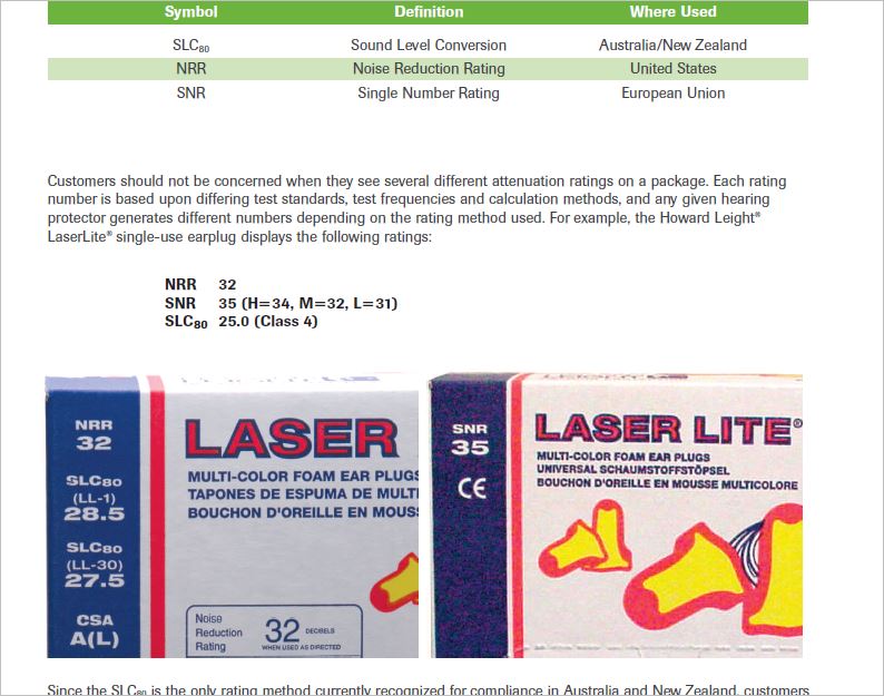

The 3 ratings are all different. See below
Ratings explained.JPG (88.66 KiB) Viewed 7239 times
If you had 3 sets of muffs and all were rated 33 dB attenuation then you would rate them likes this. 1 = best 3 = worst
1. SCL 80
2. NRR
3. SNR

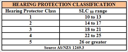

HPD Classes.JPG (28.49 KiB) Viewed 7239 times
So the muffs fpr $110 are SNR 33 dB are equal to about 26 dB they are a low end Class 5. Still good value but for serious target shooters probably not good enough. By wearing a pair of ear plugs under the muffs you will increase the protection by about 5 to 7 dB if worn correctly which few people do. Also generally speaking, due to the nature/physics of sound the higher the class/attenuation the bulkier they are. Hope this helps,
