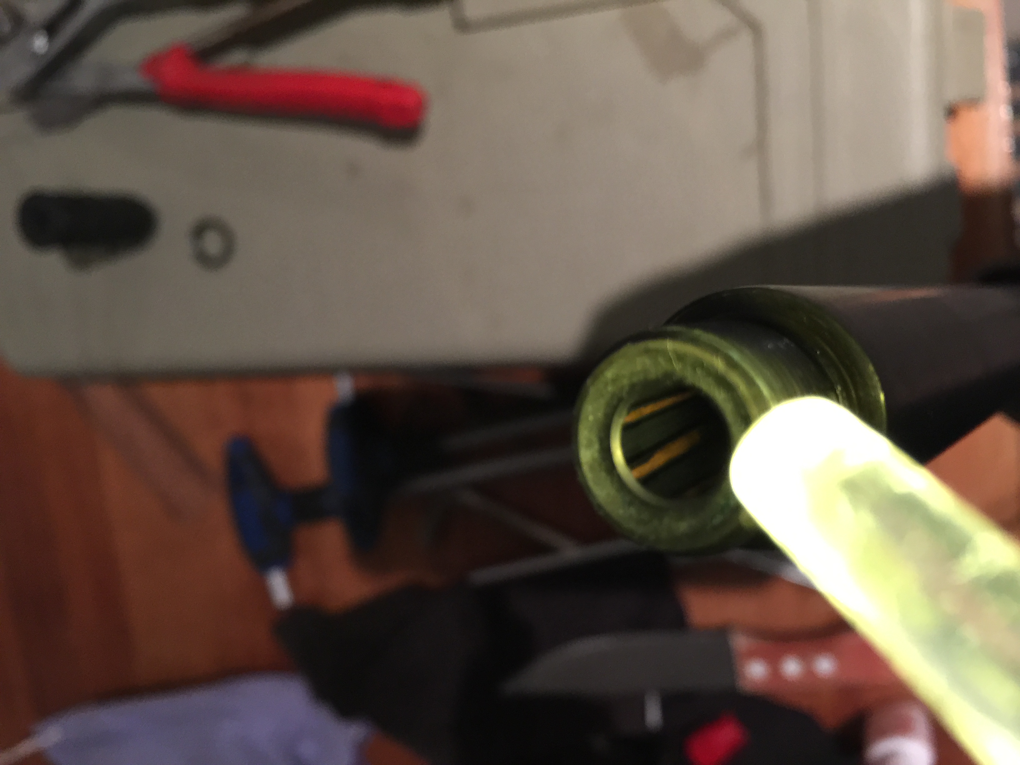

Here’s a barrel I’m just starting on...

Post by TassieTiger » 21 Mar 2020, 10:53 am
Okay - this is getting weird....are barrels made of the same steel?
The below picture is after a dozen treatments of KG12...it will not seemingly move THIS copper...yet it had it running out of the sauer. I’m really confused now. I’ve tried carbon cleaner in between the kg copper cleaning - to no avail.
I’m going to soak this in sweets for an hour or so and see what happens...in fact I just wet a patch in sweets, ran it through and it came out like the Scottish flag lol.
So weird - maybe this is why, there are so many stories RE different copper cleaners, as it’s an individual thing per barrel, or per layering process...
