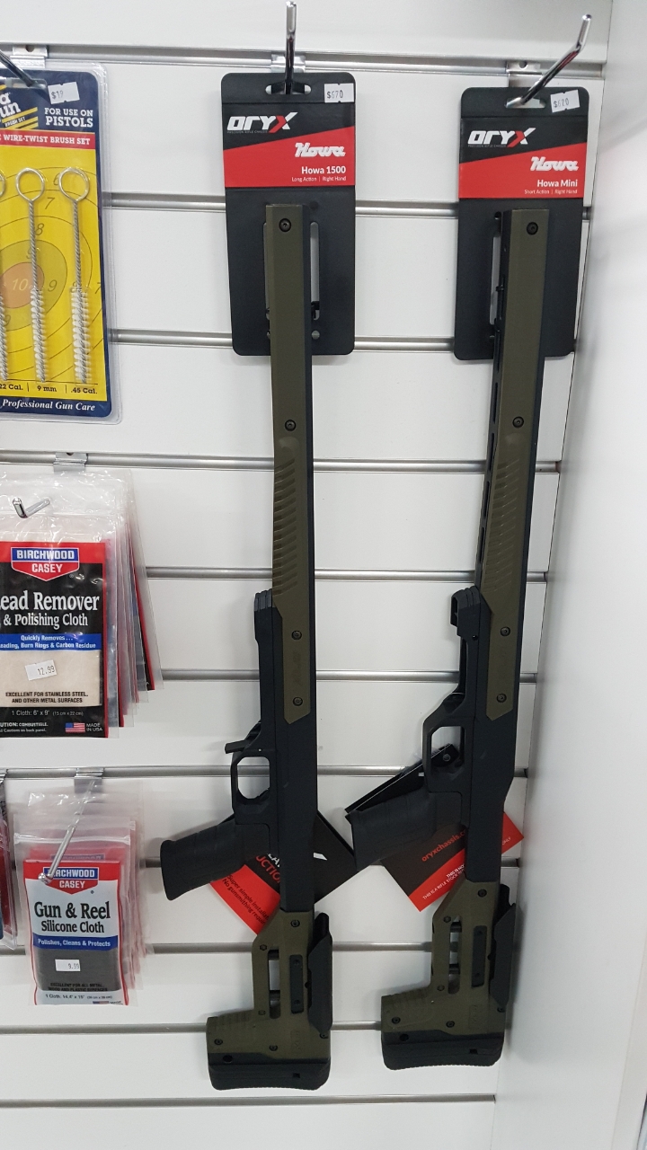

Post by deye243 » 06 Aug 2020, 6:58 pm
Gday all hope all is well ......
So I go in to my local to get a couple of packets of subs and walked out with one of these for my sons howa 223 ......
Cheers D
