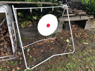

Post by Bello » 21 Dec 2020, 9:47 am
This is one of my newer gongs
5 mm mild steel. Painted with oil based undercoat (White) and red primer for the 100mm centre.
The frame a thin tube. Light to carry and put in place.
Hopefully we don't go into lockdown again over Christmas and this one will get a workout up to 500meters all going well.
I will weld some chain to the back of the target and then tie wire that chain to the frame. Makes it easier to change the damaged targets out in the field.
