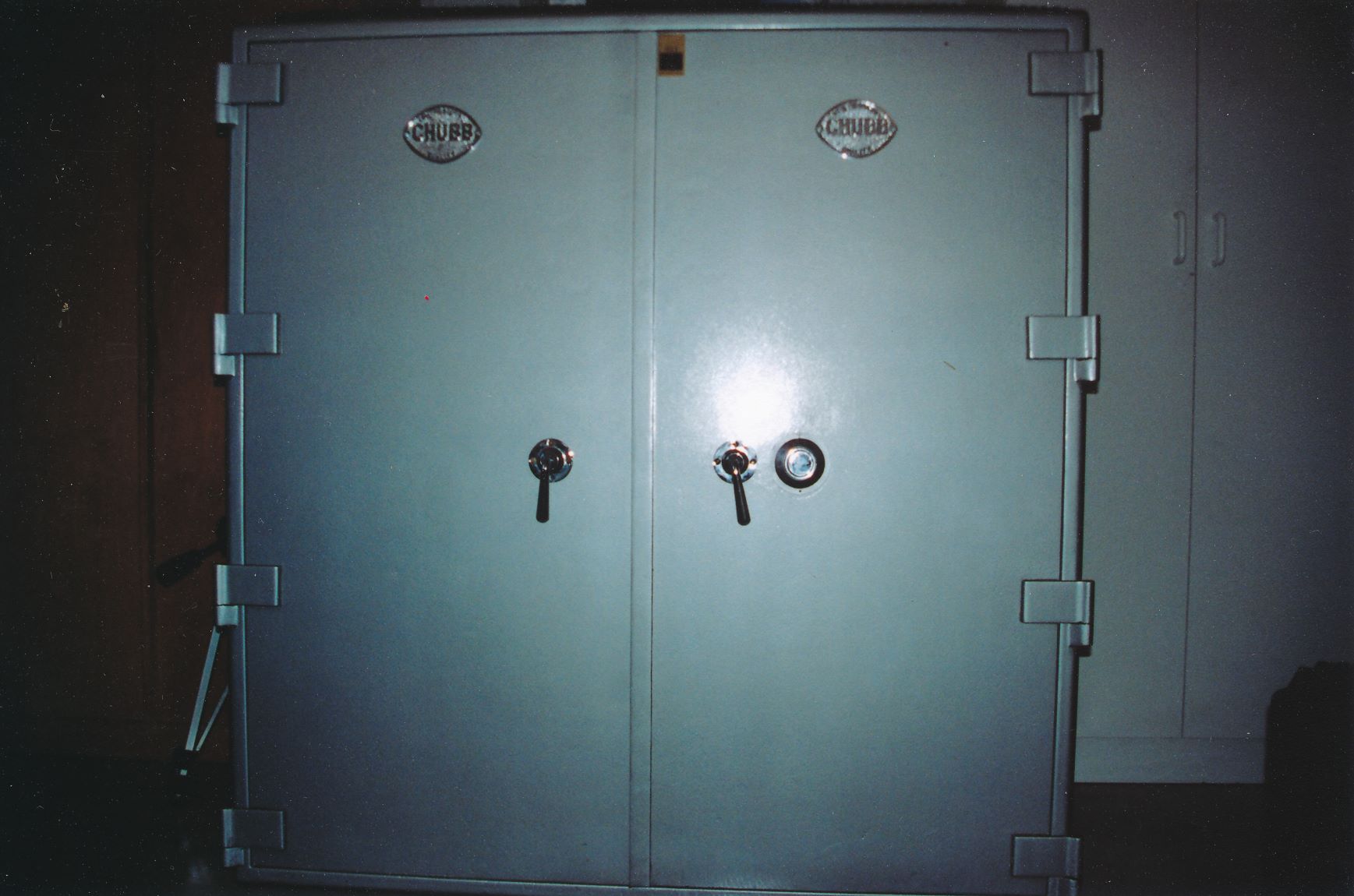

Post by niteowl » 26 Jul 2021, 12:47 pm
safe_0001 resize.jpg (185.81 KiB) Viewed 10038 times
Can actually fit 25 and some with BIG thermals. Weight empty 1.3 T
