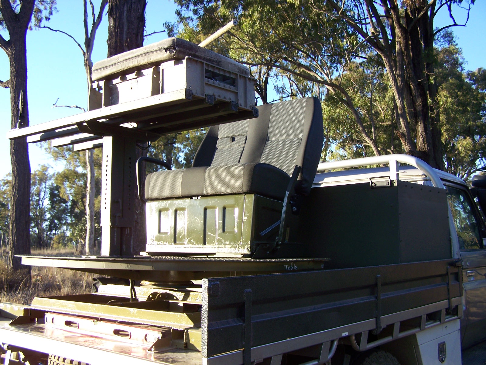

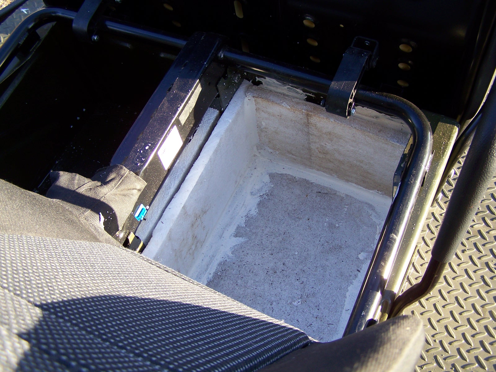

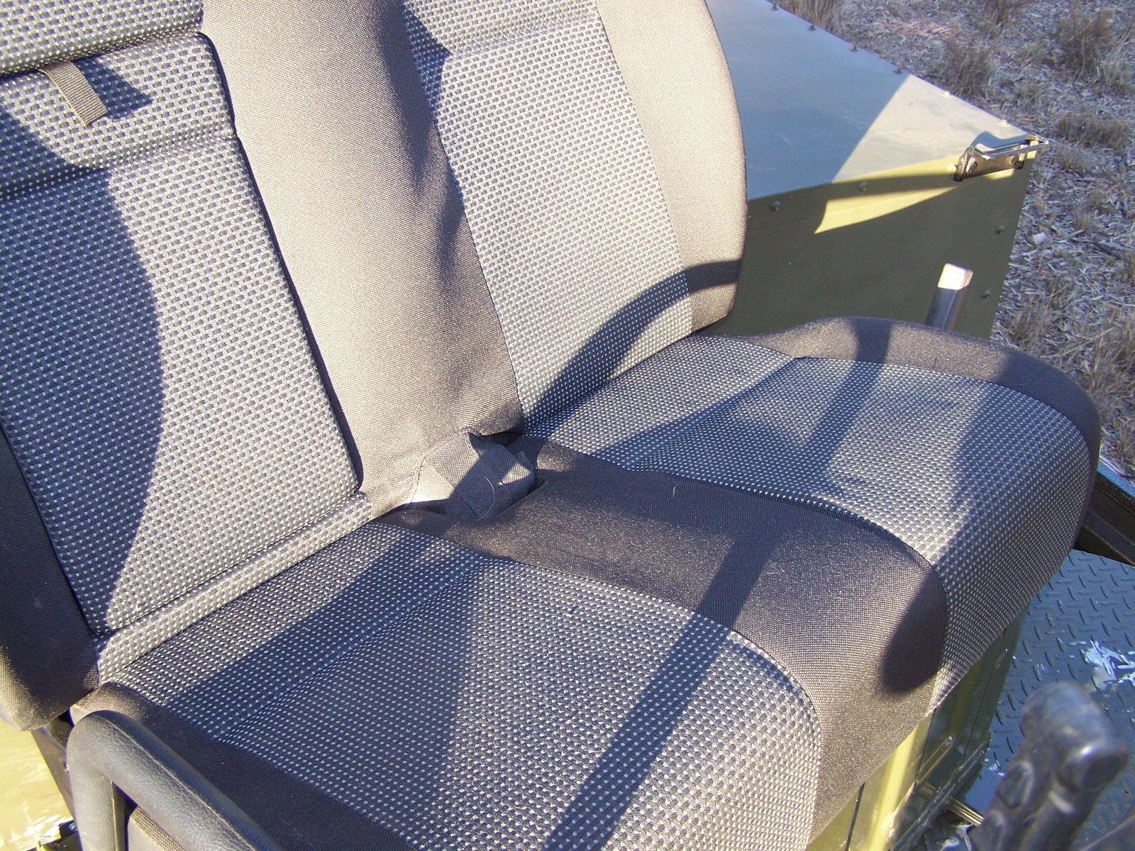

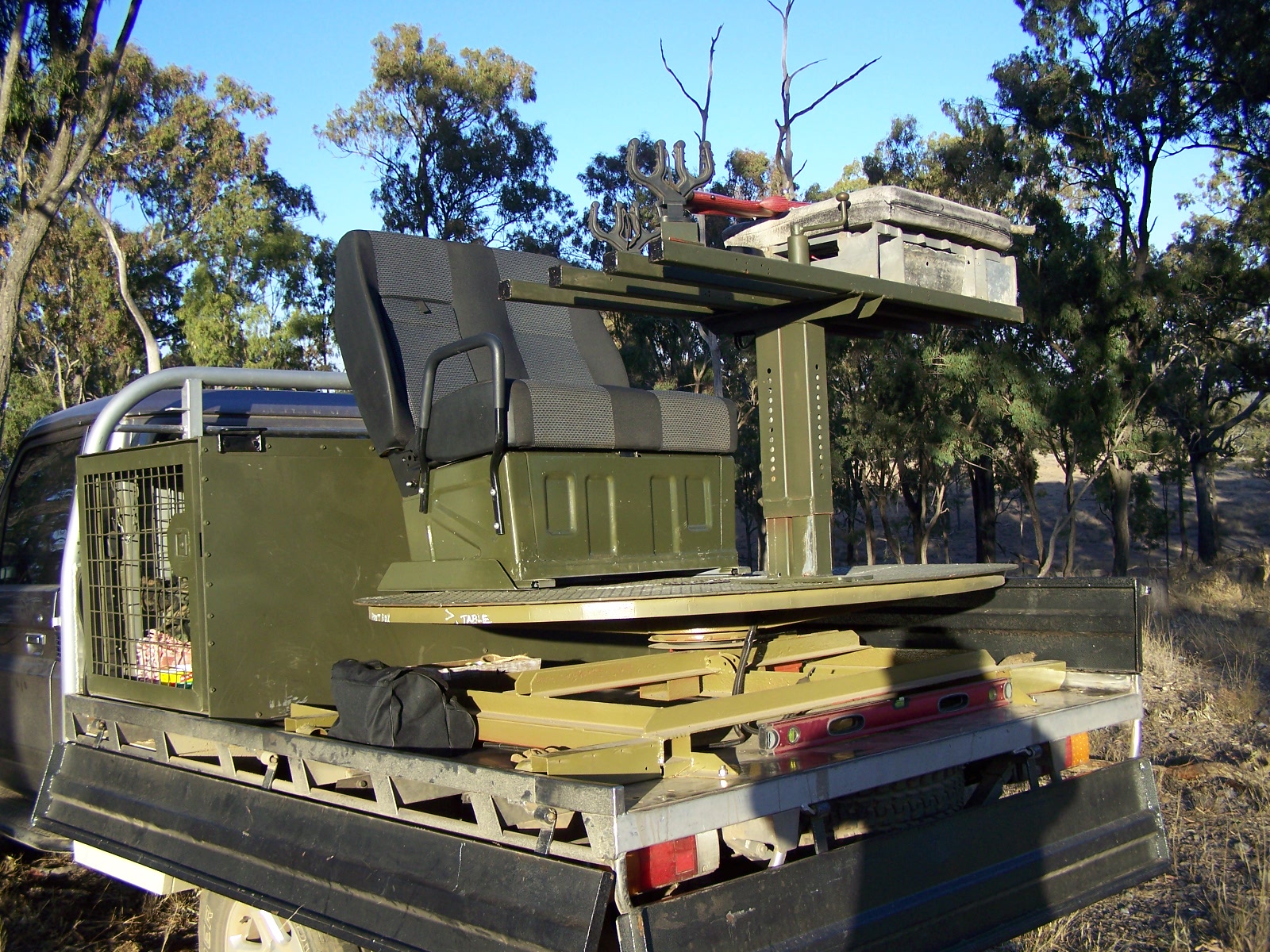

Well it is now up and running again.
I removed the two black buckets (they were too cramped, and they used to squeak on clothing)
I replaced them with an as new bench seat (ISRI Brand) out of a Mercedes van.
Had to cut 4" off the base box so the seats won't hit the gutter on the carport.

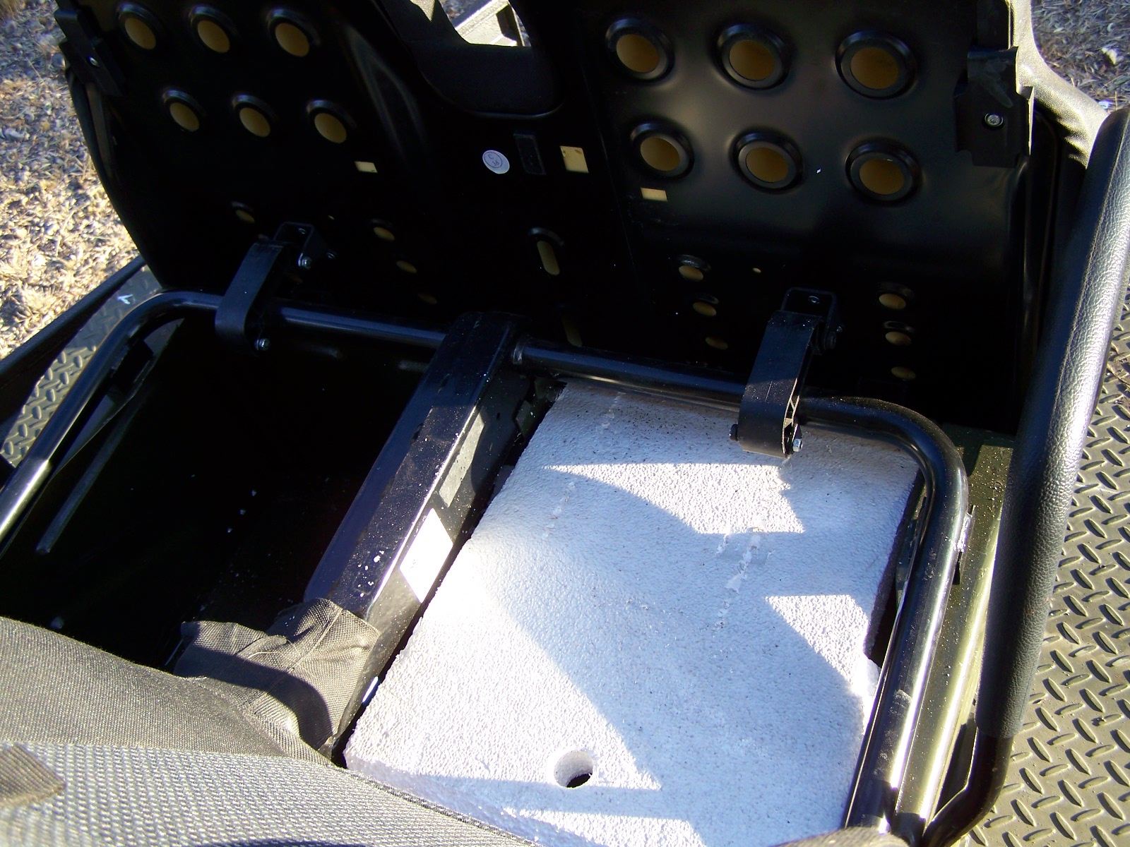

Then Mig'd it all back together and included a fully seal floor plate, and lined one side of the storage compartments with extra thick styrene foam to be used as a large storage esky.
Because the seat was originally fixed in position, I bought heavy duty roller slides and built them into it as well.
Adjustment of position is now easily done with one single lever, and is in 1" increments.

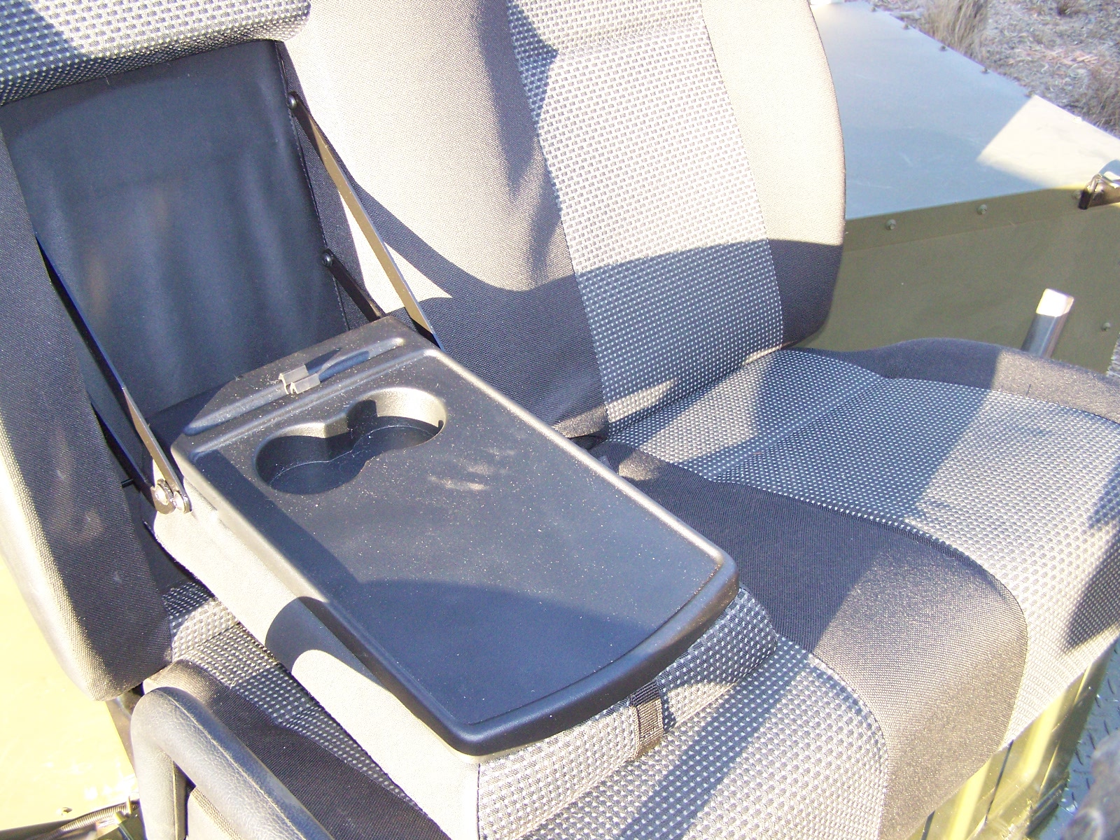

For those that expected cup holders in the original version,,,,, voila
Check these babies out.
Tried it out last night in the bush for 10 hours, and I'm pleased to say that it works very well, is comfortable, and quiet.

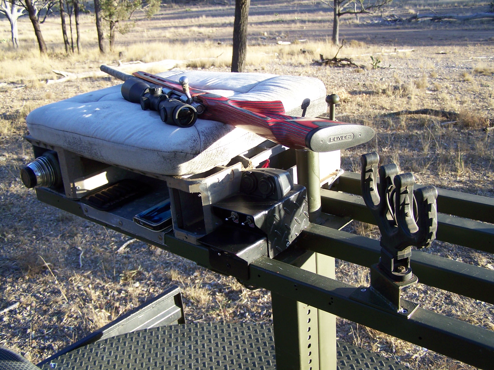

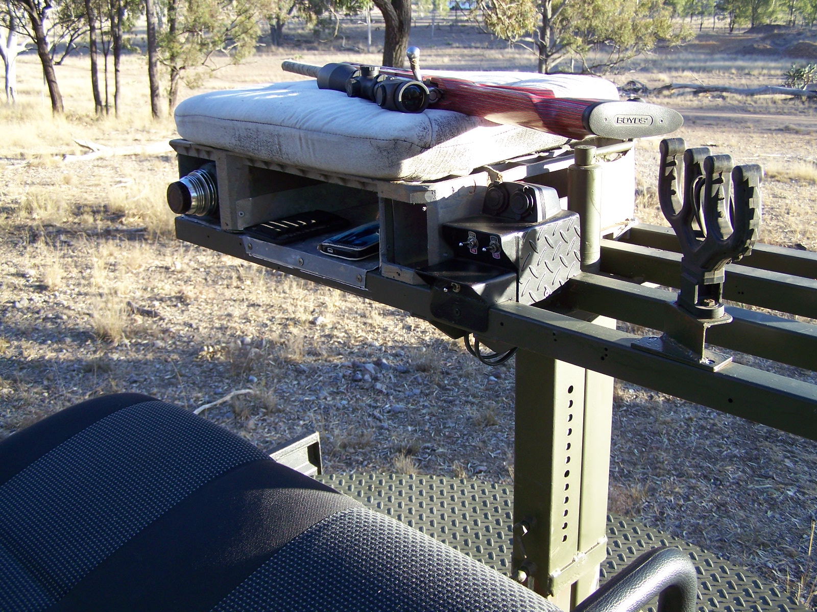

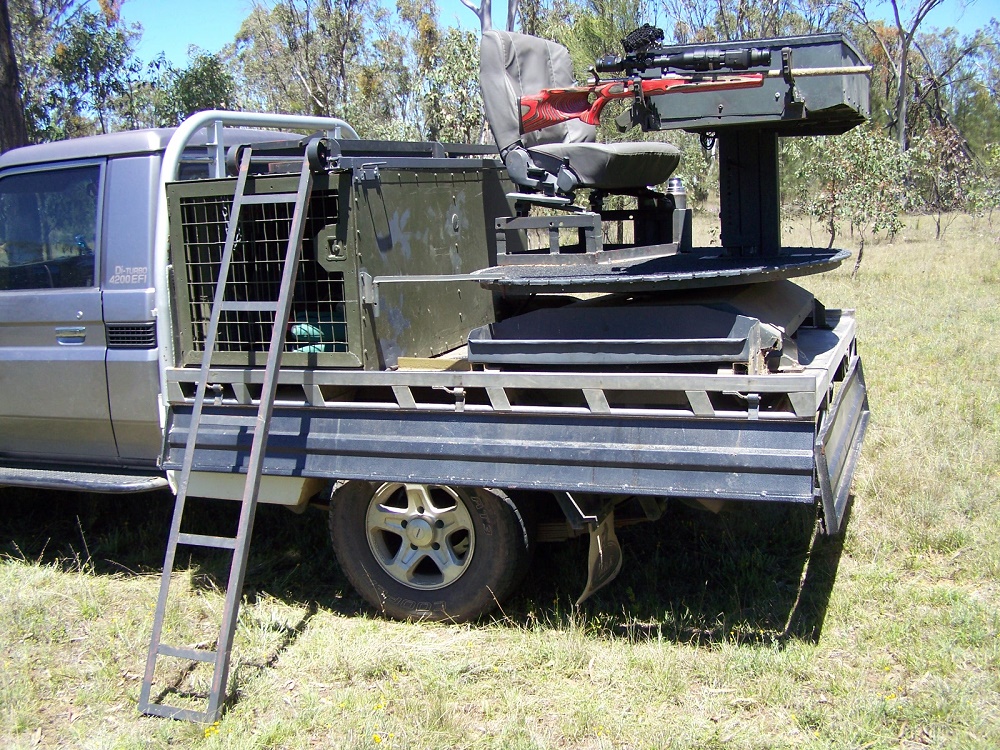

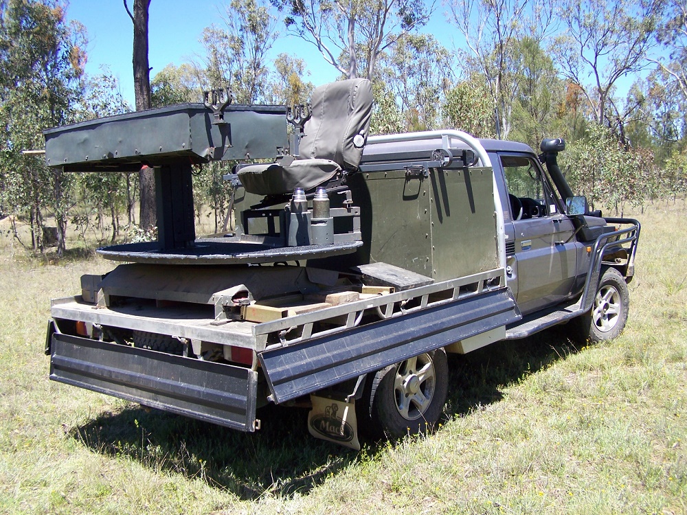

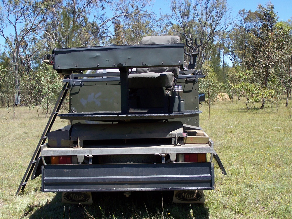

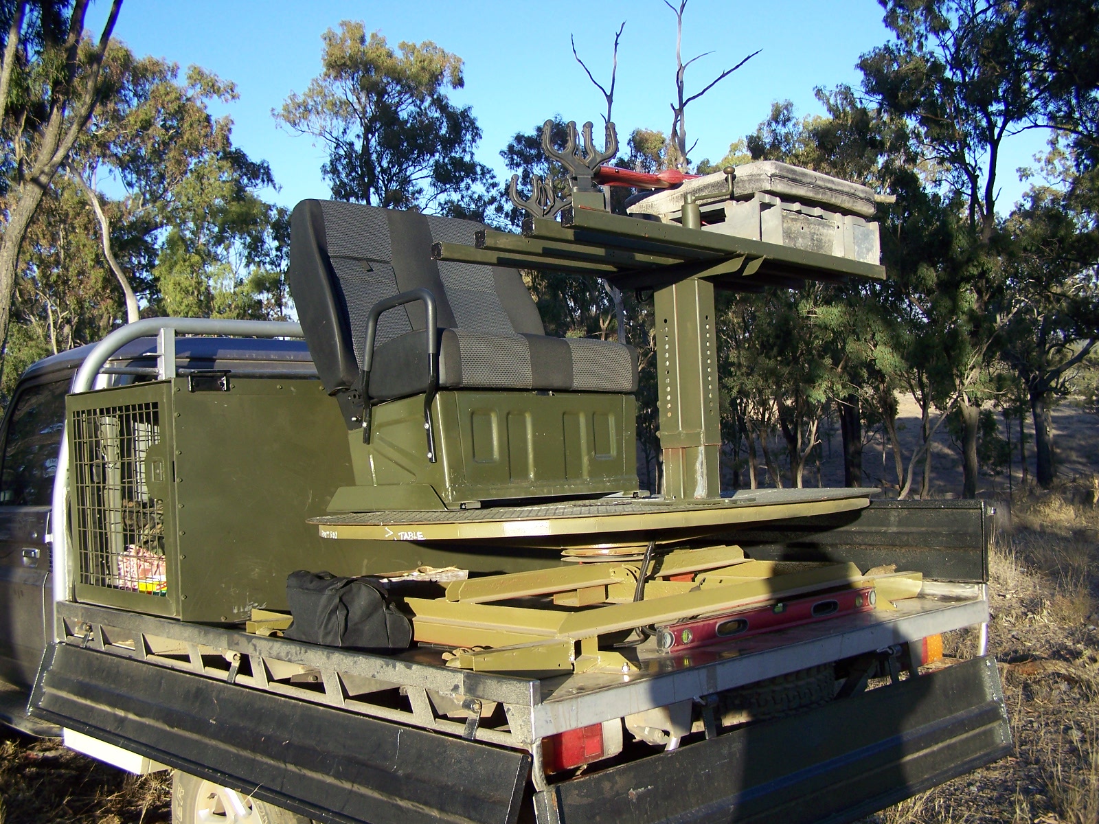

OK,,,, here are the up to date pics just taken.
The bench top is aluminium sheet with black pool carpet glued on.
The deck of the turntable is also covered with black pool carpet.
Note the custom made thermos holders.
Access ladder deployed. The little strut btween the turntable deck and dog box is lifted out when set up for the night.
Rear view also showing ladder deployed from its compartment.
Tray for dogs with drain that goes through the tray towards the ground
The business end
Office view

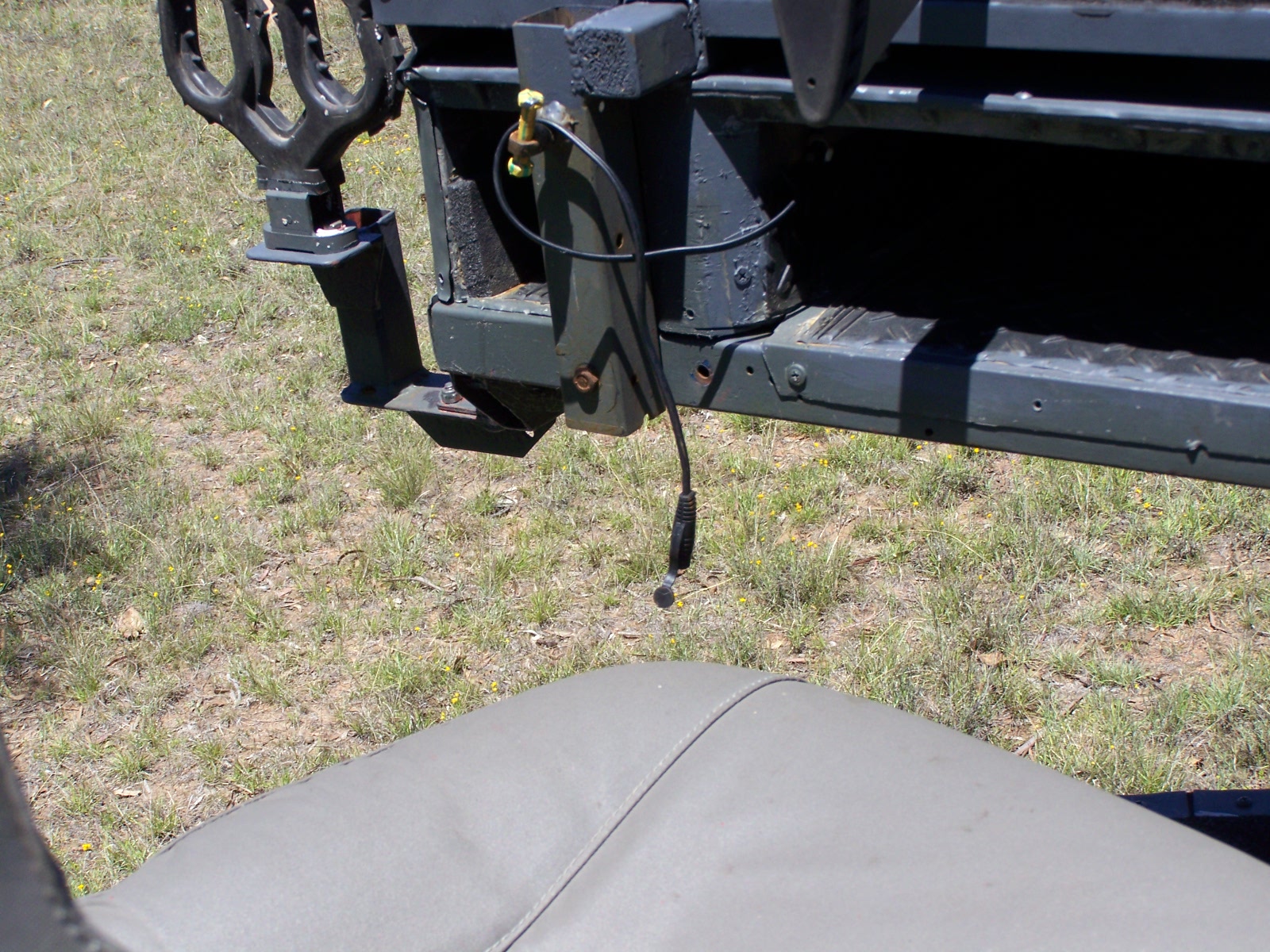

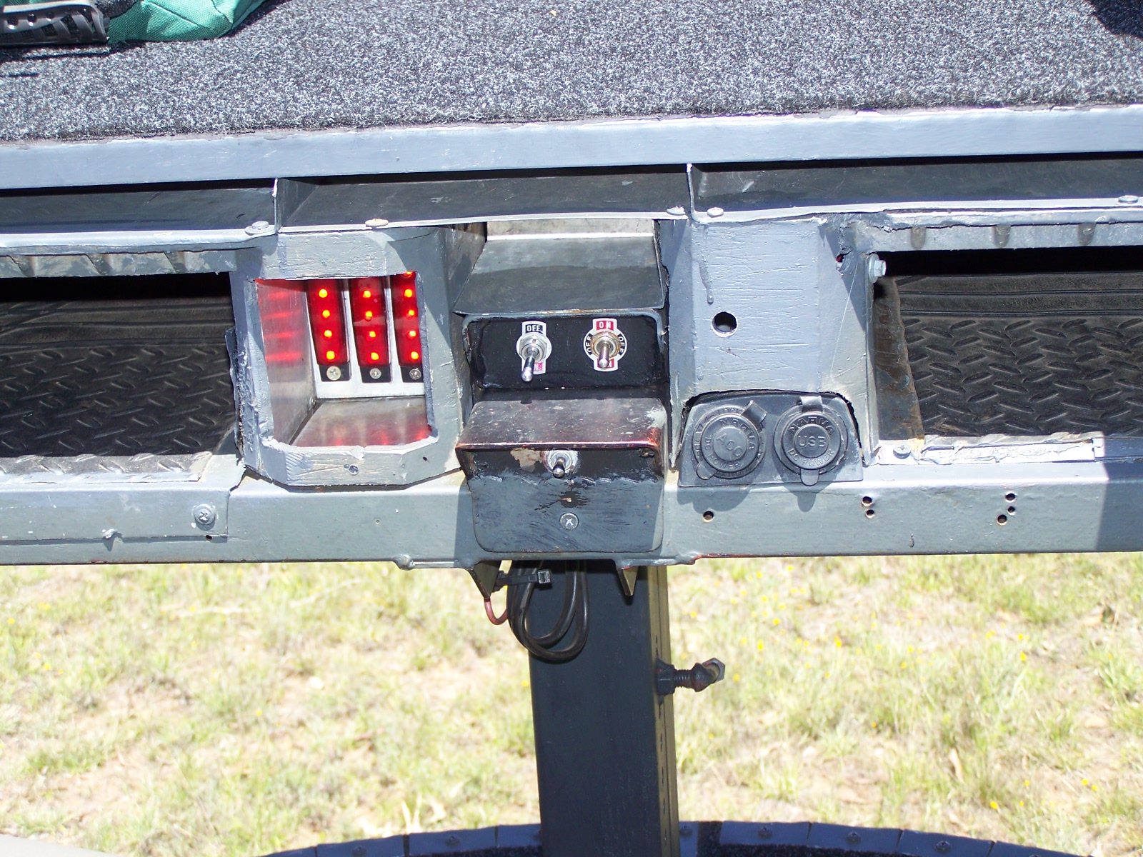

Power supply cable for my heated jacket
Red lights bank and switch, Table up/down switch, Slew left/right switch (bottom) Cigg lighter socket, and Twin USB ports. Note the narrow tray btween the carpeted top and the red lights bank,,, is where I slide the battery packs for the scopes.
